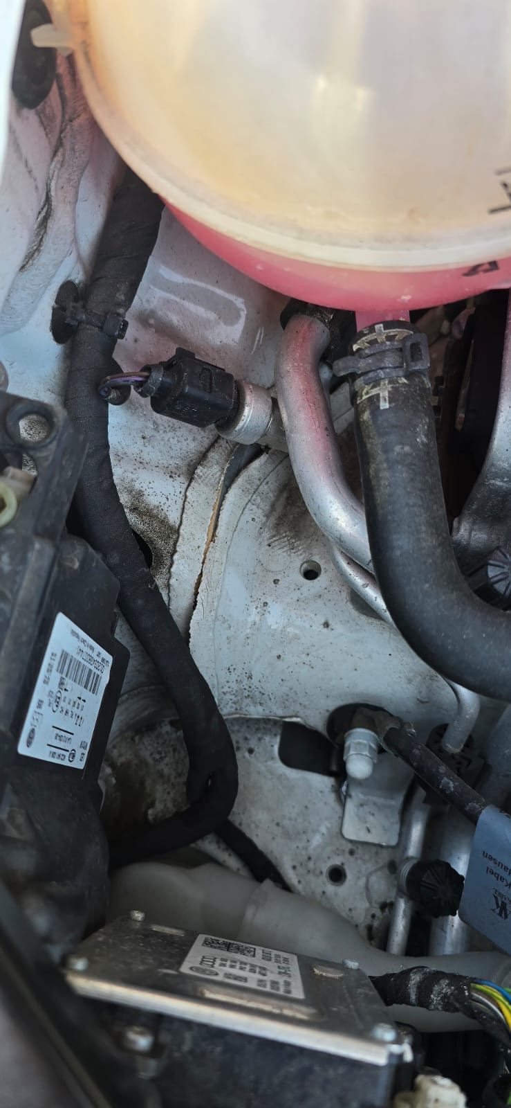

DBiggs04
Joined: Sun Jun 15, 2025 3:18 pm
Drives: 6C GTI 1.8 TSI
Location: Cumbria
Re: Weird knock
Post by DBiggs04 »
I think I’ve encountered a similar issue, due to lack of main dealers near me it’s been a nightmare to solve. Has anyone else experienced this and had success with VW covering the repairs?
My engine is jumping around when the clutch is depressed which indicates a total failure of the welds. Not exactly ideal considering the performance nature of the GTI badge.
