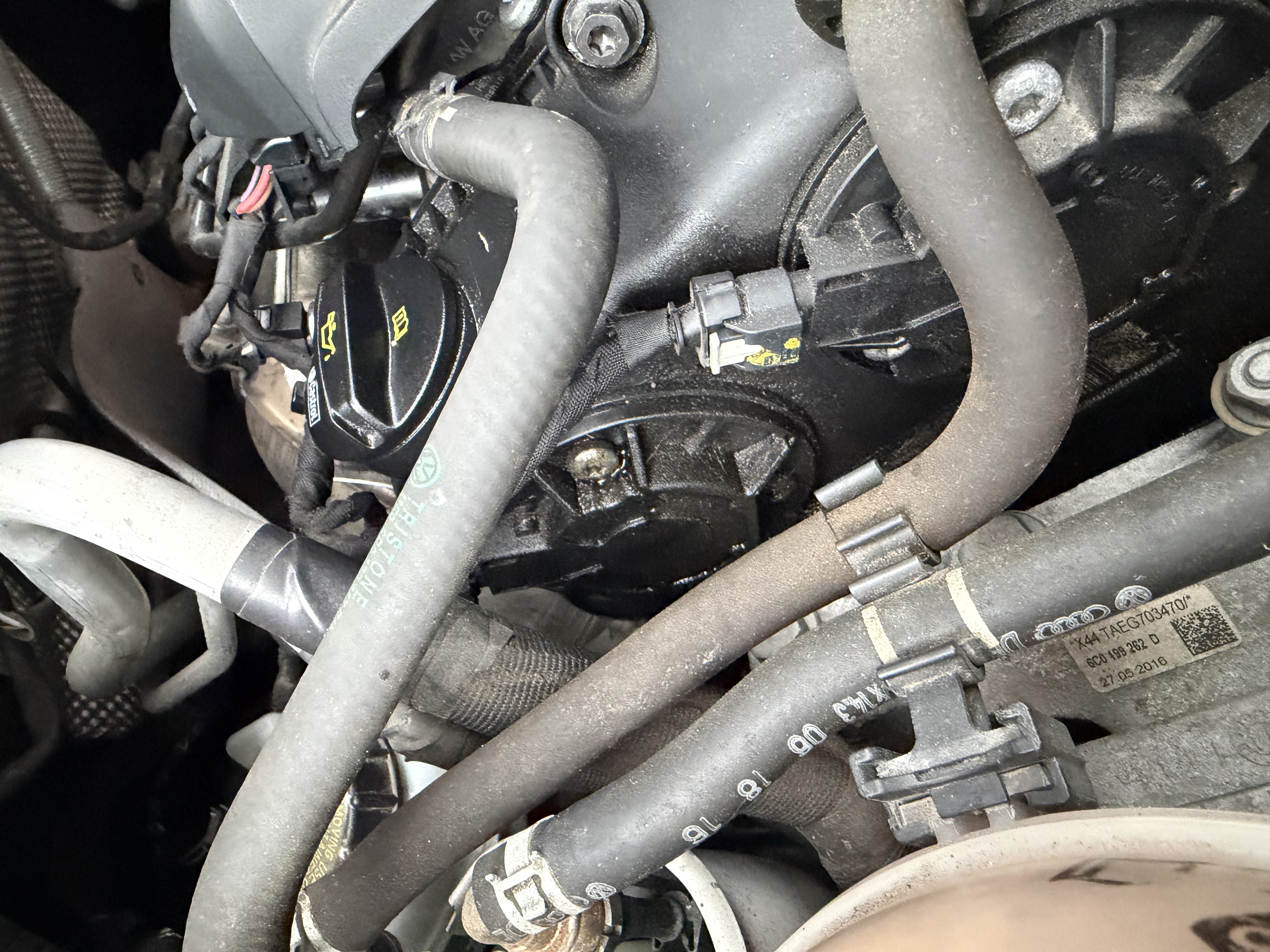

Also, a seperate issue, the side of the engine where the oil filler cap and belt covers are, is covered in misty oil whoch is getting worse. I have ordered a new cap with the seals to see if this helps but I have noticed an area where it is 100% peaking from through the bolt area. Picture added below. I believe these may just need a seal replacement? If so, can anyone tell me part numbers and how many there are, and if it is a diy at home job or will it need to go i to a garage?

Oil leak and misting will be a combination of failing seals on the cam cover and potentially a failing PCV valve where one of the one way valves within is sticking causing boost to pressurise the crankcase (I'm on my third :roll:). Both are not too difficult of a job in themselves but just have other bits in the way which make the job a bit annoying. Exhaust cam magnet having the aircon pipes right there and the PCV having wiring and coil packs in the way which can be removed to ease access. I made a thread a while ago detailing the job: viewtopic.php?p=601573#p601573
Part numbers:
Oil cap: 06K103485D
Outer cam magnet seal: 06K103583
Inner cam magnet o-ring: WHT007212B
Bolt for cam magnet: N10451409 Torque spec of 9nm
PCV: 06K103495BL
PCV-TIP line: 06K103213M
