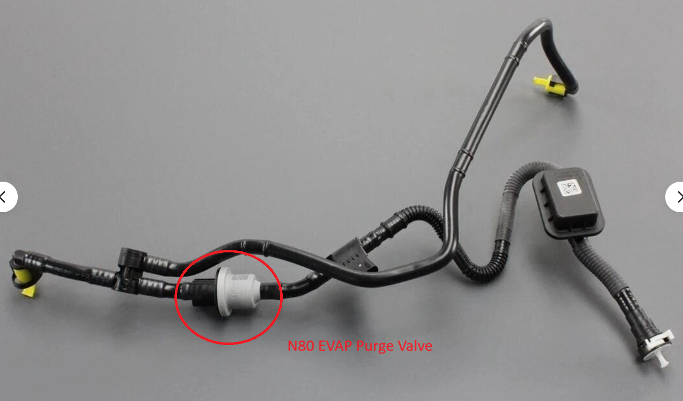

I have the 1.6 MPi (Non turbo version of the EA211 Engine) in my 2019 Polo with manual transmission, it made some abnormal noise during idle when the engine is at its normal operating temperature (90C). To cut the story short, it was the hard plastic pipe of the N80 EVAP Purge Valve have cracks on it and the leaks causing the abnormal noise.
An easy way to check is:
1) Make sure engine is at normal operating temperature (90C).
2) Let it idle and wait for the abnormal noise to happen.
3) While the engine is running at idle and making that abnormal noise, unplug the electrical connector on the N80 EVAP Purge Valve. If the abnormal noise disappear, then cracks on the hard plastic pipe will be the root cause of the abnormal noise.

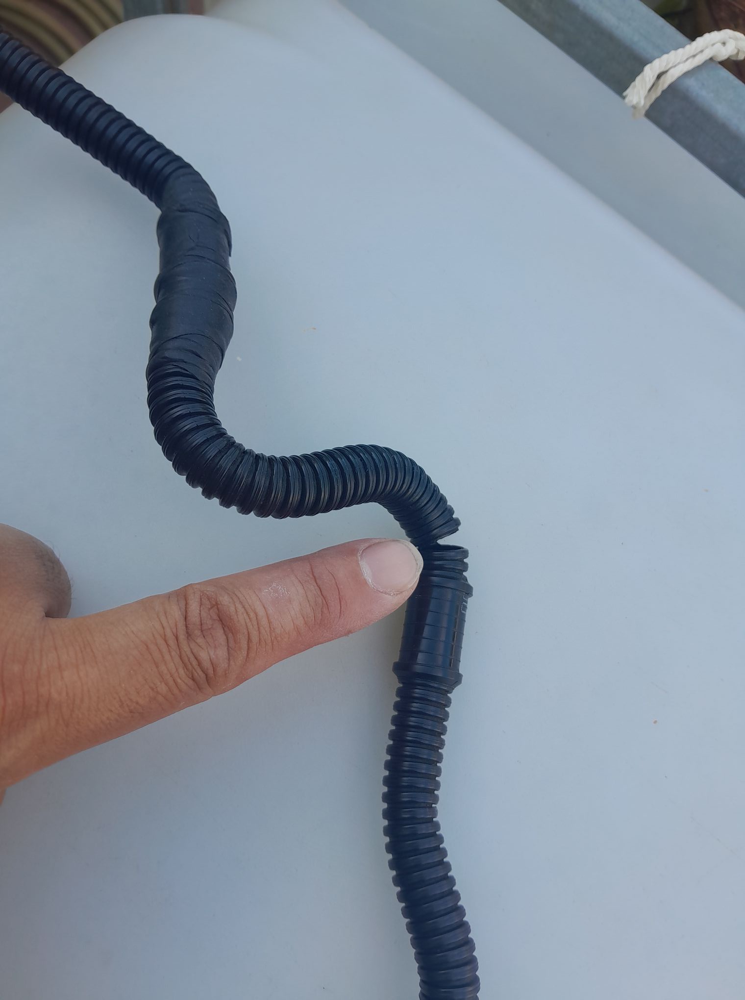

I replaced it with aftermarket rubber fuel hose, it is much cheaper than the original VW hard plastic pipe which will crack again after a few years.
This is the cracked hard plastic pipe of the N80 EVAP Purge Valve removed from my Polo:

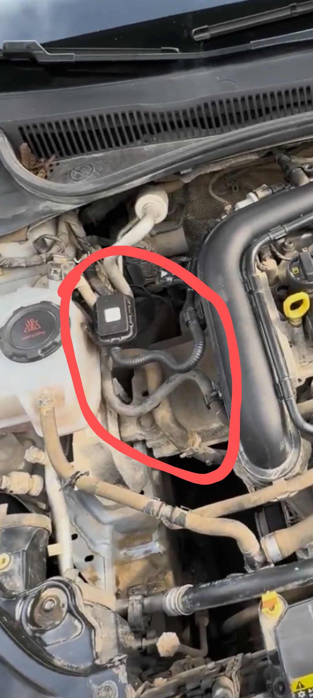

Hi, Thank you for your reply!!
I've had time to check this out, and its not the purge valve. I can feel it ticking, but it's on a different frequency than the sound, it ticks slower.
Also, the plastic pipe is wrapped in heat foil for me ( the one behind the engine ), so it's not broken.
The car still drives like that, i can't say i feel a noticeable change in the noise it makes. It sounds the same as it did my original video, but the noise did seems to resonate in the intake plenum, the big box that also has the charge cooler in it.
