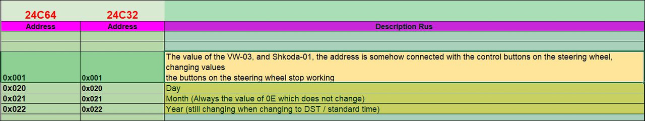

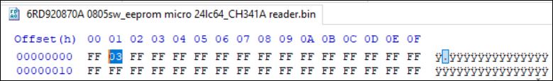

Yes, that's the behavior from stalk with a 'TRIP' button.
I suppose someone will have to take a look at the EEPROM...
My ICluster 💎:
With the MM-007, it can be checked and modified in a snap/sec.
Thanks for 'that' Autoscan... :lol:

Great, thanks for the answer, ciclo! I'll look into it once my EEPROM programmer arrives or if I find someone who has the right gear. Is there any other way to read the EEPROM data besides doing a bench setup for the instrument cluster? Best regards!
Posts: 8834
Re: Polo 6r 2010 Building a small rocket.
Yes, as I mentioned, for example, with the Xhorse Iscancar VAG-MM007 you can read the EEPROM of your IC through the OBD2 port. It downloads to the SD card, you modify it, and then you rewrite it in a flash.
The programmer/reader CH341A also works well, but it involves disassembling the IC.

Hi, I have a friend who can check this for me next week, so I’ll see if that value has been changed. Currently, the logo and all commands are set to VW, which I assume has no impact on what you wrote above. Either way, I need to verify if those values in the EEPROM are correct.
