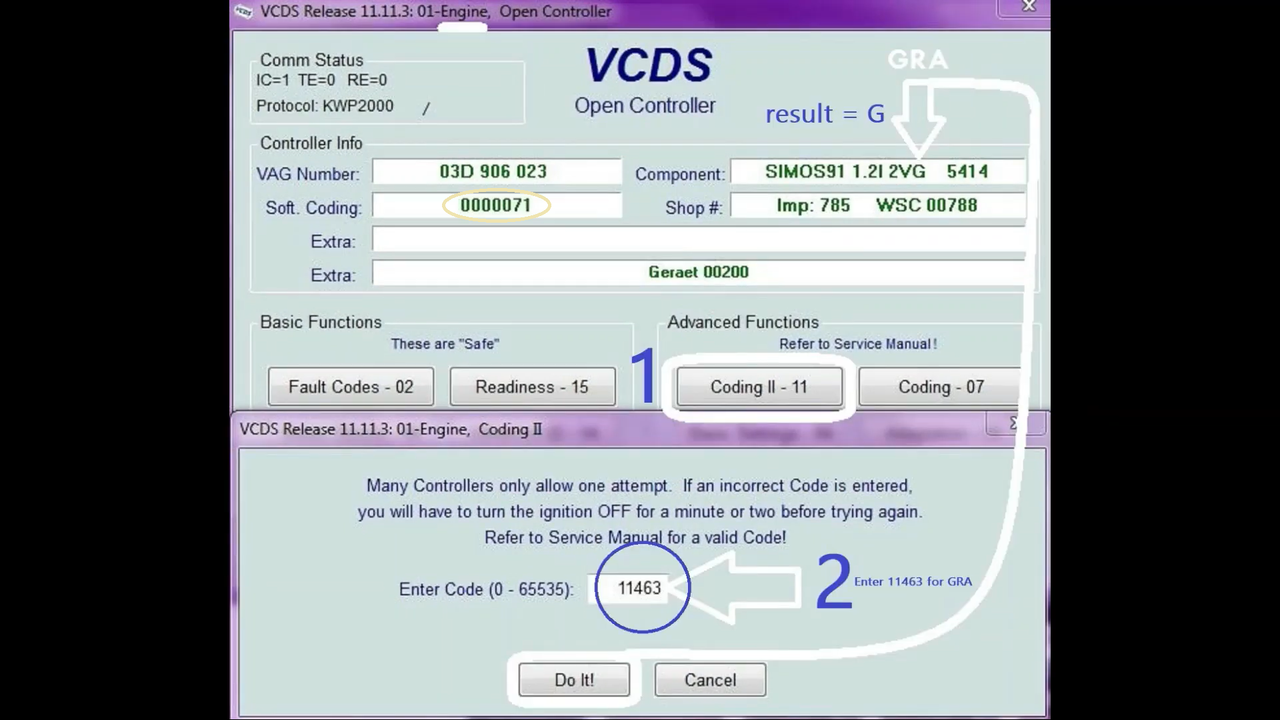

Or perhaps this is the procedure:
Go to / click on "Login - 11" or "Coding II".
Enter the activation code: 11463. 'Do it' to save.
The letter G will then appear in the component's readout.

Posts: 8976
It's a second login/code. Try it!
(clearer image if you're using the stupidphone)
