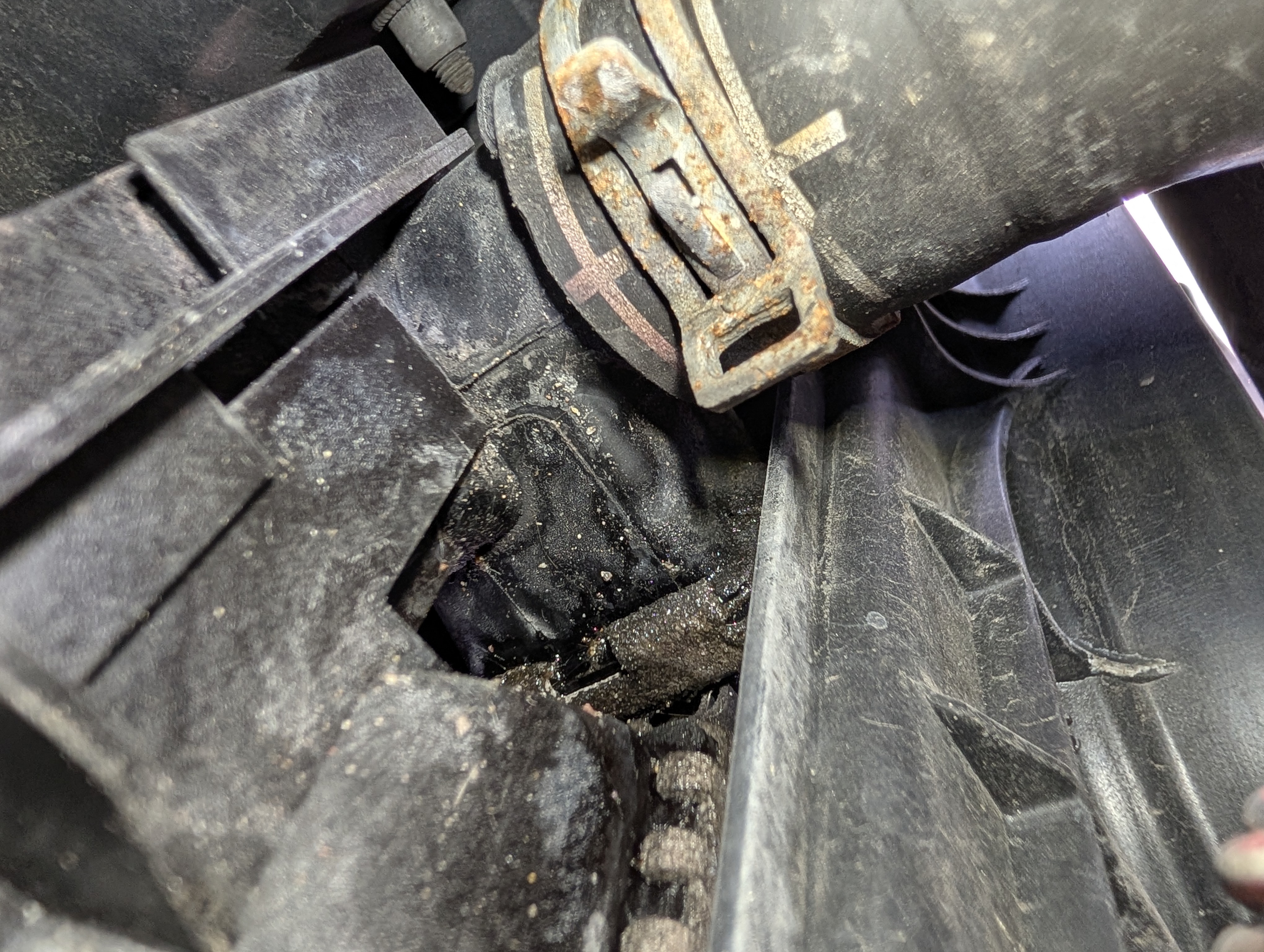

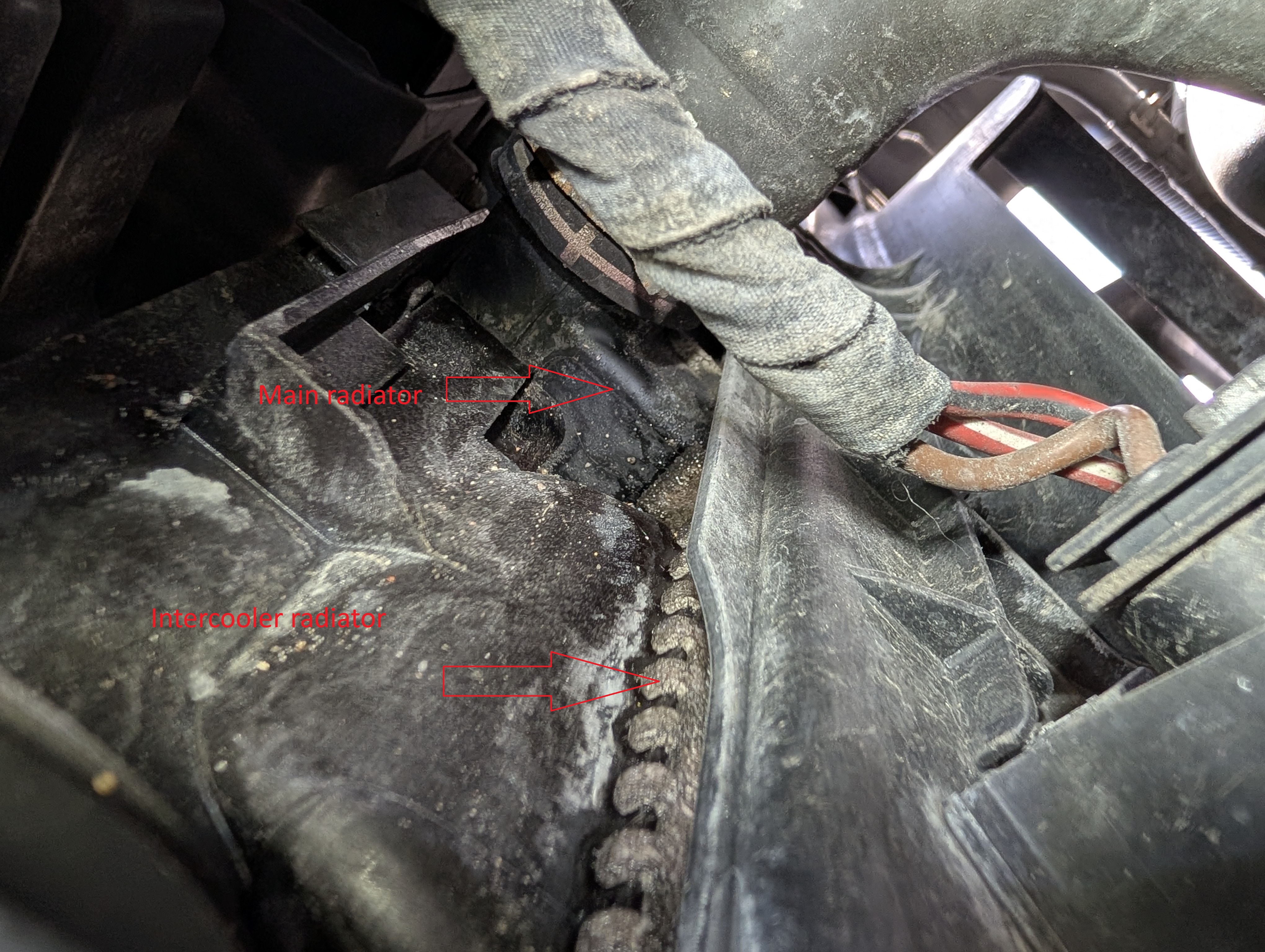

EDIT: after putting the car on ramp and cheking under het (hehe)
I found this:
We are under the car (what a surprise) and this is the pipe of the main radiator
And I found, on the main radiator, the jonction between the plastic housing and the metal disipator quite "wet". Underpressure (over 1.5bar) no leaks but still, last time I did the test, I saw drops.

A small, persistent leak is visible due to residue left after drying. It doesn't seem serious.
Once located, it should be thoroughly cleaned to determine the exact source of the leak.
Hopefully, it might be coming from that large pipe.

ciclo wrote: Mon Apr 20, 2026 7:23 pm A small, persistent leak is visible due to residue left after drying. It doesn't seem serious.
I will not be that confident.
During the last oil change, the gearbox (front side) was wet.
The large pipe is dry, but the metal/plastic frame is wet.

So after few days without any leaks, no a single drops: it's back.
After a short drive (10min) and and the car stop and parker for 10 min, I just saw (as before) a beautiful puddle of G12Evo.
Maybe 15cm by 15cm.
From the front (trough the bumper) the intercooler radiaotor is super dry, so the leak migh come from the location I take in pictures.
