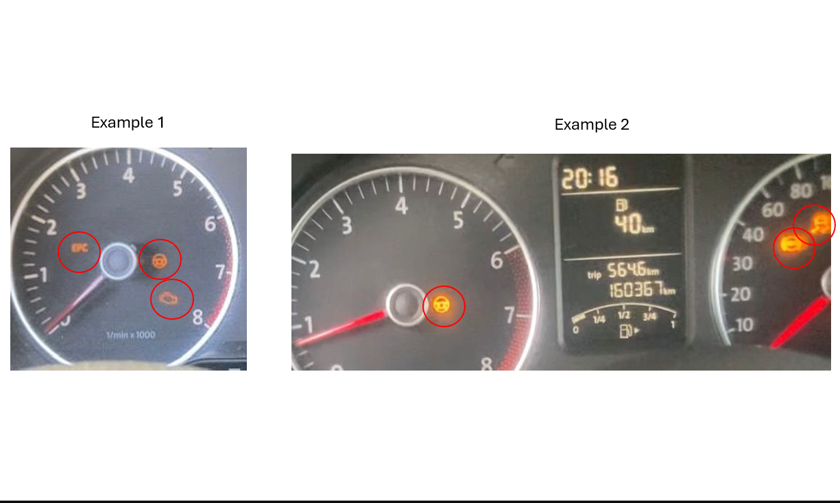

Today I found a pattern:
It happens when I’m disengaging the reverse gear (e.g. parking manoeuvres, changing between first and reverse gear), several yellow warning lights come on at the same time on the dashboard (2 examples attached).
Sometimes the engine stalls; other times, the yellow lights turn on and then disappear straight away (when the engine does not stall, sometimes the radio turns off).

- Posts: 8992
Re: Yellow warning lights and the engine stall
As RUM4MO already mentioned, the various warning lights on the instrument panel are due to insufficient voltage (electrical supply) precisely when the power steering is drawing a lot of power.
Using a multimeter, check the battery voltage and the condition of the battery connections/terminals. I also recommend verifying that the alternator is supplying the necessary charge correctly.
You can do these checks at the battery terminals, first with the engine off and then with the engine running. Disconnect all electrical consumers before doing these checks (lights, radio, A/C, etc.).
If you think it is convenient, tell us the voltage in both circumstances.
Thankd for the tips!
I tested the battery, both with the car switched off and with the engine running whilst turning the wheels, and it’s in good condition.
However, yesterday I carried out a few more tests and have now identified the pattern: it happens when I disengage reverse gear.
(car stop, without turning the steering wheel)
Sometimes the engine stalls, sometimes it doesn’t. Note: this doesn’t happen all the time, just occasionally.
Any ideas? It seems to be related to a sensor in the gearbox which sometimes sends a signal to the ECU and throws the control system out of balance (which is why several yellow warning lights come on).
- Posts: 8992
Any recent modifications or repairs (maintenance)?
- Have you changed or modified the taillights in any way?
- Have you installed a reversing camera or an auto-dimming rearview mirror?
- Have you performed any recent maintenance (within the last year) in areas adjacent to the transmission with leaks or fluid dripping?
Based on the comments, it seems that occasionally the reverse gear wire shorts out.
