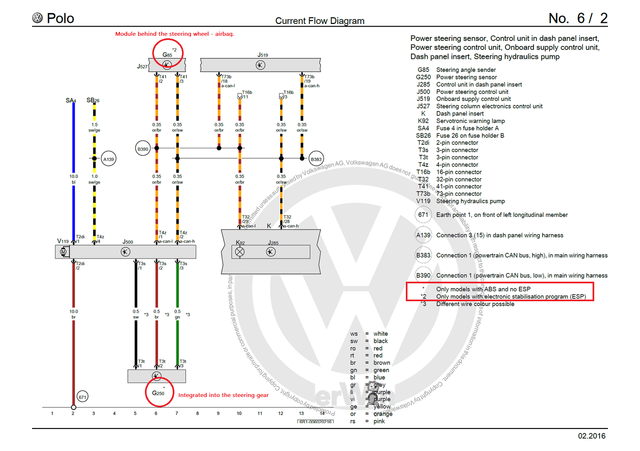

Just a complete guess here, maybe the car does not have a steering position sensor under the steering wheel and the replacement pump came from a car that did have have and use that sensor - instead of the sensor on the steering rack.
I'm lucky, while running and looking after a 2002 VW Polo 1.4 and a 2009 SEAT Ibiza 1.4 SC from new for 13 years and 10 years respectively, I managed to avoid ending up with electro-hydraulic steering system issues. The 2009 SEAT Ibiza 1.4 SC did have the steering sensor under the steering wheel - but at that point in time, only seemed to use it to switch the front fog light on during steering inputs.

The donor car's pump is compatible, but the electronics (MOSFET) may be good or bad.
A fresh Autoscan is necessary for correct coding (ABS? ESP?, etc...) and to be able to provide output tests if/in case of VCDS/diagnostic tool has included them.
The fact that Specified Pump Speed increases when you turn the steering wheel is a huge clue, your G250 sensor is actually working perfectly and communicating, the J500 steering module knows there is steering demand and is actively requesting the motor to spin.
The issue is that Actual RPM remains 0 and Current is 0.0 A.
The Output Test (if possible), before you touch any coding, we need to bypass the software maps and force the hardware to respond.
Go to Address 44 - Steering Assist.
Go to Output Tests - 03 (with the engine running, or ignition on depending on VCDS prompt).
Trigger the Power Steering Pump Motor Test.
-If the pump spins and consumes Amps during the test, your used pump is 100% fine, and your issue is strictly down to incorrect coding.
-If the pump stays at 0 RPM and 0.0 A during the explicit Output Test, the power transistors in that used replacement pump are dead.
