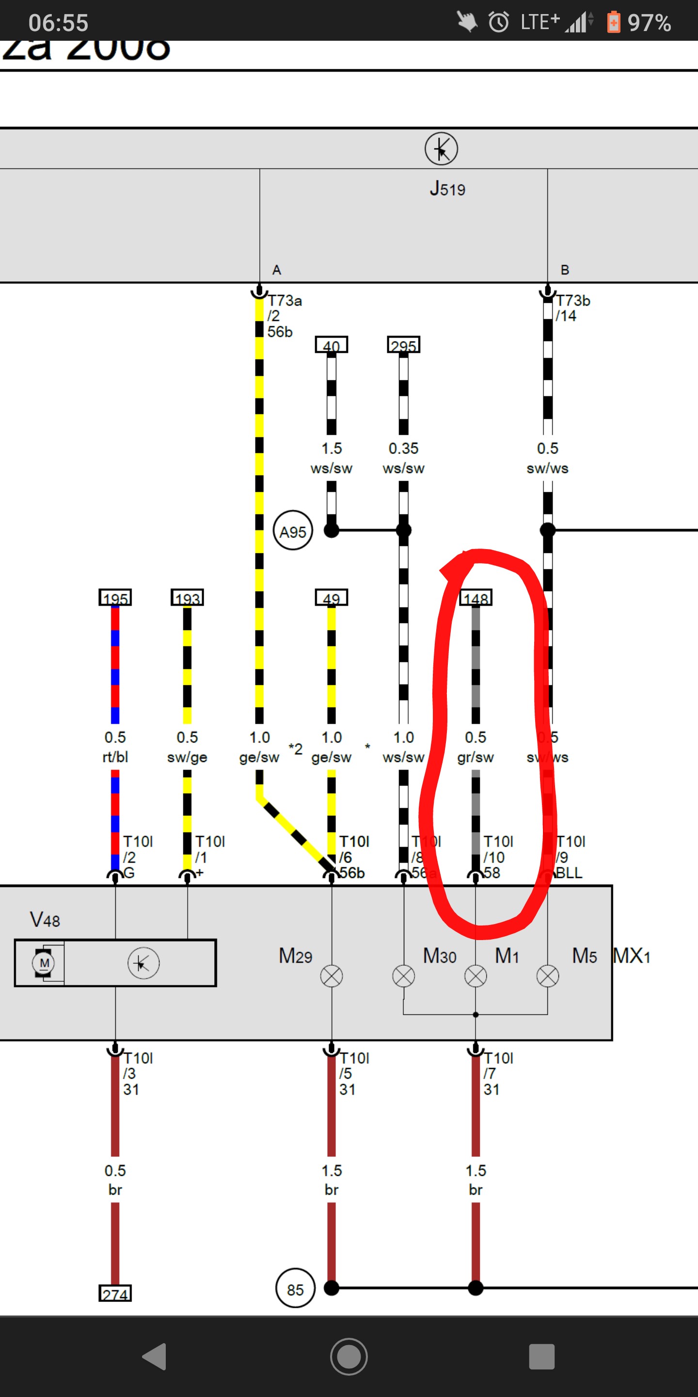

Do not worry, once you take photos from the connectors/wires that I said in one of my previous posts and post a "NEW" autoscan (after doing the photos), I will tell you what you have to do, it will be very easy for you, ...nothing to worry about.
This whole story is because there are 6P headlights on an Ibiza 6J and it is necessary to make this 6P headlights fully compatible with the current conditions of your 6J (Auto Lights).
viewtopic.php?p=587233#p587233 ... Study the blue square in the diagram ... :lol:

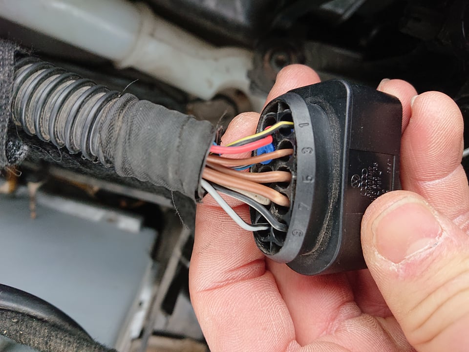

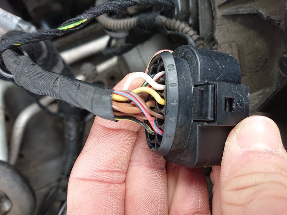

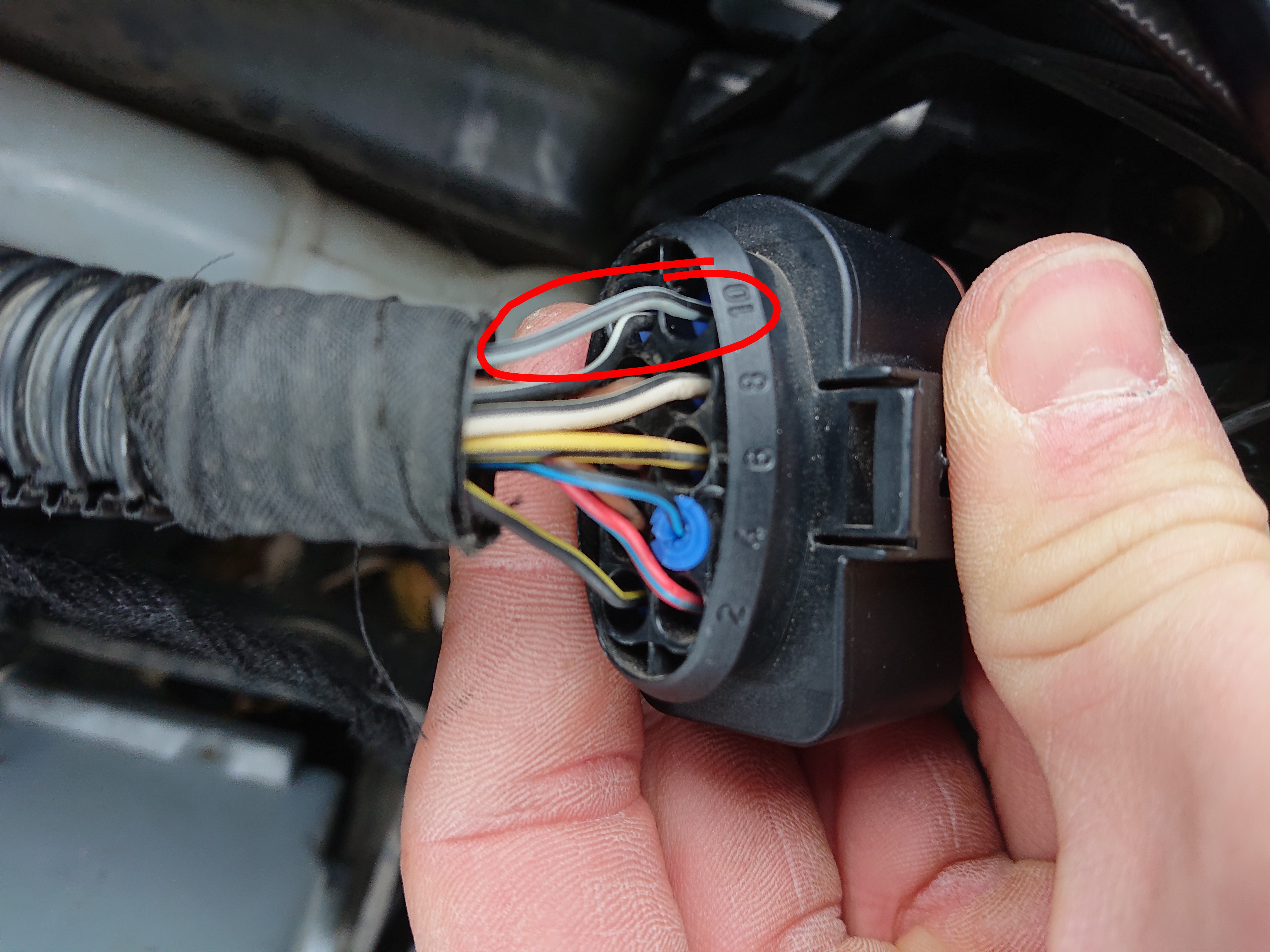

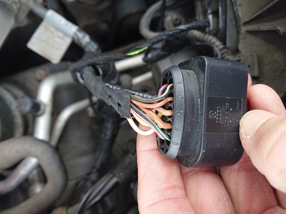

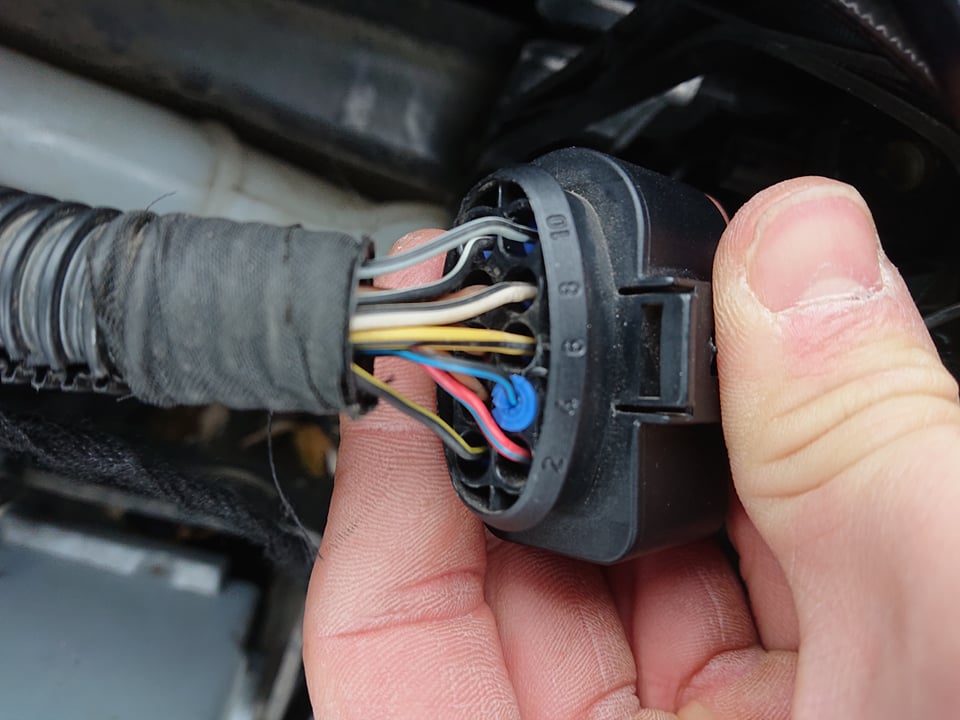

Due to the shortage of time today (wiring installation + gluing the seat heating mats) I was able to take a photo of the headlamp plugs, tomorrow I will make an UPDATE and upload a photo of the BCM plugs (A, B)
On encoding: 7C8829F88861010001200EF06EEB9EC85FC067FF608D30C1200000030000
The AUTO option is illuminated on the light switch, the AUTO is not illuminated, the LED is lit with full power, the parking option is dimmed
2-10 Pin Right Front (Passenger)
2-10 Prawy Przód Pasażer.jpg (99.81 KiB) Viewed 3247 times
1-9 Pin Right Front (Passenger)
1-9 Prawy Przód Pasażer.jpg (88.71 KiB) Viewed 3247 times
2-10 Left Front (Driver)
2-10 Lewy Przód Kierowca.jpg (78.43 KiB) Viewed 3247 times
1-9 Pin Left Front (Driver)
1-9 Lewy Przód Kierowca.jpg (101.9 KiB) Viewed 3247 times
Posts: 8988
It seems that someone did not follow my instructions precisely.😄
I wonder why people think that things work with the logic that they think it is?
When an electronic component is inserted in the electrical operation of components (in this case a NEW BCM) anything is possible without the usual logic of things.
The wires for the side/parking lights can have different locations in their connection "in this NEW BCM" by depending on the equipment installed.
Let's wait for the images of the BCM connectors.

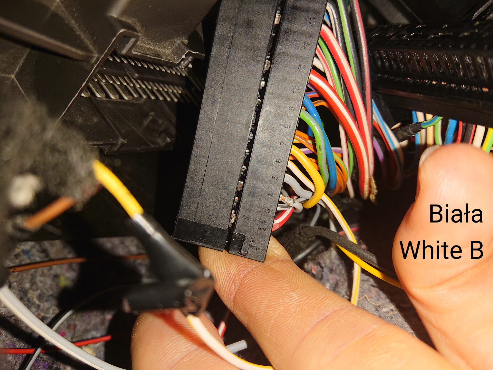

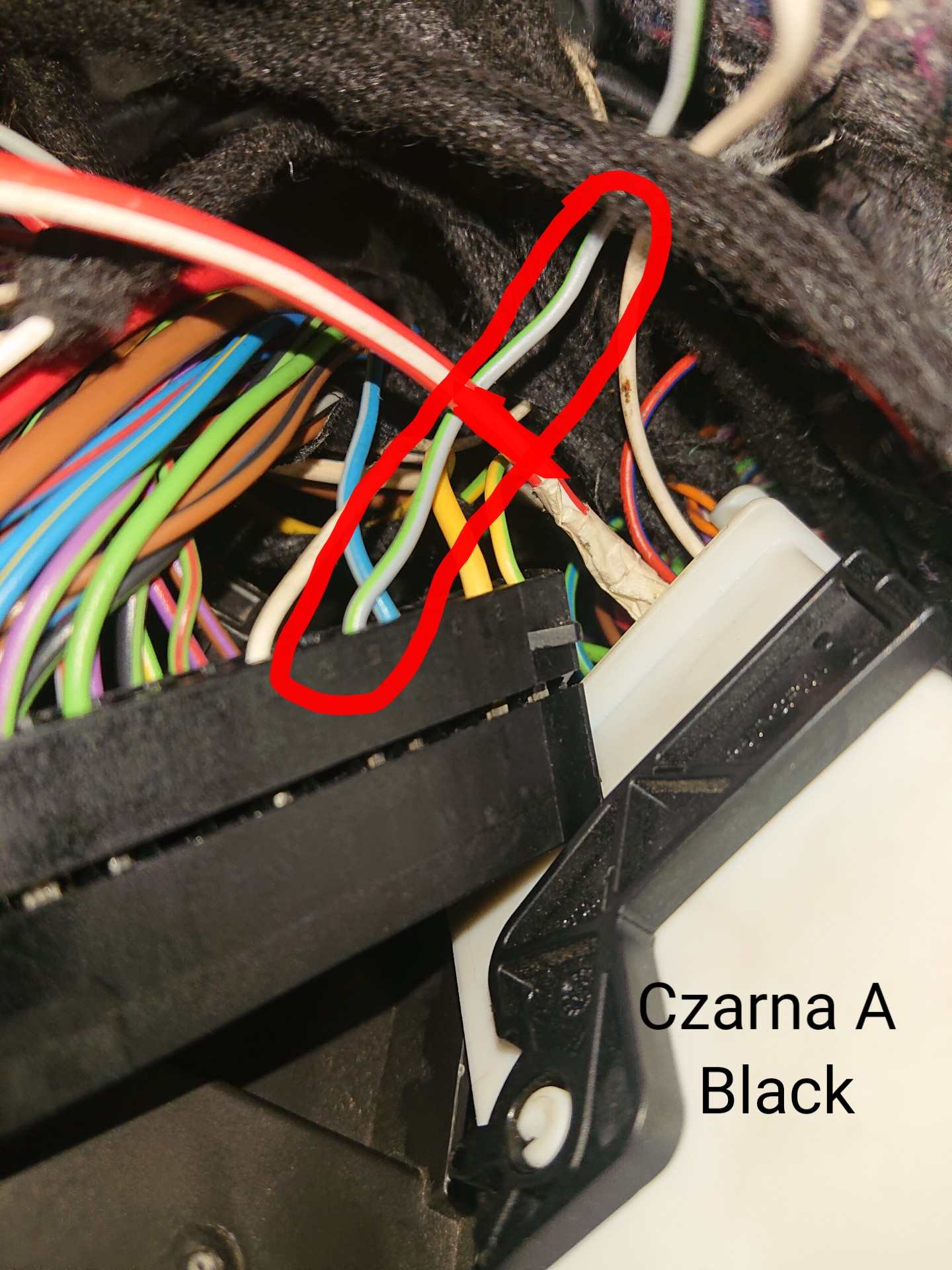

Please, pay attention to the wires that go to:
T73b/3, T73b/5, T73b/6 (white connector)
T73a/5 (black connector)
... and please don't cheats (in case you are doing them), I would like to get this over with as soon as possible. :lol:

We are unlikely to come to the color of the cables because it did not have such long cables and made a 2-cable bridge
Posts: 8988
KamilPL wrote: Mon Nov 15, 2021 5:37 pm We are unlikely to come to the color of the cables because it did not have such long cables and made a 2-cable bridge
So our destiny from this point is the realm of assumptions. :lol:
Let's imagine that everything is well installed.🤔
Let's try a new BCM coding:
7C8829F88861010001200EF06EEB9EC85BC062FF608D30C1200000030000 ....Let's start!
