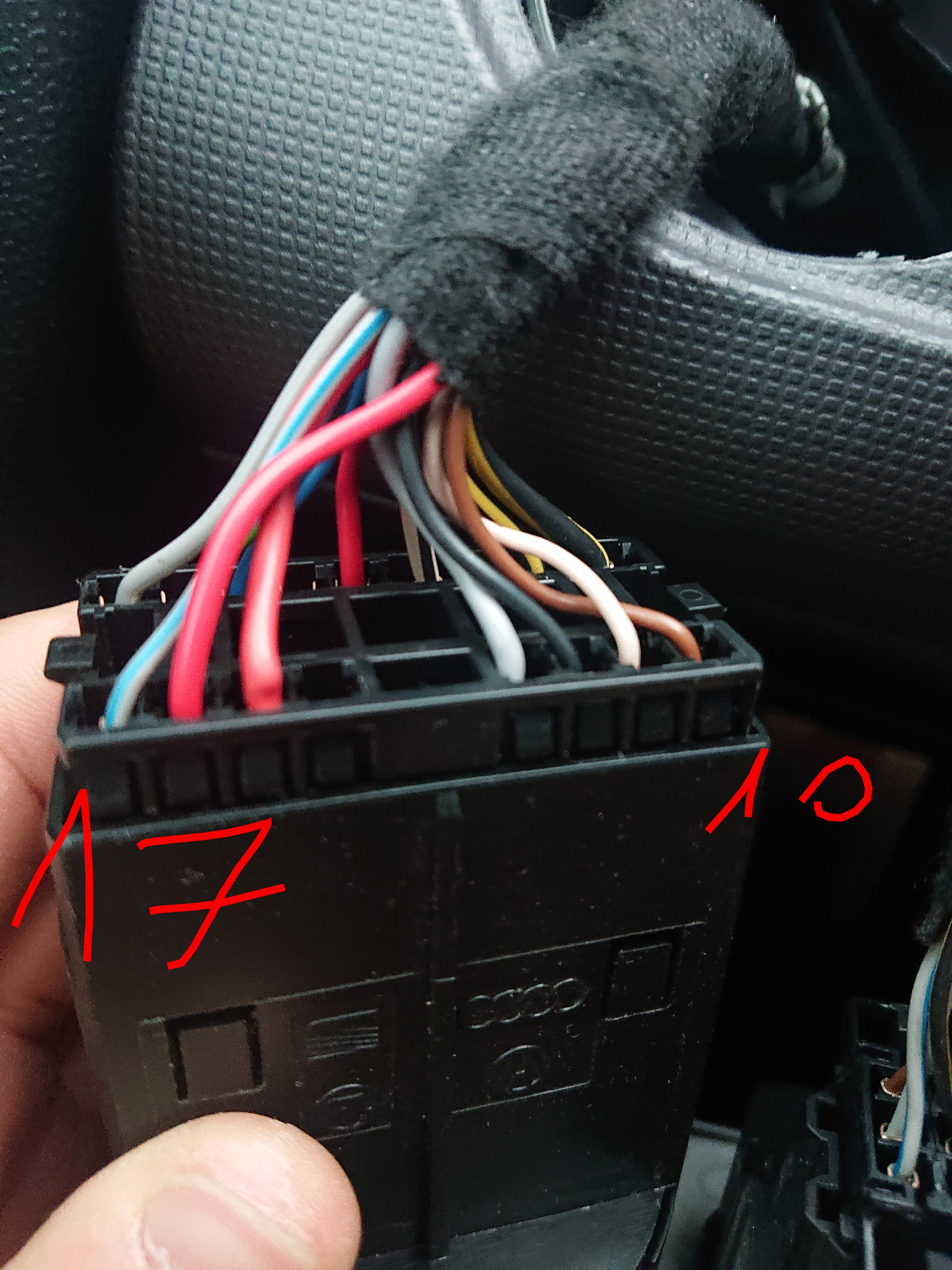

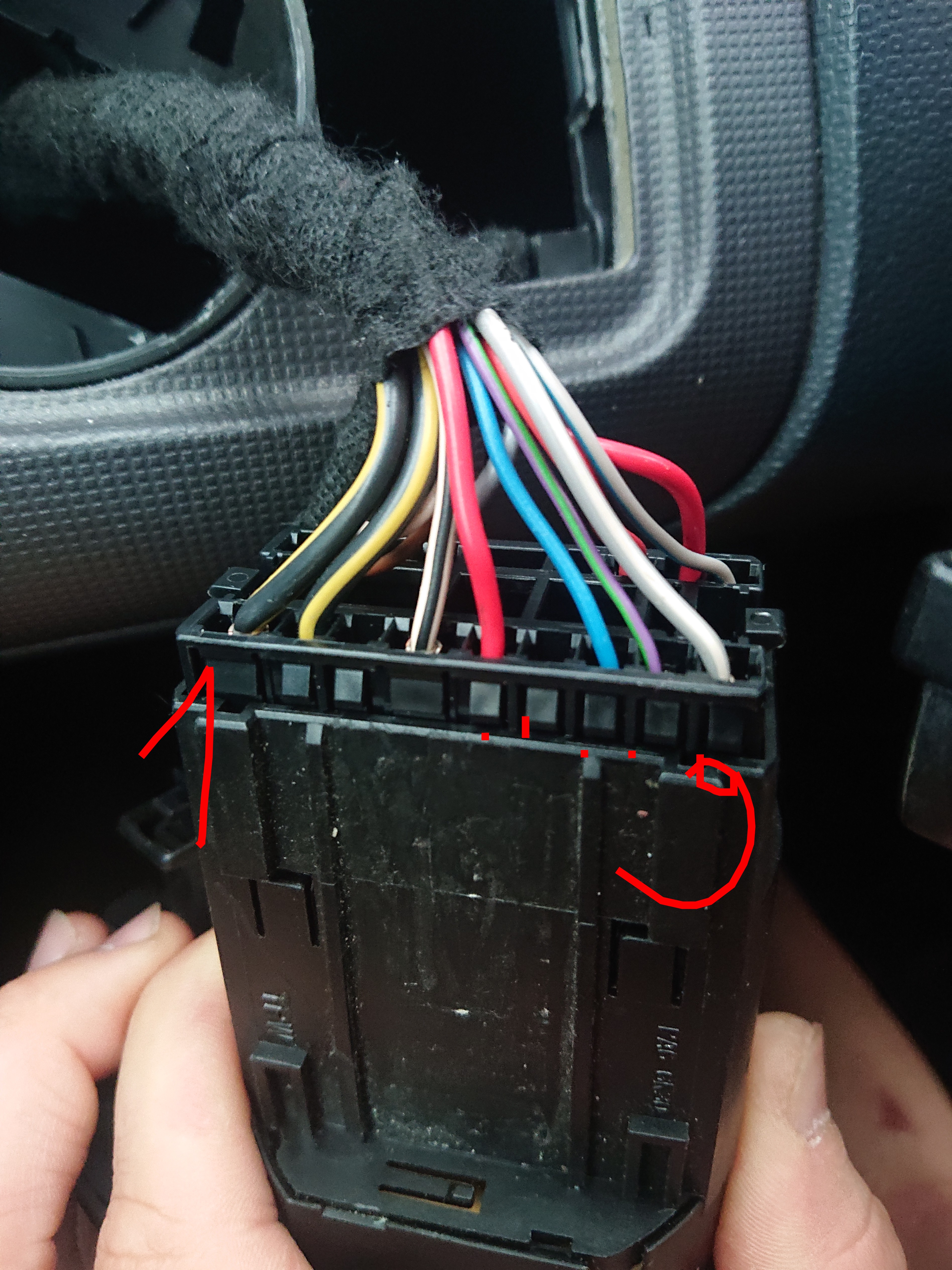

Seat Ibiza 6j1 Style 2013.
The update concerns the Rain / Twilight sensor add-on, fotochrom mirror, light switch (OEM SEAT 6J1941531AF 17pin) BCM 7H0937090.
After changing the BCM, the electric windows do not work, there is no lighting in the meter, the AUTO switch works, the wires are incorrectly connected because the parking lights turn on, the LED does not go out, the LED connected to the light switch, not the BCM.
How to make the windows work normally, I do not know what coding to adopt to make the windows work better :(
which cable to transfer from which cube so that all components work together without errors, CYCLO I count on your help :)

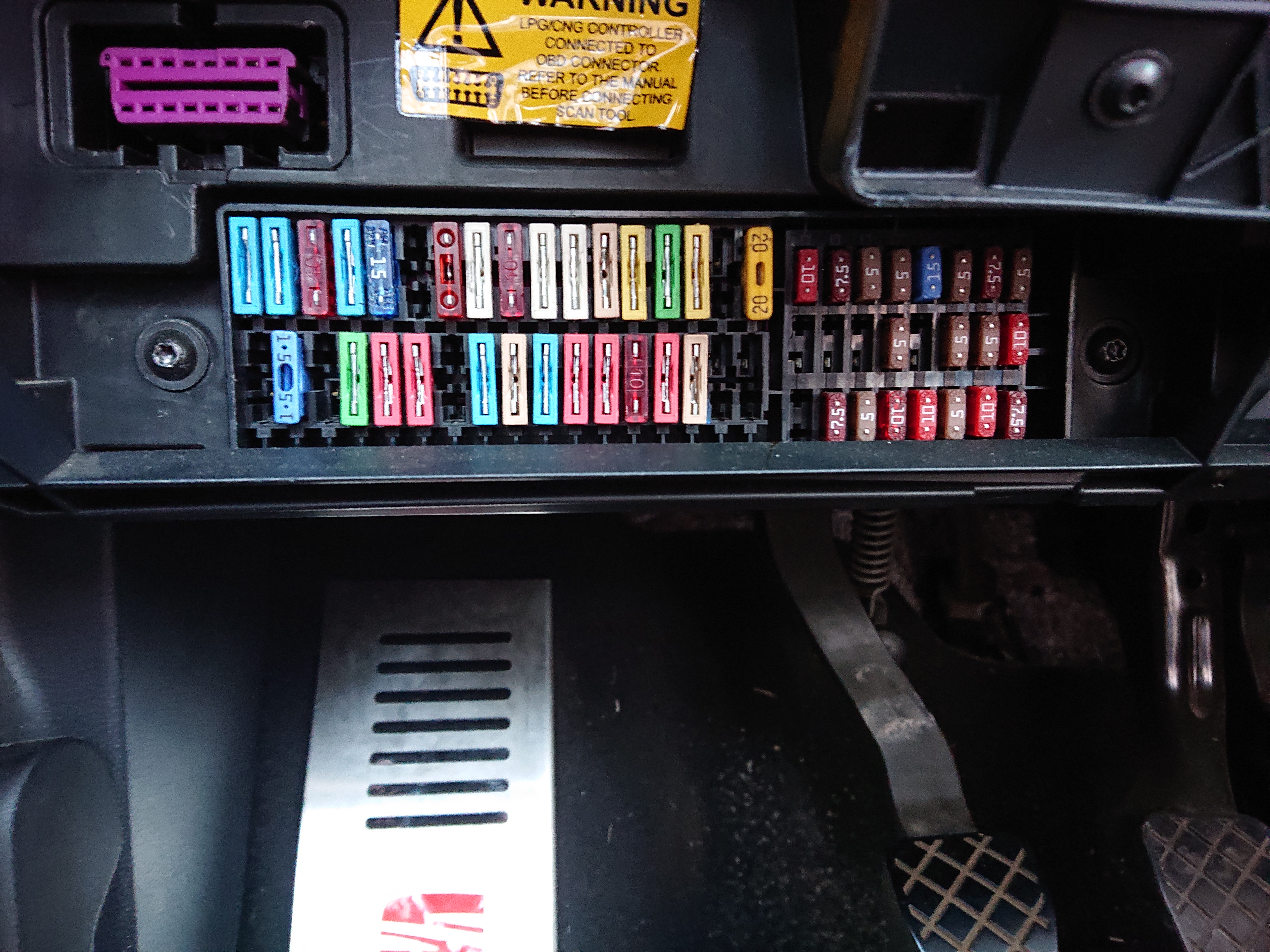

my ibiza 6j1 has lights from the ibiza 6P H7x2 + led, but the cables in the switch are wrong, the AUTO switch turns on the parking lights instead of dipped beam.
I am adding a photo of the fuses and the OEM light switch
Ibiza 6J.6P.jpg (63.67 KiB) Viewed 29365 times
