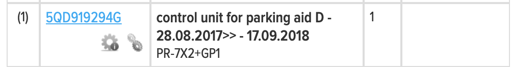

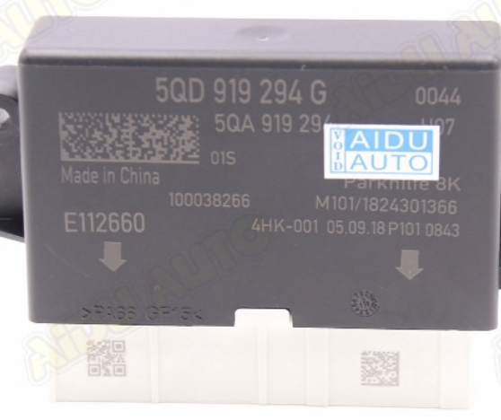

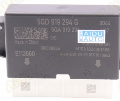

His Unit is 5QA-919-294 with software 5QD 919 294 G (these for Chinese market?)--- Park/Steer Assist
I wonder if this module is compatible with the polo system?
No. pièce Log: 5QD 919 294 G Mat: 5QA 919 294
Pièce: PDC 8 KanalH07 0044
No. de série: 000308418218305
Codage: 0431051001
Looking for a similar unit which are fitted on Audi A3:
;SW:5QA-919-294-B HW:5QA-919-294 --- Park/Steer Assist
;Component:PDC 8 KanalH07 0044, Coding:0470155811
;EV_EPHVA18AU3700000,009035,EV_EPHVA18AU3700000_009_AU37.rod
Codage: 0431051001

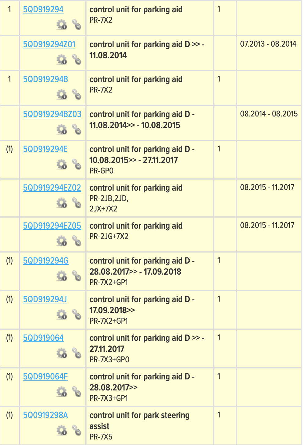

5QD 919 294 G "Park Pilot 2.0"
Use 6 sensors front and 6 sensors rear
Front sensors
2 x 5Q0 919 297 A sensors
2 x 5QD 919 275 A sensors
2 x 34D 919 275 sensors
Rear sensors
6 x 34D 919 275 A sensors
VW Polo 6C Original park pilot
5QD919294E Z02 control unit for parking aid PR-2JB,2JD,2JX+7X2
5QD919294E Z05 control unit for parking aid PR-2JG+7X2
5QD919294F control unit for park steering assist PR-7X5+GP1
5Q0 919 294 E , F

Yes; it's Chinese module. and seller told me that it is compatible with polo 6c
Today I sent him a message; he answered me this: (and he told me he would communicate my problem to their engineers )

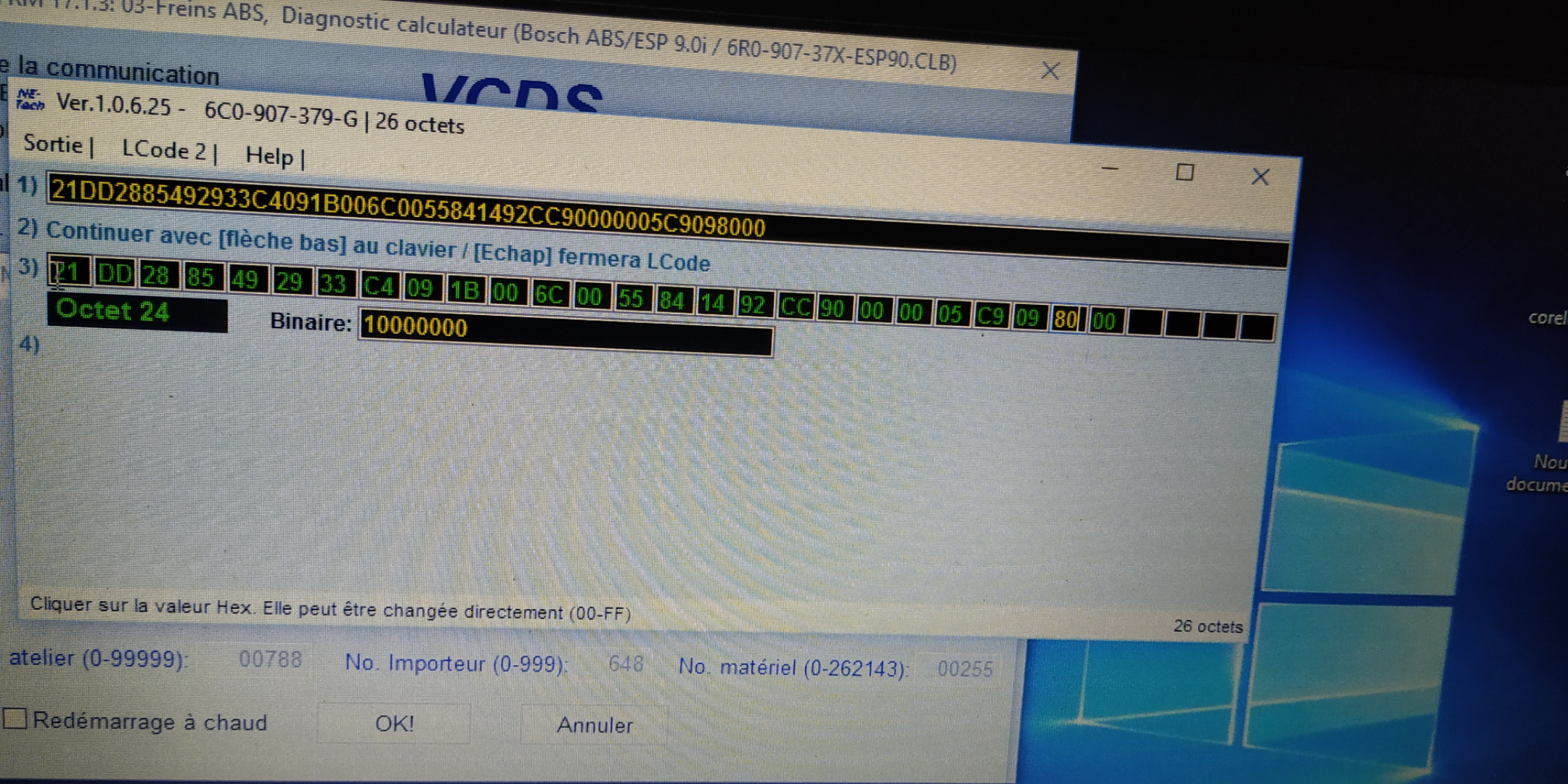

"Radar Code: (Coded with 5053, enter 19 Gateway - Installation List - Registered 10 Parking Aid into "10 Parking Aid" Code 0431051011) Manual gear shift 0431051001 ,ODIS enter 5F ,matching ,search for Car List of Functions BAP_Gen2, Install OPS or Parking ,Will not display the available settings ; [LO] _parking_assist_0x0A, No activation changed to activation ? [LO] _parking_assist_0x0A_msg_bus No activation changed to drive bus control
03 ABS pump - 24 sections --- changed to 20
wheel sensor Byte 26---Change F0"
I didn't understand exactly what means"03 ABS pump - 24 sections --- changed to 20 / wheel sensor Byte 26---Change F0"

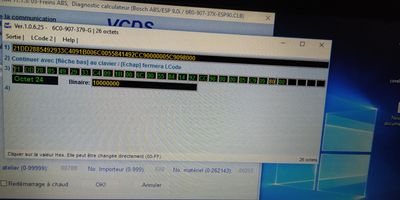

my [03] break ABS coding is:
- Posts: 128
- Drives: Polo Beats 2017
- Location: Ireland
Re: Retrofit park pilote 8K OPS for polo 6C 2015 [help]
Well according to what he said you would need to change byte 24 in abs long coding from value 80 to F0 for wheel sensor. I cant understand the section 24 part? Ask him to explain better
there are no labels for abs module on either the obdeleven or vcds I think for safety reasons.
I know these bytes:
Byte 22 - Bit 0 = Hill-Hold Assist on/off
Change in ESC Menu Setting:
CB = ASR On / ASR Off
D7 = All On / ASR Off / ESC Off
DB = All On / ESC Sport / ESC Off
E7 = All On / ASR Off / ESC Sport
Byte 23 - 09 - No Front Assist radar with / Without CCS
F9 - Front Assist Radar and CCS
FB - Front Assist Radar, Adaptive Cruise Control and Manual Gear
FD - Front Assist Radar, Adaptive Cruise Control and Automatic Gear
I know these bytes:

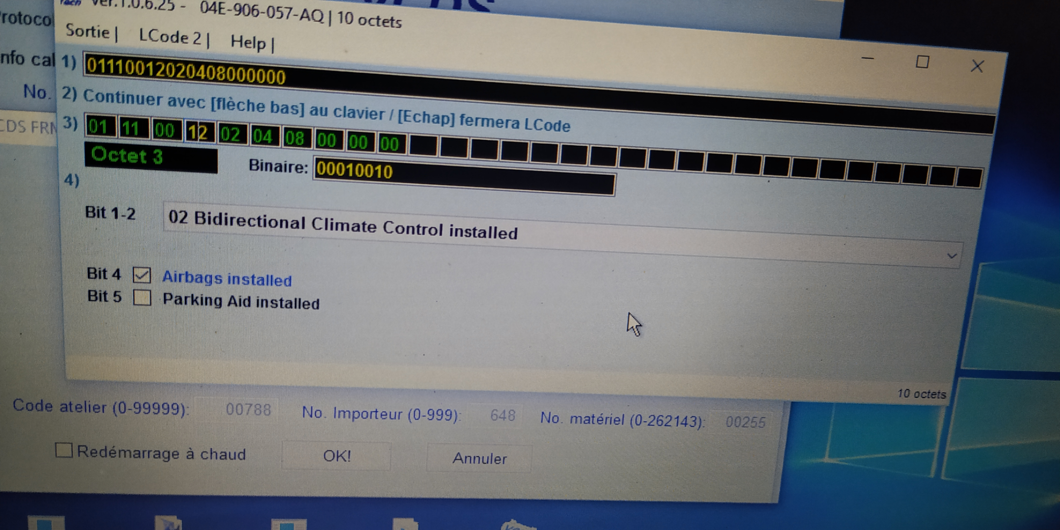

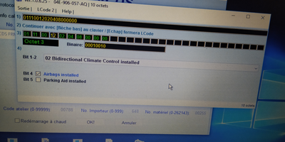

" 03 ABS pump - 24 sections --- changed to 20 / wheel sensor Byte 26---Change F0 "
Hi these settings are not for your polo abs because the abs coding is only 25 byte long ... must be for golf abs..
Also the engine code for pdc is Byte 03 Bit 5 and not bit 4 that is for airbags my mistake.

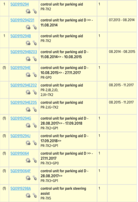

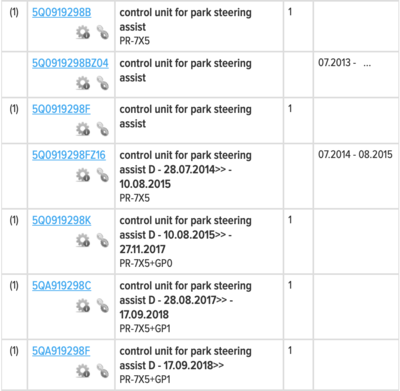

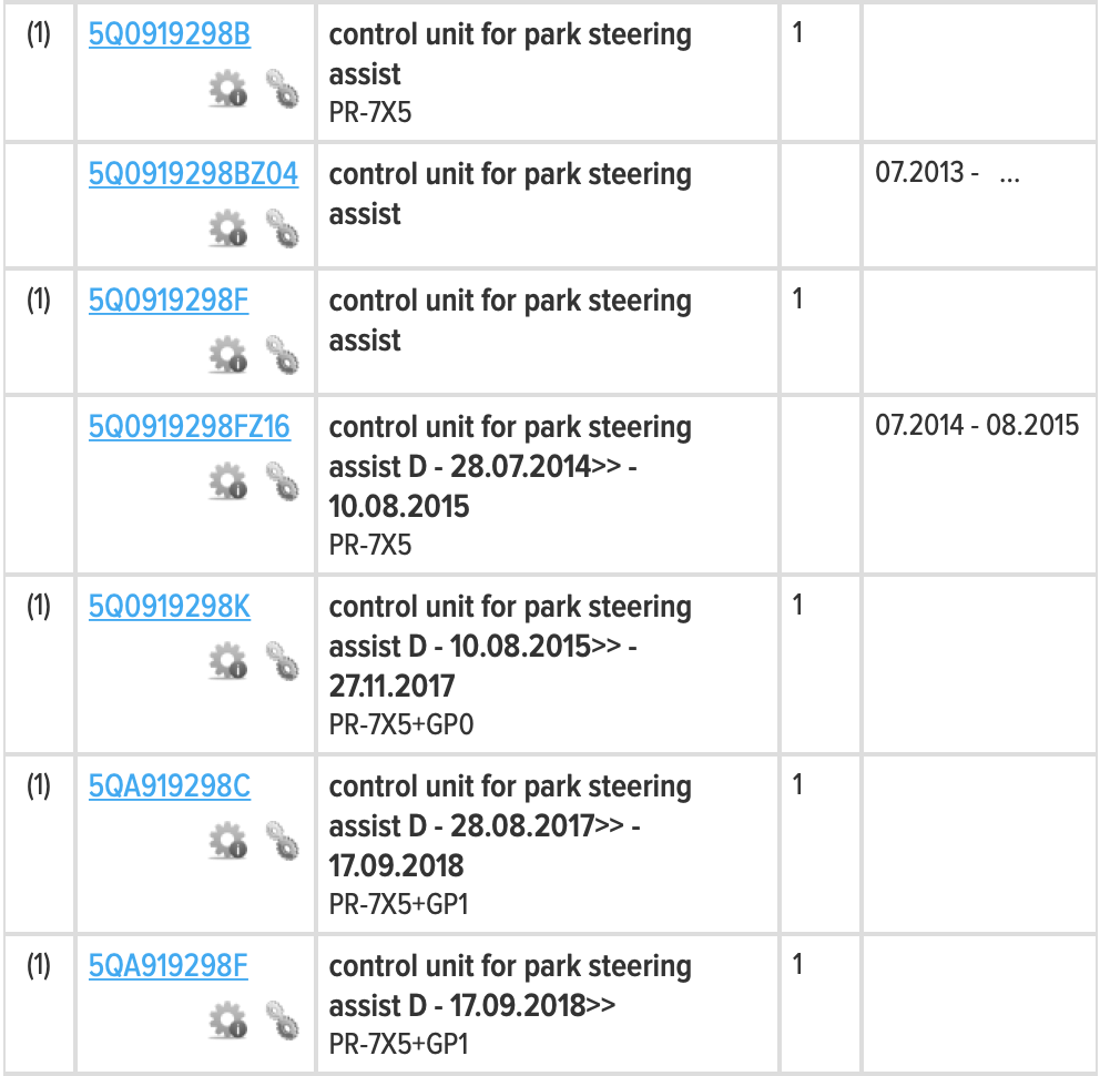

7X2 = Park distance control in front and rear
Any module with 294 is parking aid while 298 is park steering.
This is pr-codes for parking control:
7X1 EPH Park distance control
7X2 EPH Park distance control in front and rear
7X3 EPH Park distance control
7X4 EPH Park distance control in front and rear
7X5 EPH Park assist
7X6 EPH Park assist
7X7 EPH Park distance control in rear with rear view camera system
7X8 EPH Park distance control in front and rear,and rear view camera system
7X9 EPH Rear view camera system
Just more info on 94 series:

The question is: 5QD919294G unit, is it compatible really with polo 6c or not? And what coding is needed?
