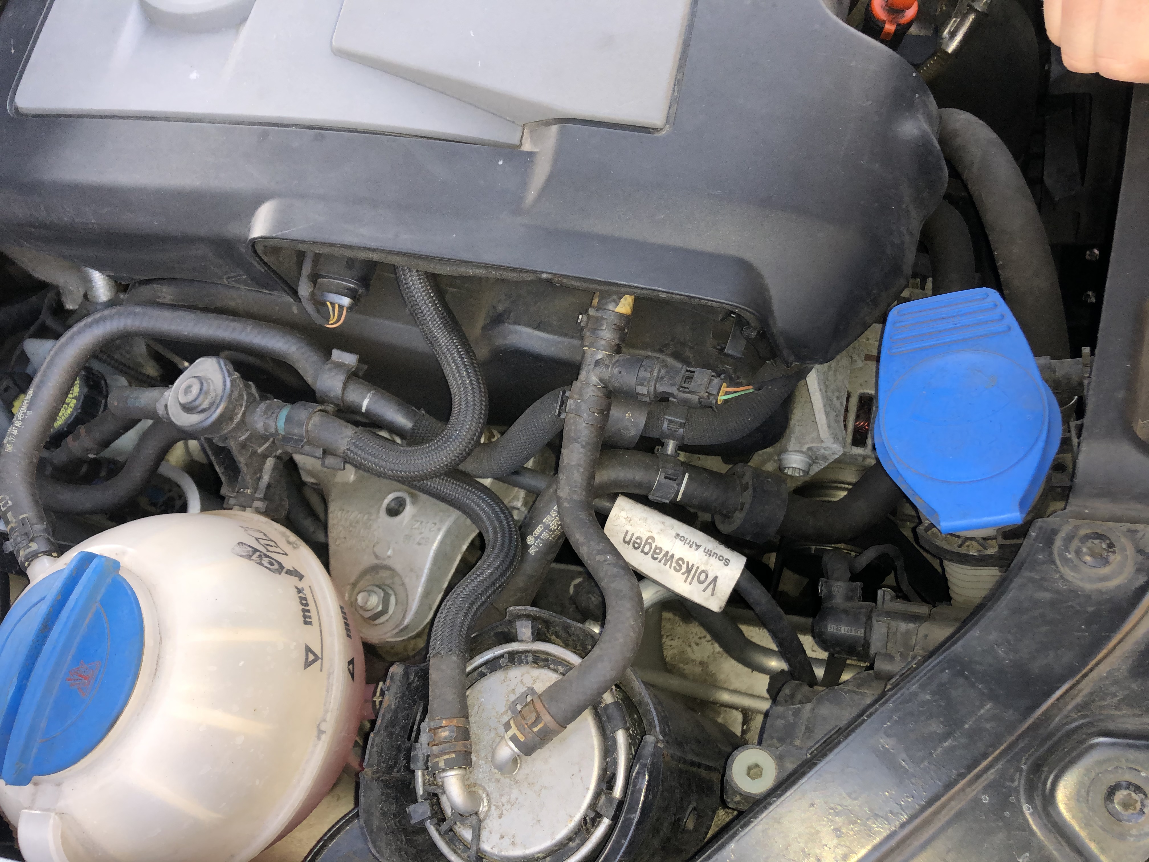

Folow the hose from IC on left side it should be sround there

Re: P0101 code - MAF
Post by BrennB »
Would it be around there?

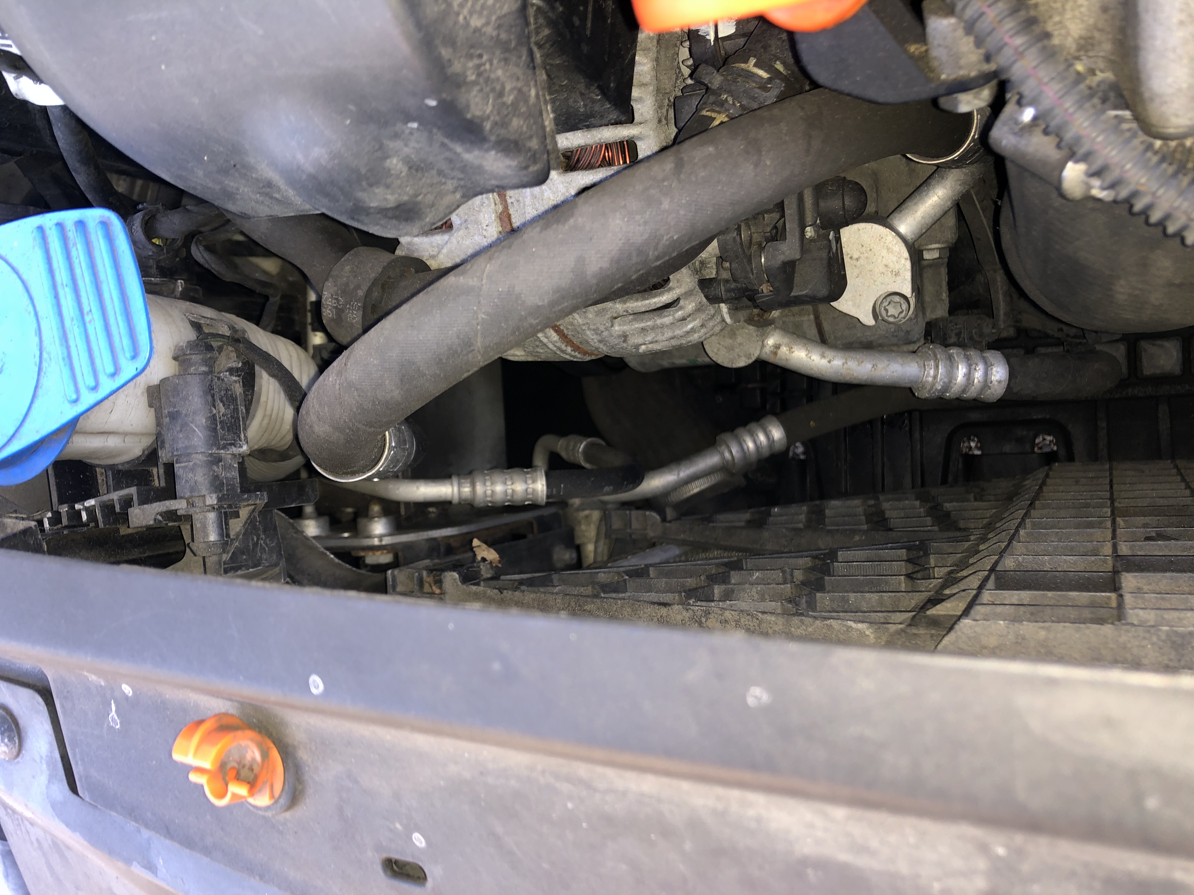

2 cond pic, left lower part you see that fat tube folow it down
Post by BrennB »
Looks like I’ll have to jack it up and take the tray off underneath to get to that maybe. Thanks

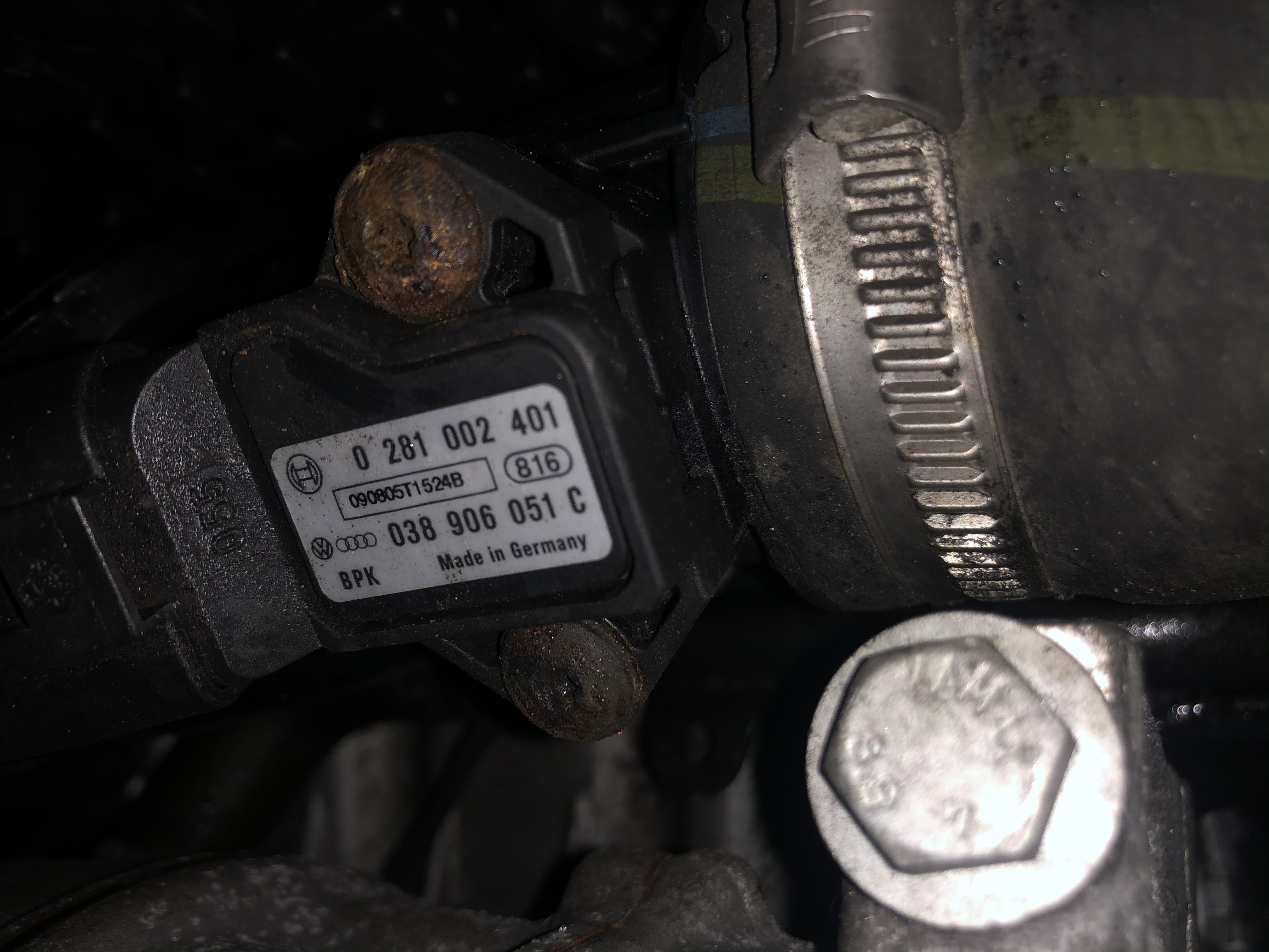

Post by BrennB »
Is this it? It’s actually on the big ic tube
Yes it is
