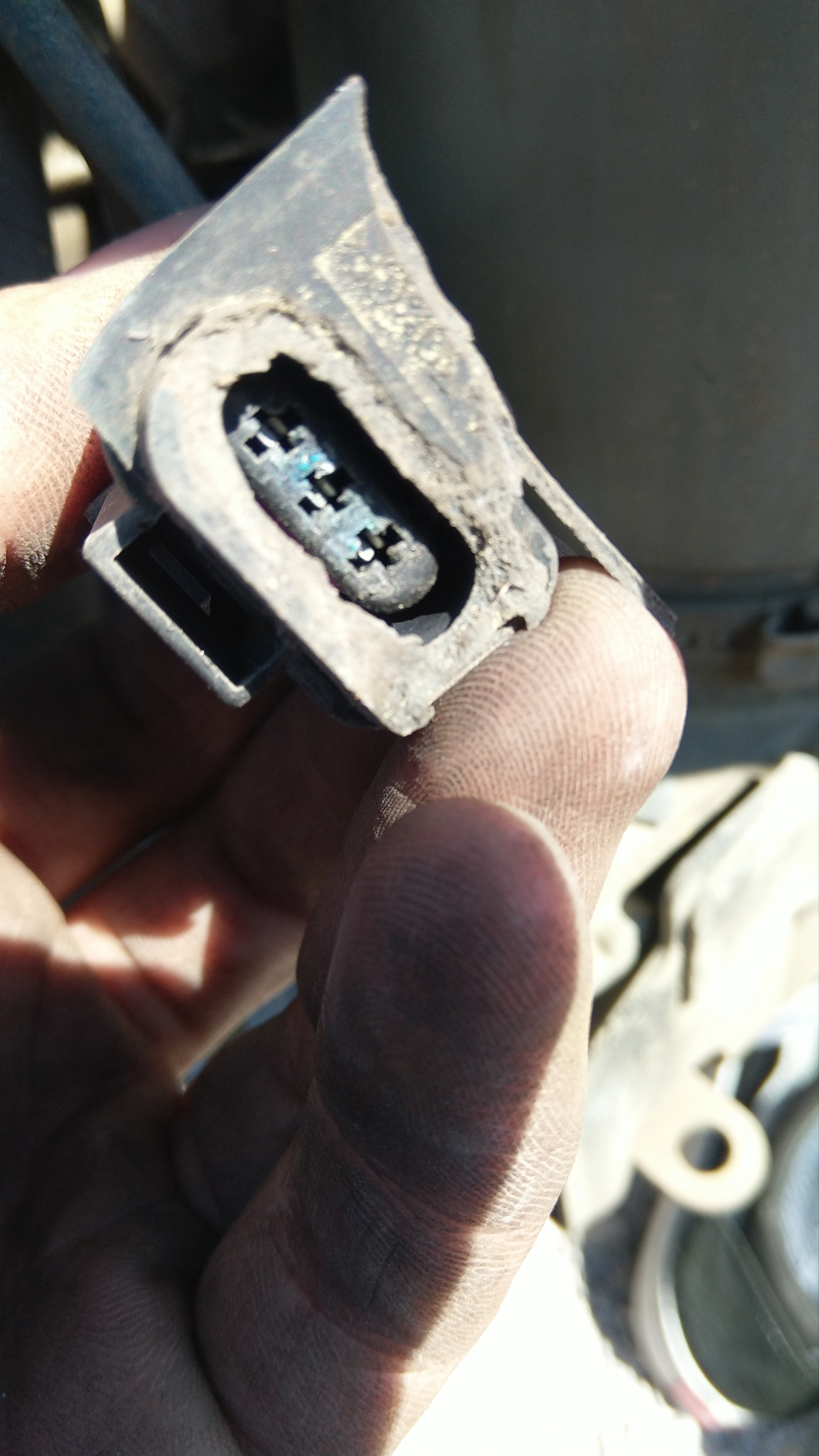

If I understood right, the signal from G250 goes directly to Power steering pump ( 3 pin)

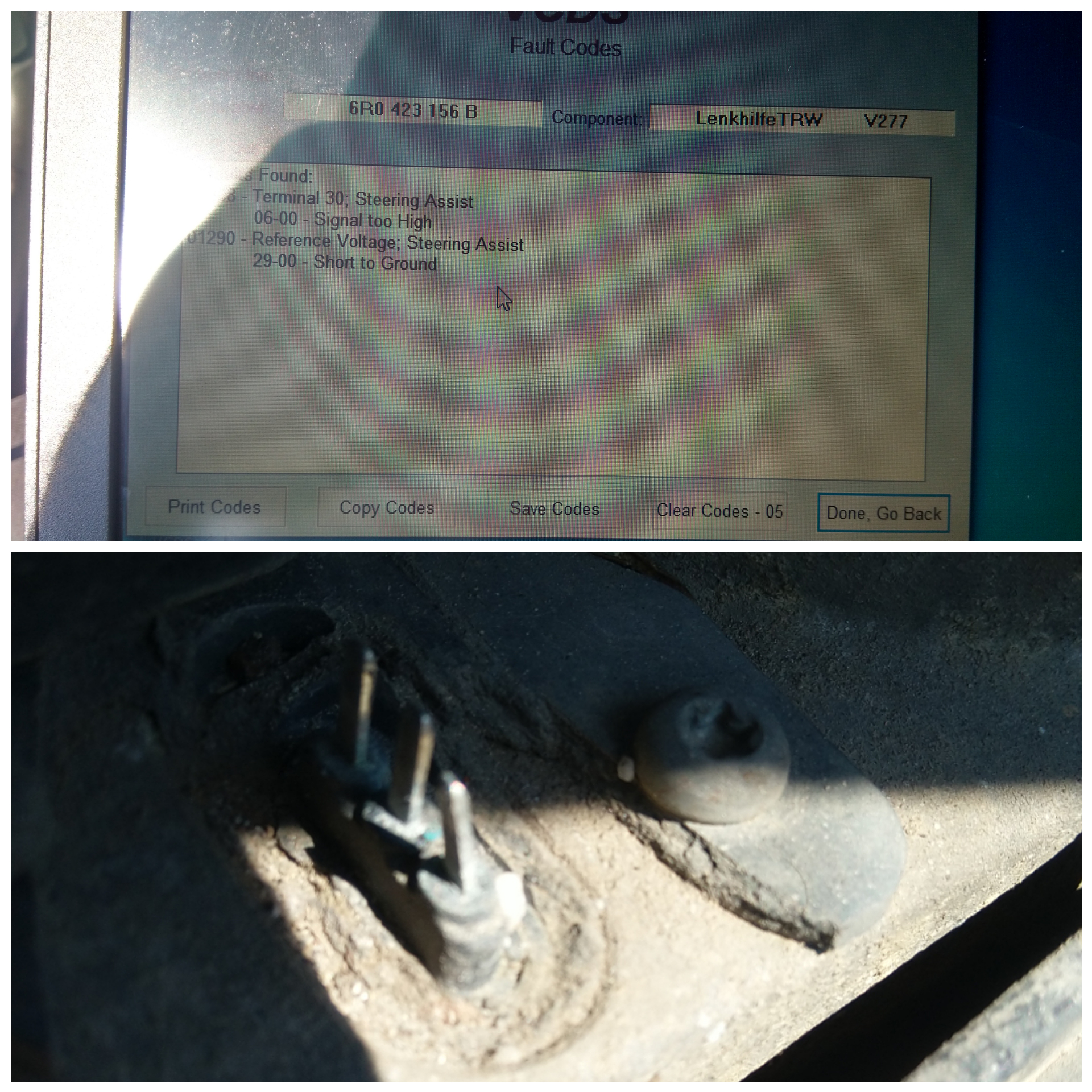

When it was summer I lost power steering when I hit a pothole.
I got this error then And correct me if im wrong this is the connector for the G250 sensor.
I have cleaned the best and ancored it down, but it seems same issue. Will redo and check again.

Yes, G250 is a 3-pin connector. Canbus and +15 is a four-pin connector.

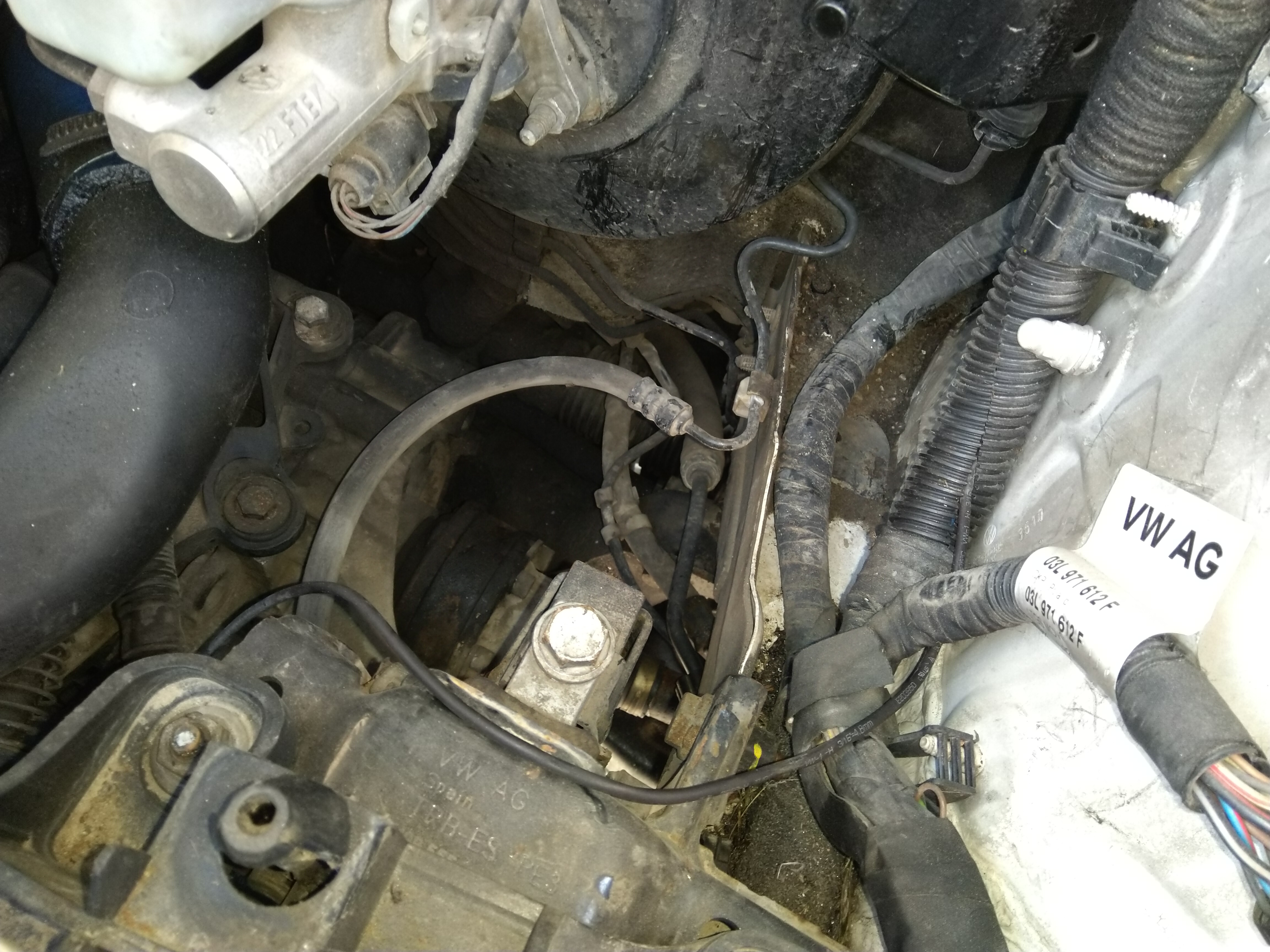

Update:

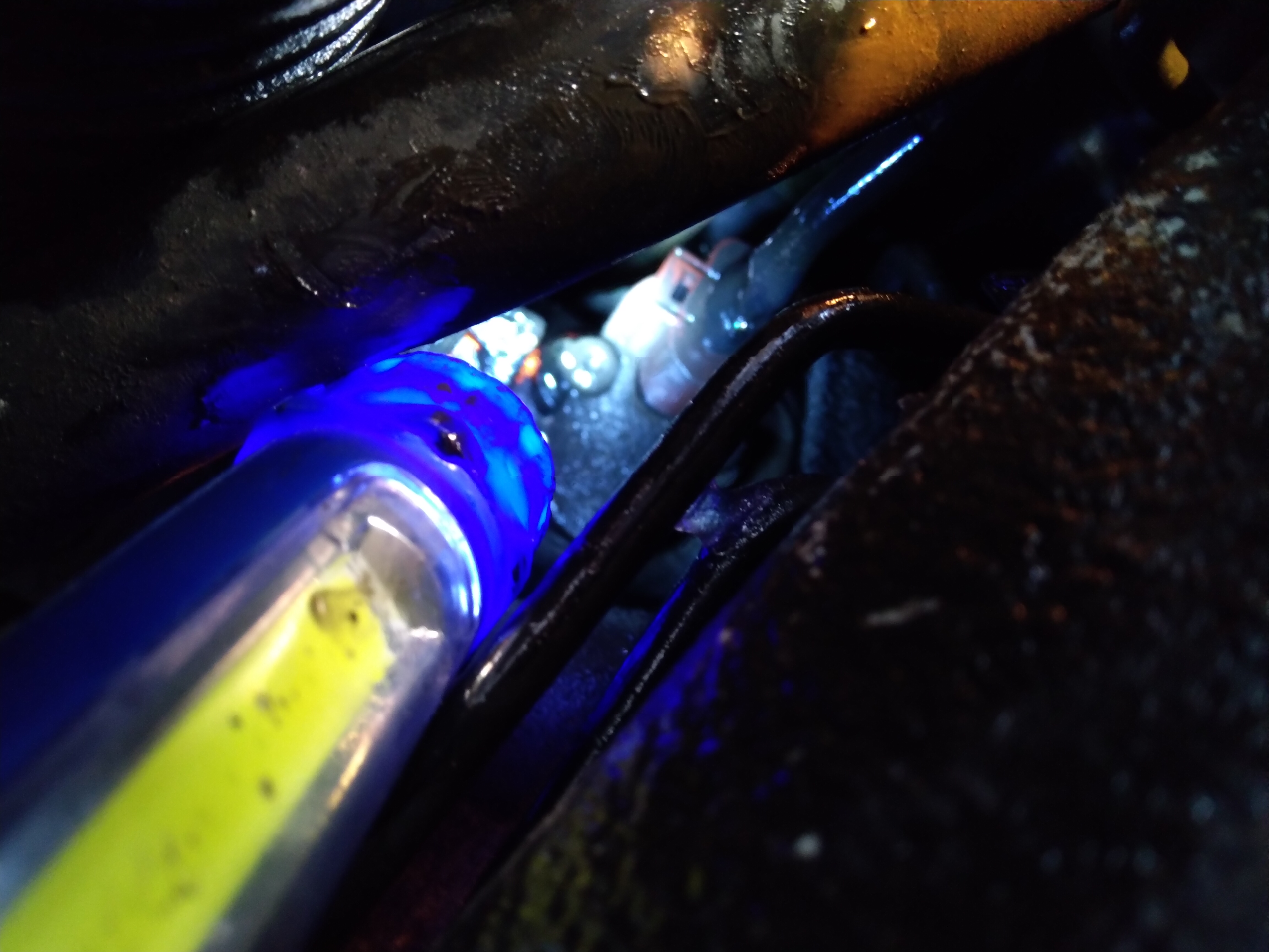

You cant get to the sensor by removing the air filter box, and battery.
Only way you can get to it is from the bottom or, thru the wheel arch housing. Also there is a hose in the way. And I always have an issue with these VW connectors to get the off.
unfortunately i couldnt get really to it, since i didnt have a proper jack or jack stands for safety.
What I did, i sprayed the heck out of it with contact cleaner. Also did the same on power steering pump. If this issue strikes me again 100% im converting to G85 sensor because its protected from the outside elements.

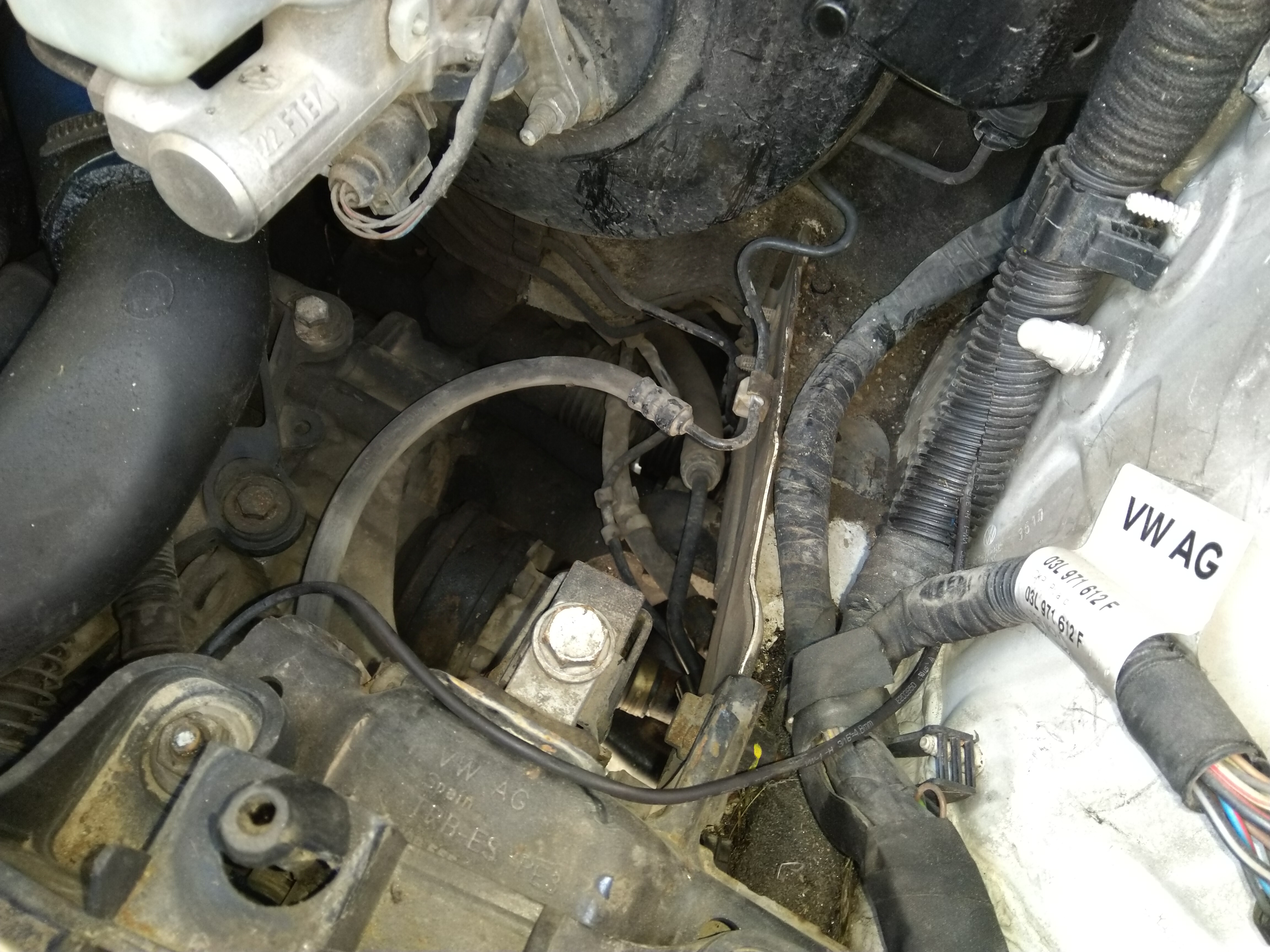

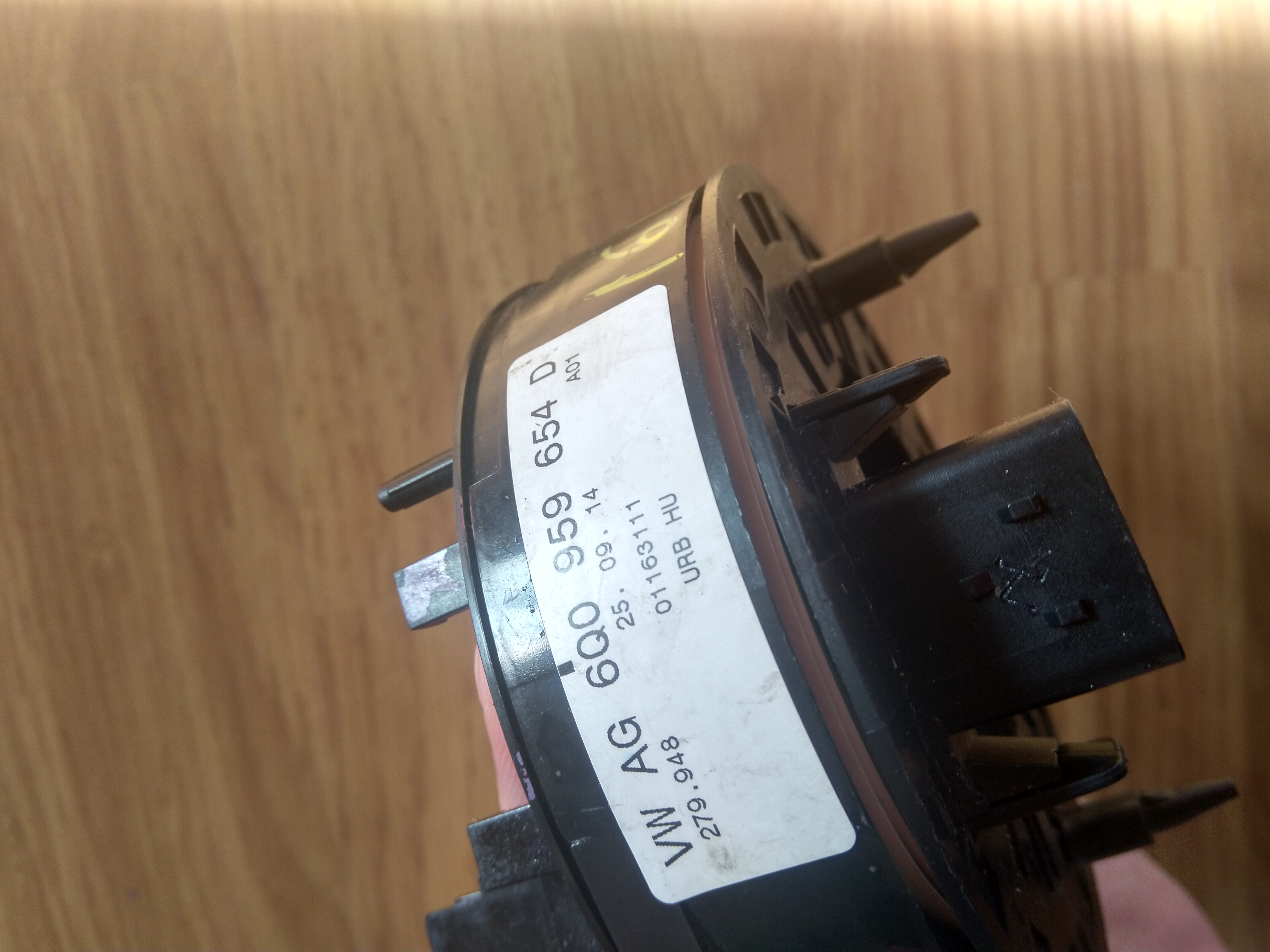

Is this the correct part number "6Q0959654D" for the G85 sensor?
How will i know if it supports my airbag? I have the leather steering wheel with no commands.
If i decide to add steering wheel commands does the 6Q0959654D support it?
Is there a window on the clock spring so i could find the center of it?

Nou need to check the part number of your stalks. If you have the 6Q0 stalks, take the 6Q0 G85. If you have the 6R0 stalks... you know the drill
It doesn't matter concerning MFSW etc, one size fits all.

My stalks are SQO 953 503 DN, so 6Q0959654D is needed

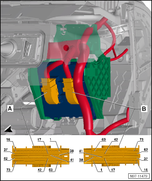

I have ordered the 6Q0959654D it should arrive tomorrow. Can you help me with the schematics.
Correct me if I am wrong.

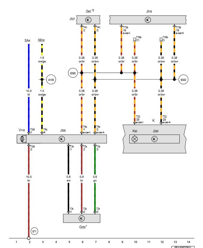

I will run additional two wires back from the stalk pins, or directly from the G85 ( T41 connector, pin 2 and 3)

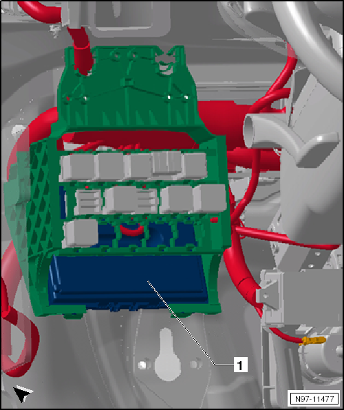

Then under the relay box where the BCM is, Im toing to tap the wire leading from G85 (T41 pin 2) into BCM Connector 73b, pin 18)
After that G85 pin 3, to BCM 73b pin 19.

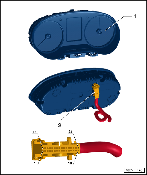

Also The module J285 is the cluster, I also need the Wires from G85 to branch off, G85 pin 2 to Cluster wire coming from connector T32 pin 29, and G85 pin3 to Cluster T32 pin 28.
I'm tapping into the wires, i'm not cutting them off right ? B connector is the one on the left side (closer to the clutch pedal) Any tips of better access of the B connector ? without pulling the dash
Do I need to run any more wires to the light switch to get the cornering lights or as you said it is done by BCM

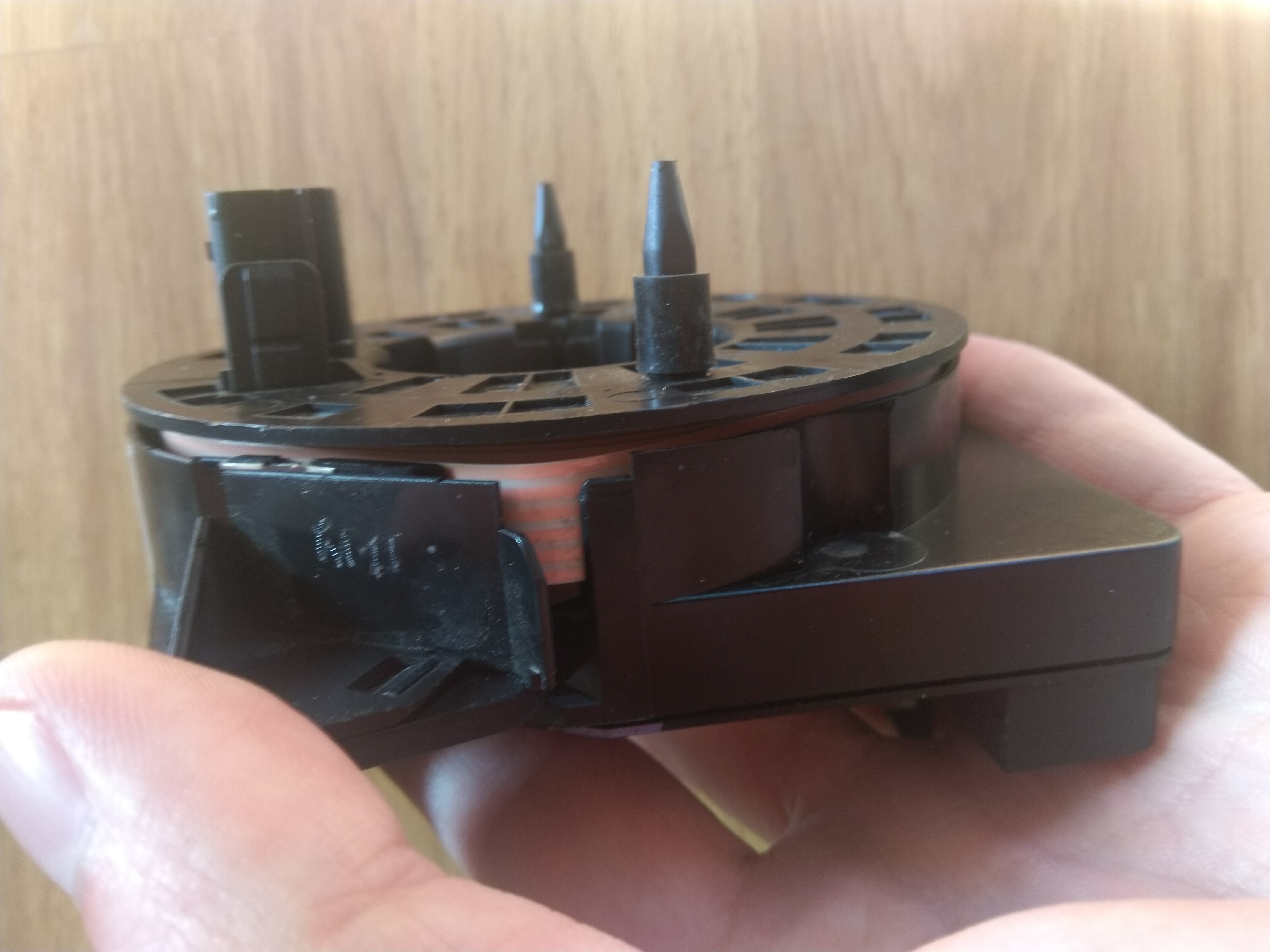

Could you help me center the g85 before install. Is this ok? Should i turn it max to one side (till i feel resistance) and counter turn 1.5 revolutions until the jack lines up with part number sticker?
I count three turns, when i go 1.5 turns my connector is opposite of part number sticket aka sticker 12 o'clock, and jack 6 o'clock
