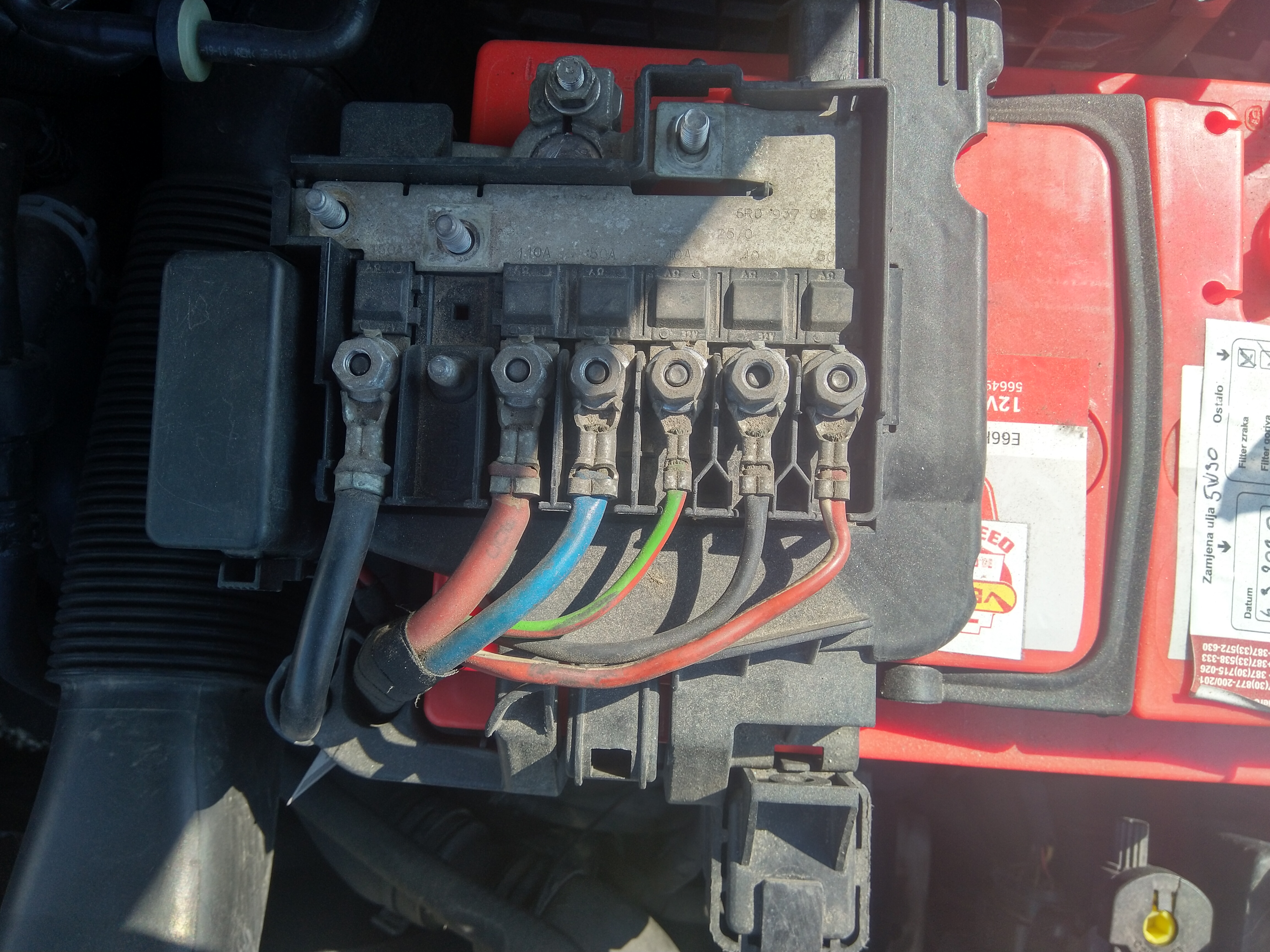

No this is about the blue wire to B+. B+ is the battery, not the blood type

Blue wire from battery?
I know that this wire leads to power steering pump, does it also split to the g250 sensor on the rack?
I cleaned like 3 months ago these contacts.
I wasnt able to remove the connector blue brown from the pump.
