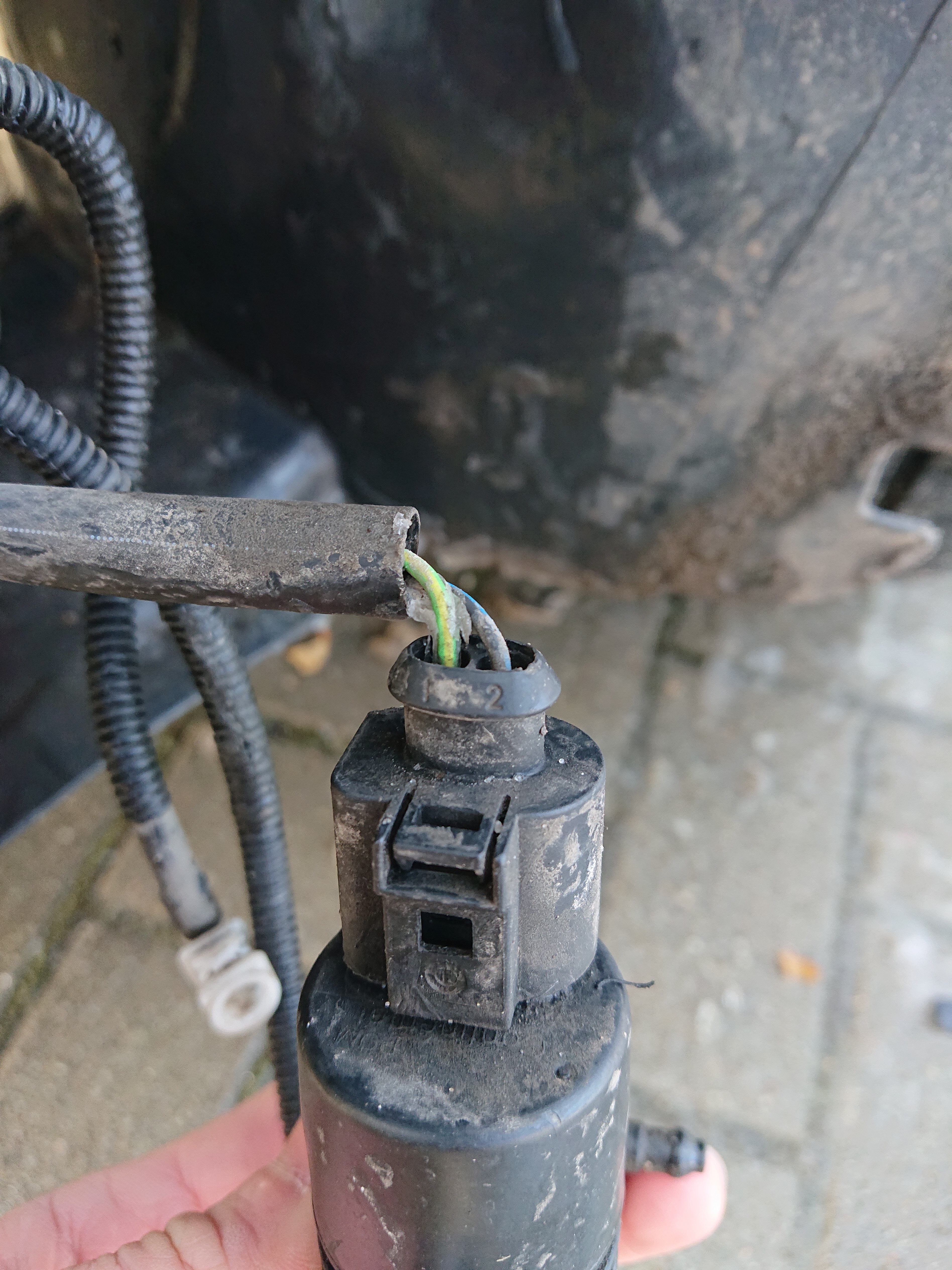

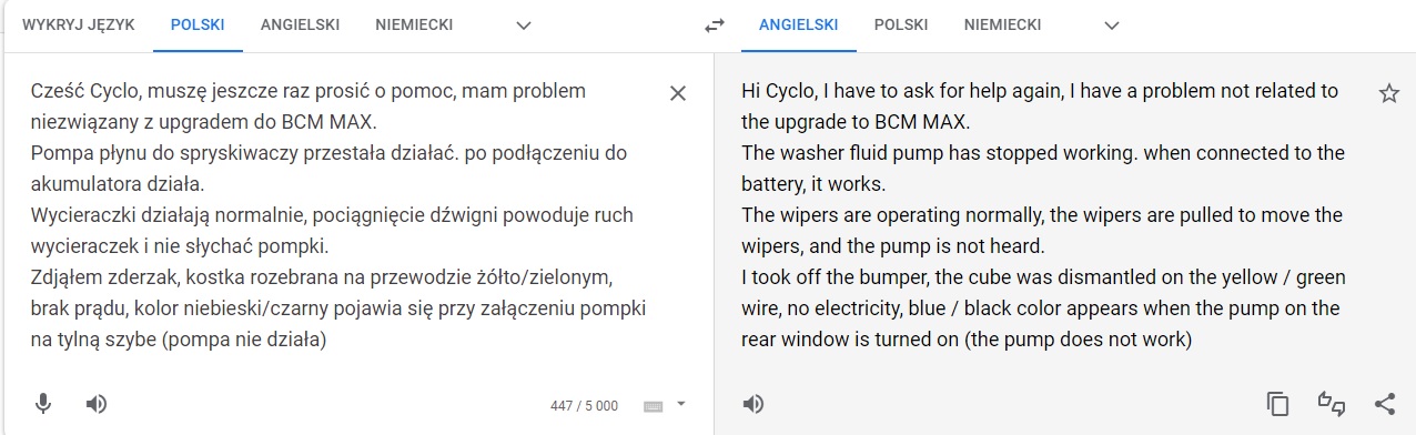

Hi Cyclo, I have to ask you for help again, I have a problem not related to the upgrade to BCM MAX.
The washer fluid pump stopped working. when connected to the battery, it works.
The wipers operate normally, pulling the lever causes the wiper to move, and you cannot hear the pump.
I took off the bumper, the cube stripped on the yellow / green wire, no electricity, blue / black appears when the pump is turned on the rear window (the pump does not work)
tomorrow I have a departure 700km and the weather is like this. that after a few km the glass is as dirty as a pig ... :(

KamilPL wrote: Thu Dec 23, 2021 6:18 am ... the cube stripped on the yellow / green wire, no electricity, blue / black appears when the pump is turned on the rear window (the pump does not work) ...
Please write this part in Polish using the common language (please use the punctuation marks correctly, please construct the sentences correctly), maybe I can understand it better if I use the translator. Post images if possible. Thanks a lot.

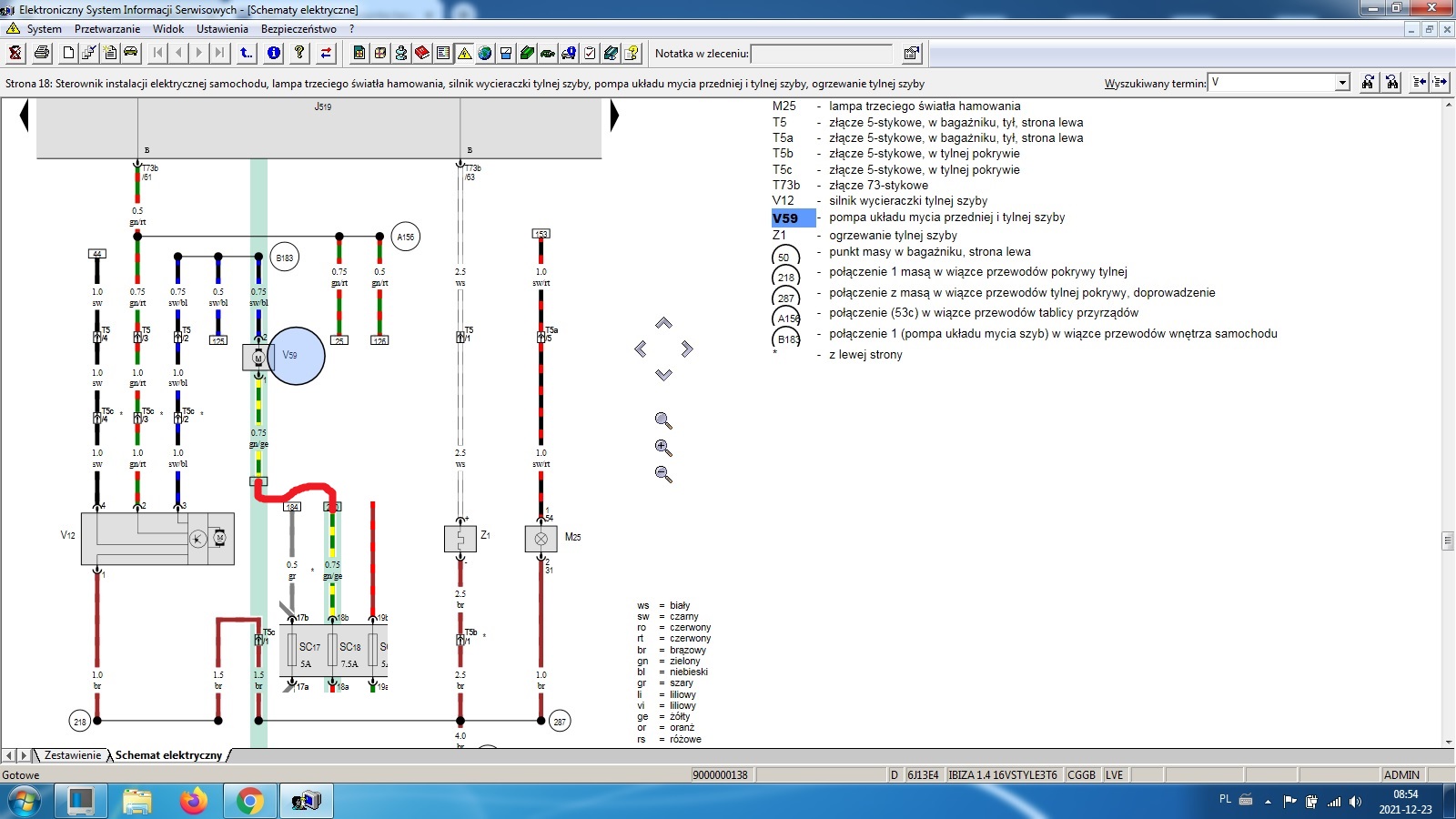

1. yellow / green is + for the windshield and - for the rear
2. black / blue is - for the windshield and + for the rear
No current (+) to windshield washer
No ground (-) to rear window washer
Cable # 1 (Yellow-green) damaged? no error in BCM ??!!

ELSA in the Polish language version helped :)
I'm going to check SC18 which according to the diagram is a resistor for +/- yellow / green cable :)
Posts: 8988
SC18 is a 7.5 Amp "fuse", it may have blown, which is the most likely cause as per your indications.
