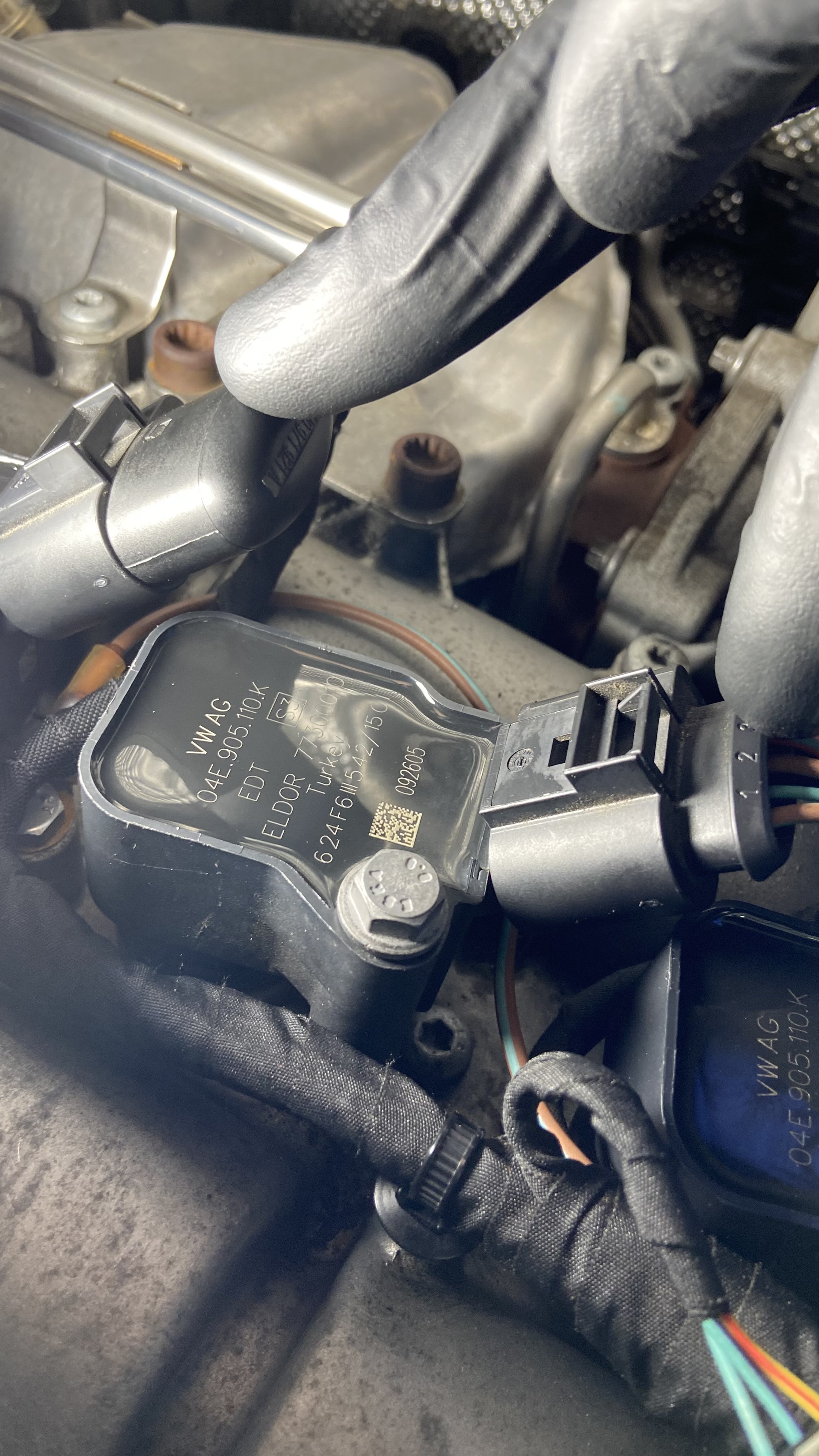

I changed the spark plugs today! Everything went stunningly well.
The ignition coil pulled worked well and the wire hose clamp tool was amazing to have (I’m never going back to a non-wire hose clamp tool - I can’t recommend the wire hose clamp tool enough).

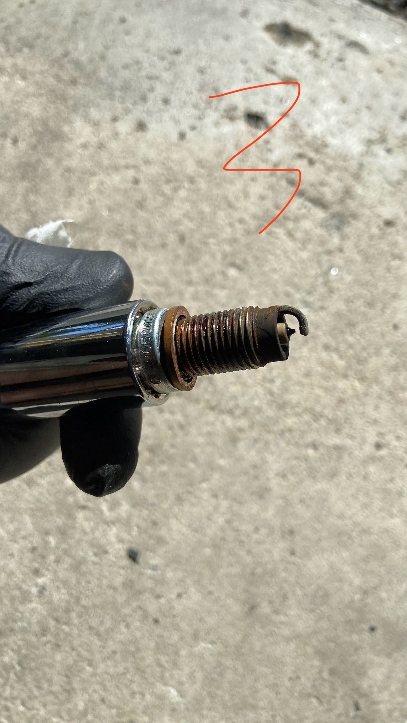

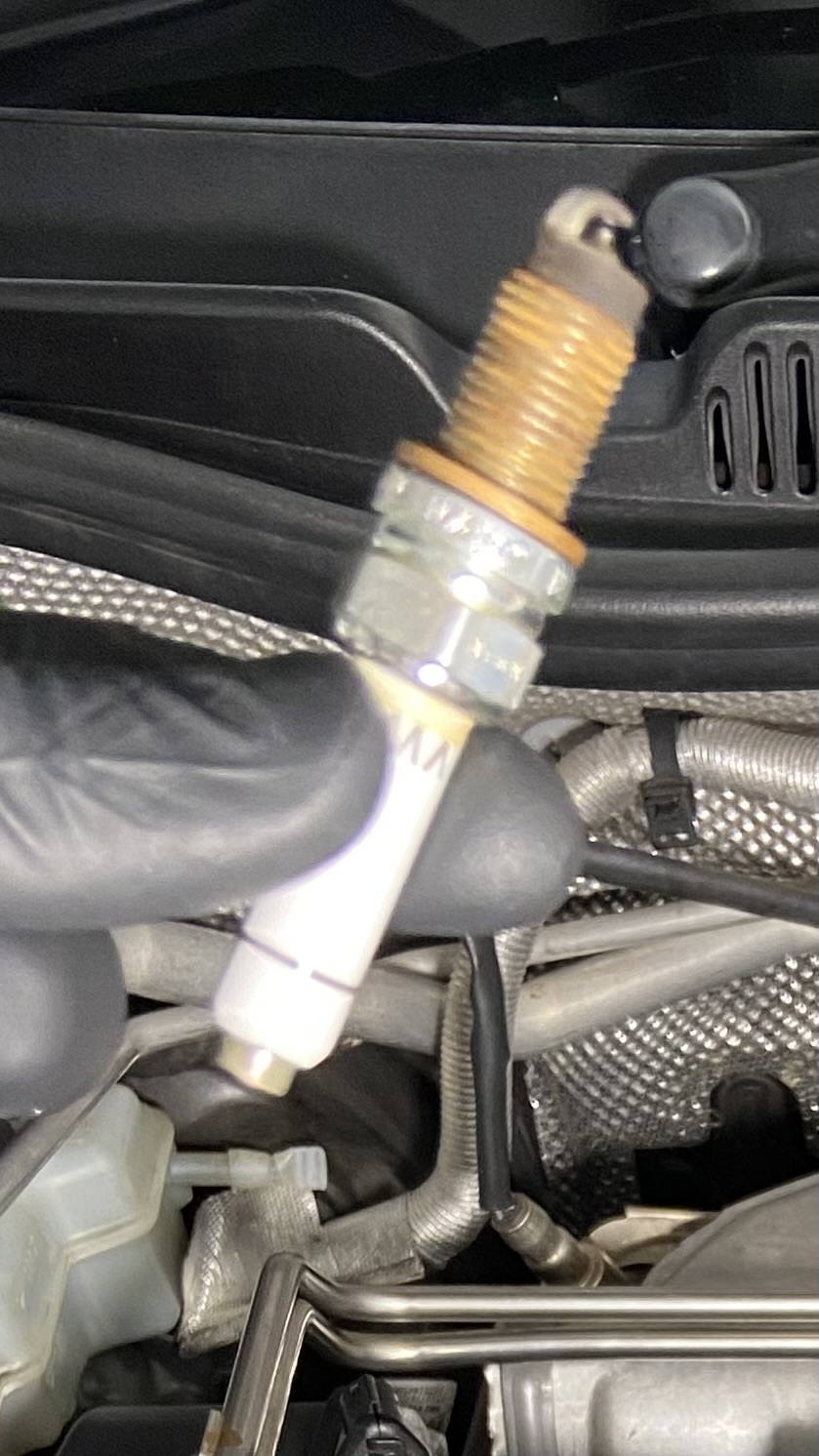

The old spark plugs in cylinder one, two, and four (counting left-to-right) all looked like so:
The old spark plug in cylinder three looked a little different with some oily residue on the thread:

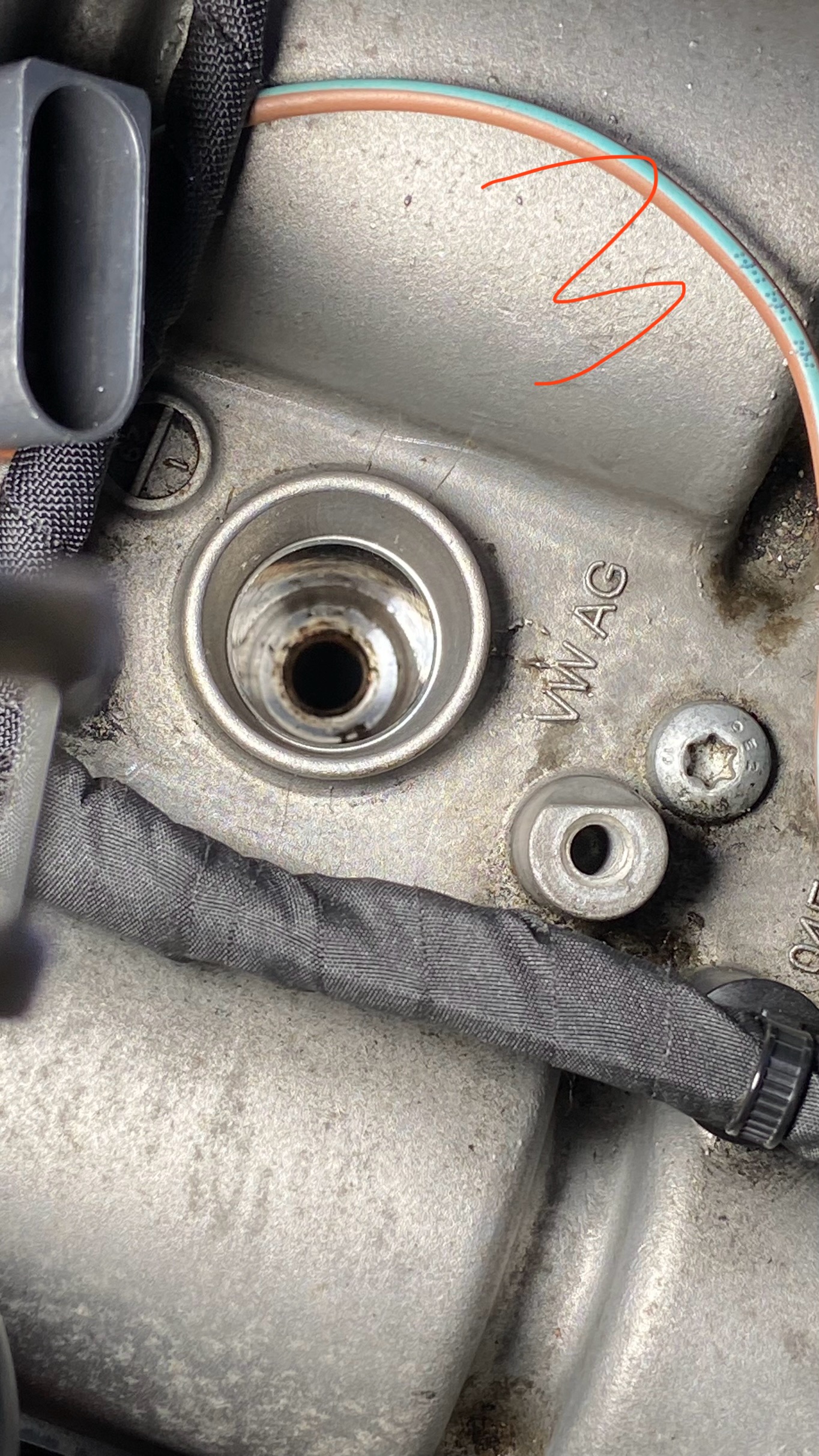

Cylinder three spark plug hole (the hole of cylinder one, two, and four looked identical):
I am wondering what the copper/brown pigment is on the thread? Some sort of corrosion is my guess. How do the health of the old plugs and cylinder look in general? I believe they look alright from doing some comparison to other photos. However, I am curious as to why cylinder three had the oily residue on the thread :|

I also meant to ask if one can order the wire cover from the ignition coils as an individual component. The ignition coil wire covers on cylinder three and four are missing, compared to cylinder one and two. Perhaps they were lost at some point by a workshop when I didn’t own the car. I can’t see an individual part number on ETKA.

It's normal for both cylinder to miss this part. Cables are too short.

Oil on the spark plug thread is relatively normal because it usually occurs, defining the exact cause is not easy (head gasket, cylinder rings...).
It is not worrying if you have not detected abnormal oil consumption, it would be relatively worrying if the oil was clearly visible on the spark plug electrode.
Regularly making short trips helps increase the chance of seeing oil on the spark plug threads.
Without being an obsession 😄, approximately every 1000 km, check the oil consumption on the oil dipstick.
In general terms the spark plugs look normal, including the copper/brown pigment on the threads, which may be due to a normal oxidation process due to high temperatures.

It seems that there are no protective caps for the connectors of those coils.

Le_Combattant wrote: Sun Dec 03, 2023 1:40 pm It's normal for both cylinder to miss this part. Cables are too short.
I suppose that makes sense (although I thought the cable on cylinder three could totally of had one if VW tried :)). I didn’t think to check the wiring loom on ETKA like ciclo did. I’ll know for next time.
That’s good to hear re the oil on the thread. I will check the oil out of interest every 1000km for a little while. It will be interesting to see what data I come up with.

Plugs look ok. That 3rd one shows oil consumption issue.
At least only 1 out of 4.

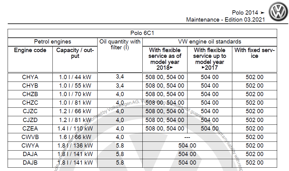

So today the new oil fitted is 0W30 and since 2018 and after it's 0W20 with the new 508 oil requirement.
NOTE: you CAN'T put 0W20 in engine older than 2018.

Polo here is all fixed service interval so 502.
504/507 can do, I know that.
But what I'm getting at is that these VW grades do not cover viscosity of oil, so you can get 0W-30 / 5W-30 / etc for 502, 504, 507 and so on.
For me, it's going to be Ravenol VMP in 5W-30. It's both 504 and 507 approved. I have no need for a 0 weight oil. I'll run on shortened fixed interval. TBN of VMP is lower than my current VST, but should be good over my shorter fixed interval. We will see.
I've seen them testing Mobil 1 oils with the latest Dexos certifications. Those Dexos oils should line up with these newer VW 508, etc. The results were amazing. They can deal with so much more stress and they definitely put down way less deposits in the ring lands. But they are often thinner oils.
I'm amazed they're listing the CJZD as being able to use 508 from 2018 onwards. What changes were done to the CJZD and what vehicle was that in in 2018+?
