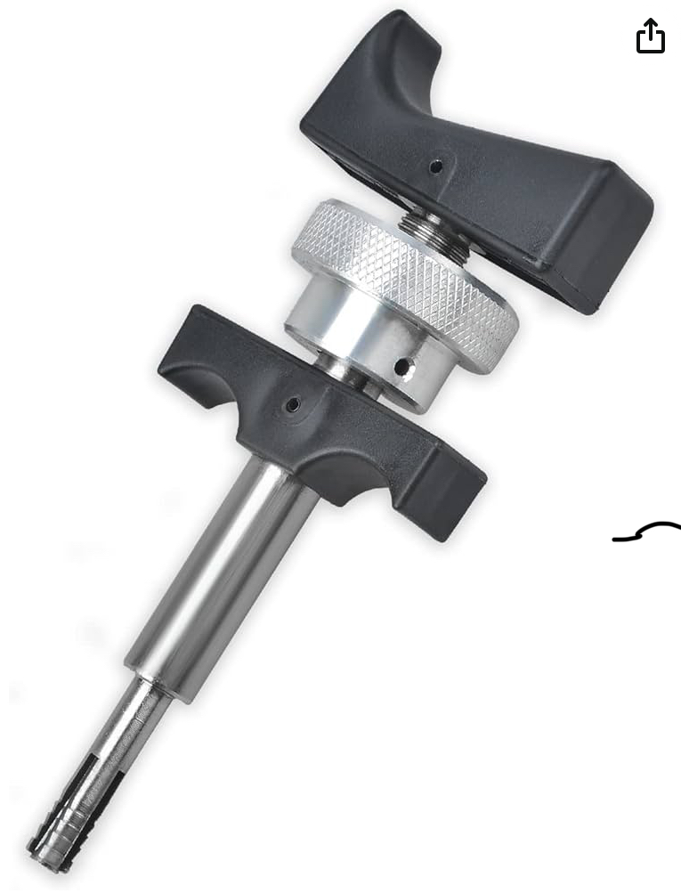

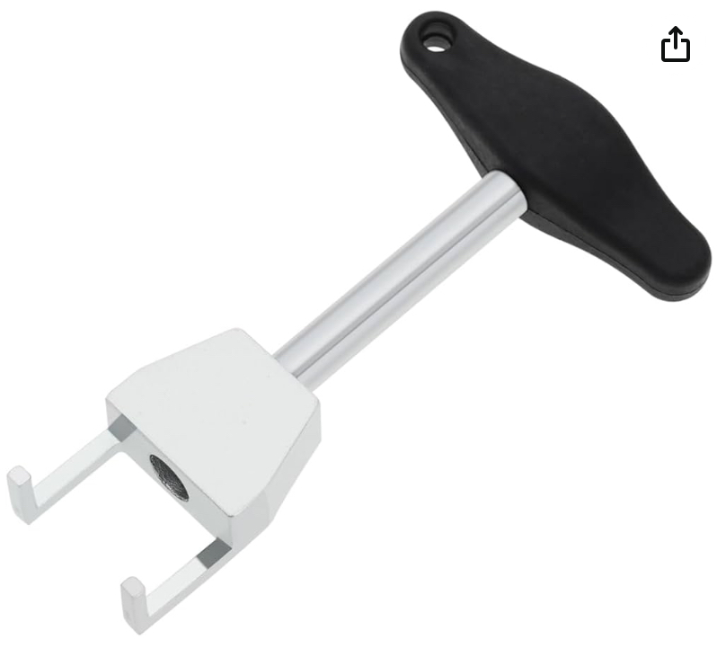

Has anyone had any experience with either of these ignition coil pullers? I’m trying to decide which one to go with.
The latter one seems to apply more even pressure to the ignition coil from two points rather than one.

Regarding coil removal tools, I have both:
- The first is the one indicated for the ignition coils of your engine.
- The second is for 'older' or thinner ignition coils, it will not work for your current engine coils (I used it for our ex-9N3 1.2l and others).

As for the puller; first try pulling the coil by hand. I was also prepping to have a fight on my hands after seeing other experiences online, but to my surprise they lifted out by hand with no effort at all. Well, 3 did without issue, but the 4th one (you will soon know which one) is in an awkward position. Using 2 cable ties slipped under the coil head and then passed through a screwdriver allows you lift it out. There are other tricks for removing stuck coils by using compressed air.
But I do like special single-purpose tools and if that was readily available here I would have picked one up.

I used my coil remover, similar to the first picture, where you grip the coil via the securing bolt hole by expanding the end of that design of tool, on a 2.0TSI EA888, first spark plug for that car, and it worked very well.
