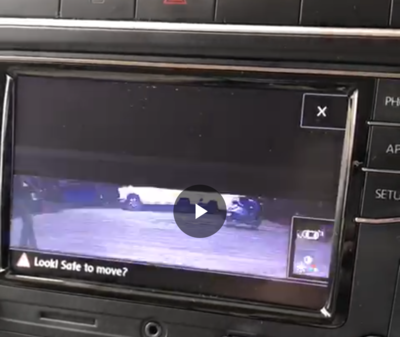

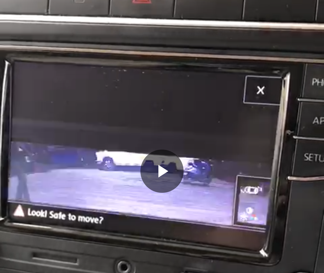

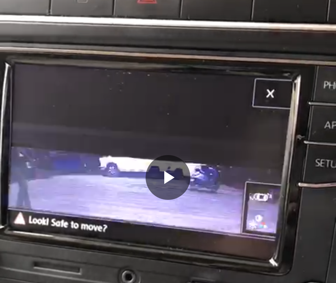

One more weird thing noticed with this coding
3A904BBF48A10000013807006CCB96900080606F60CD39E1210000030020
or
3A904BBF48A10000013807006CCB96900080676F60CD39E1210000030020
Reverse camera used to flicker a lot(attached image) I do not use reverse camera much, I prefer parking sensor with acoustic sound so I never bothered about camera.
But with this new coding
3A904BBF48A10000013807006CCB96900080666F60CD39E1210000030020
camera is not flickering I am not sure how it is related to this. What I noticed just sharing it here.
Posts: 8834
Re: Retrofitting LED headlights & BCM Max Adaptation+Auto Headlight with CH/LH on 2013 6R
Wow! good report! 8) ... it's what I supposed.
Many thanks.
As I told you, it was not a small change. The BCM Byte18 modifies the way it feeds the BCM pins for the lights. Also the diagnosis.
You must bear in mind that this 7E0... C BCM is parameterized for Bixenon headlights, while the headlights you have installed are LED.
We are preparing a good coding for your new 7E0 BCM for LED headlights and rest of devices.
vento2013 wrote: Sat May 19, 2018 3:23 pm now in Byte 18 value is 66
Logically. Image
