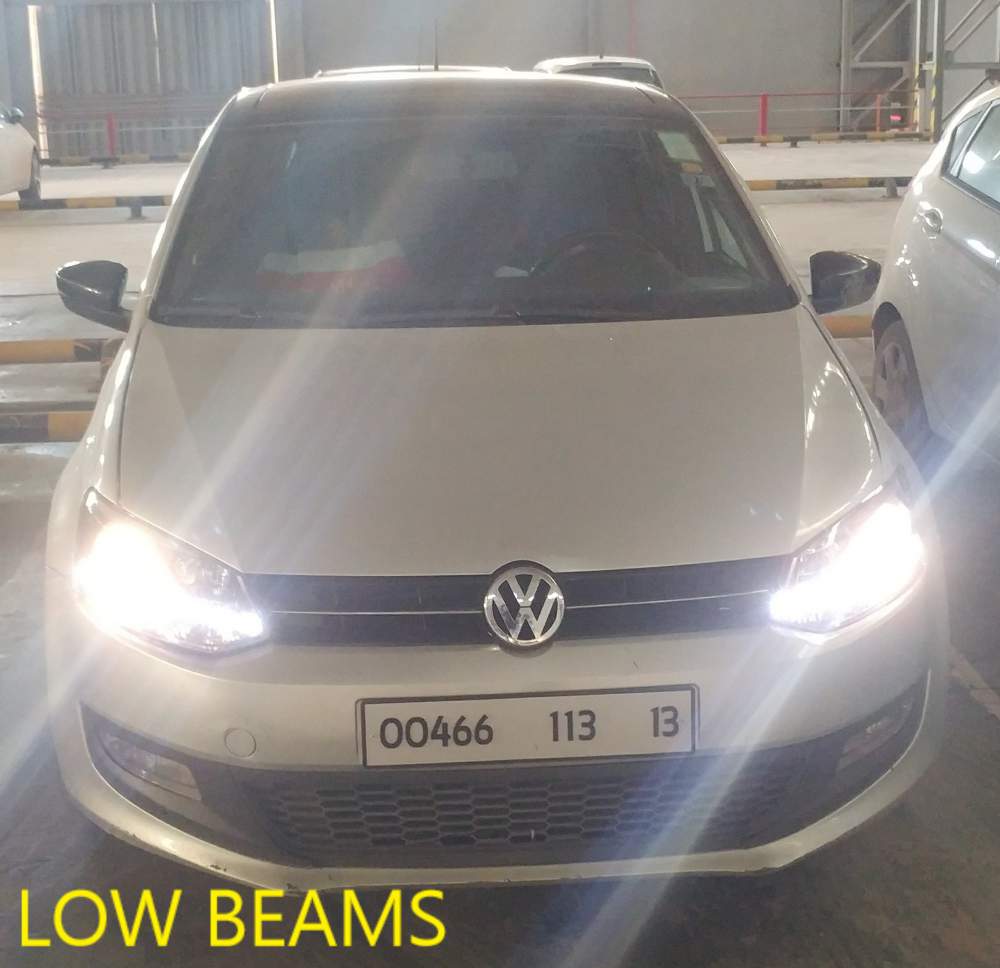

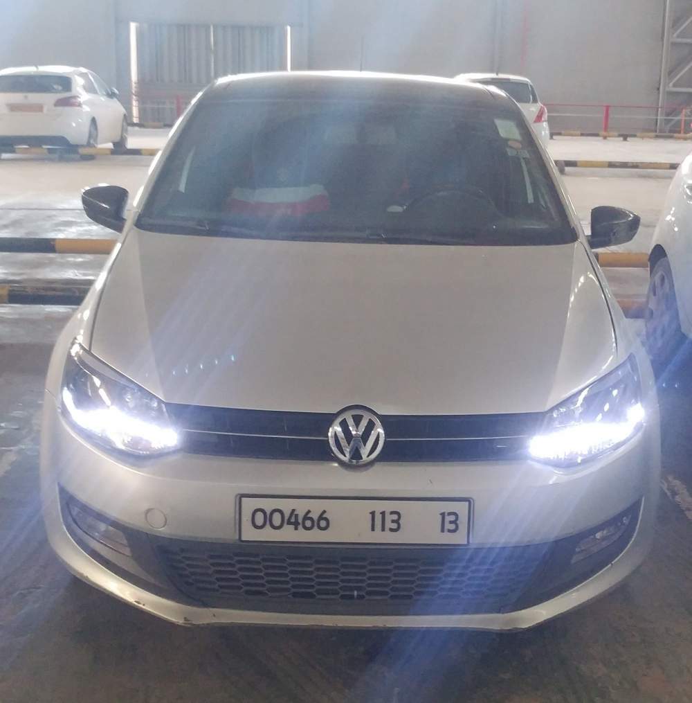

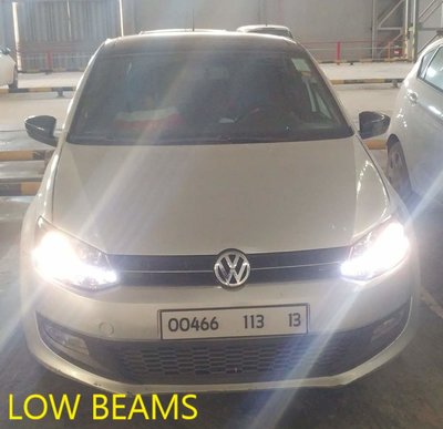

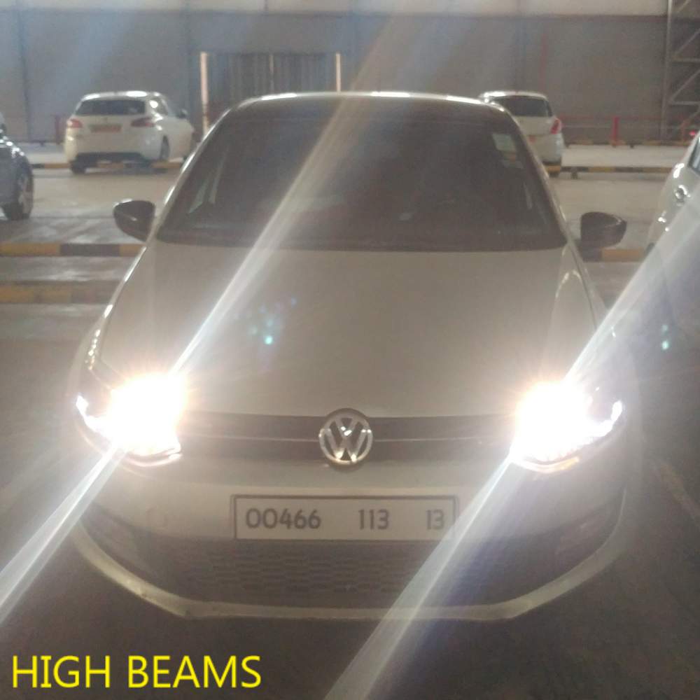

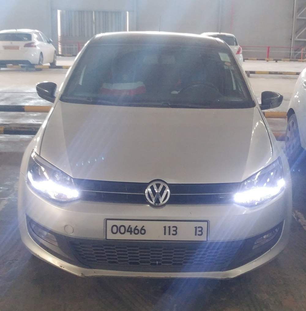

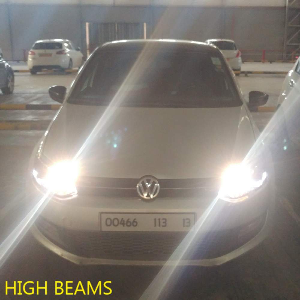

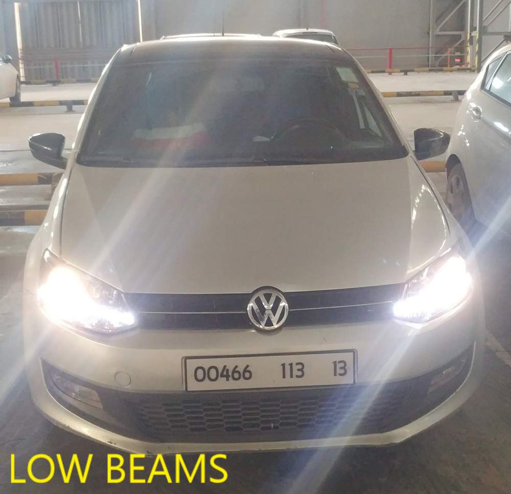

I have a Polo 6R 2013, I wanted to upgrade the headlight assembly for sometime now,
I have finally got an assembly from https://www.sw-tuning.de/en/SW-Light-he ... 42210.html
The new assembly came with 02 Lamps (H1/H7) instead of the OEM Dual beam H4,
After installation, everything worked fine, apart from High beam flashing which is not working ..any ideas?
Thanks!

Re: Headlight upgrade H4 Xenon >> Dual H1/H7
Thanks a lot iichel I will test that now!
- Posts: 8998
Hello doubelus, welcome.
More info here
viewtopic.php?t=68139#p508917
It consists of adding a single wire from the light switch connector to the J331 relay, removing and isolating the existing one there.
