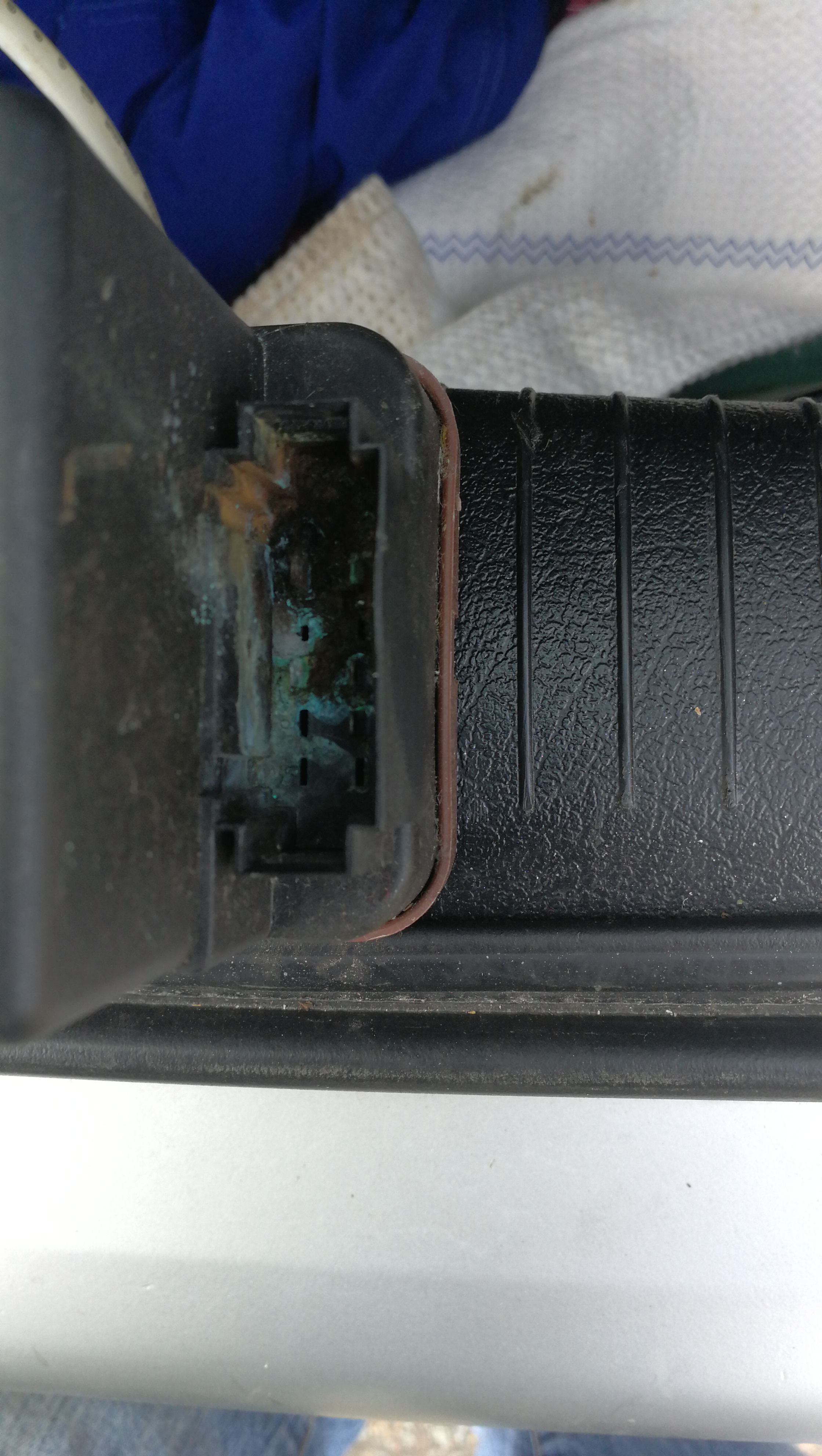

Just got hold of a 99 1.4 open air auto polo and when I went to see it the central locking wouldnt work down to the pump being fired from water and it came with a new pump but I think it is from a 6n2 I'm looking to wire it up does anyone have the wiring diagram for the 6n and then 6n2 pump connector as I can not find it on auto data

Post by LilLew »
The attachment IMG-20180423-WA0031.jpeg is no longer available
Pump end
Pump end
Pump board
Pump board
Otherside
Otherside
Original connector
Original connector

It should be the same plug, however, what exact part number has that pump got?
Alot of the time, unless the identical part number is used against what was originally fitted, the pump will not function correctly.

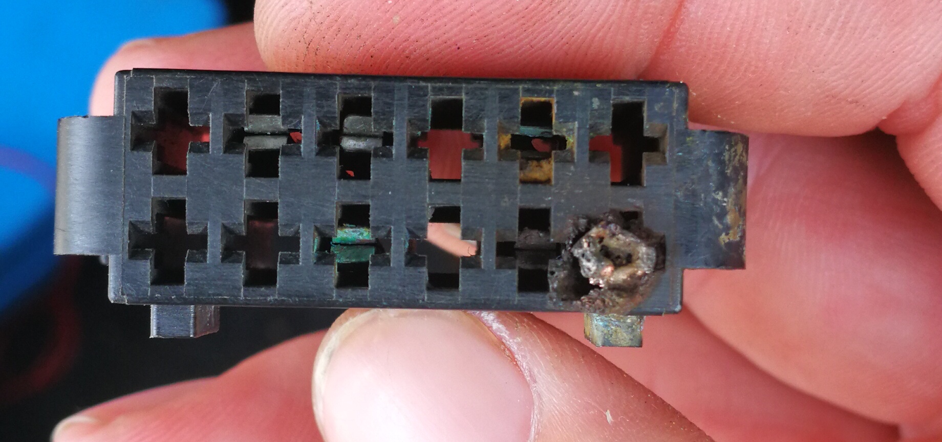

I will look for the part number the new one has the plug aswell but on the old connector there are 6 or 7 wires in total and the new one there is a few more maybe 10

Old connector
Old connector
old one
New one
New one
new one

Ok, the original is a mk3 golf cabriolet one. Youll want to get another of those as this 6n2 one wont work in your car, as this pump cannot be modified to work.
Ill check the pin differences later on
