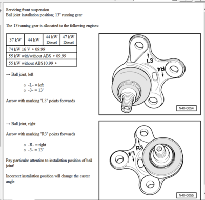

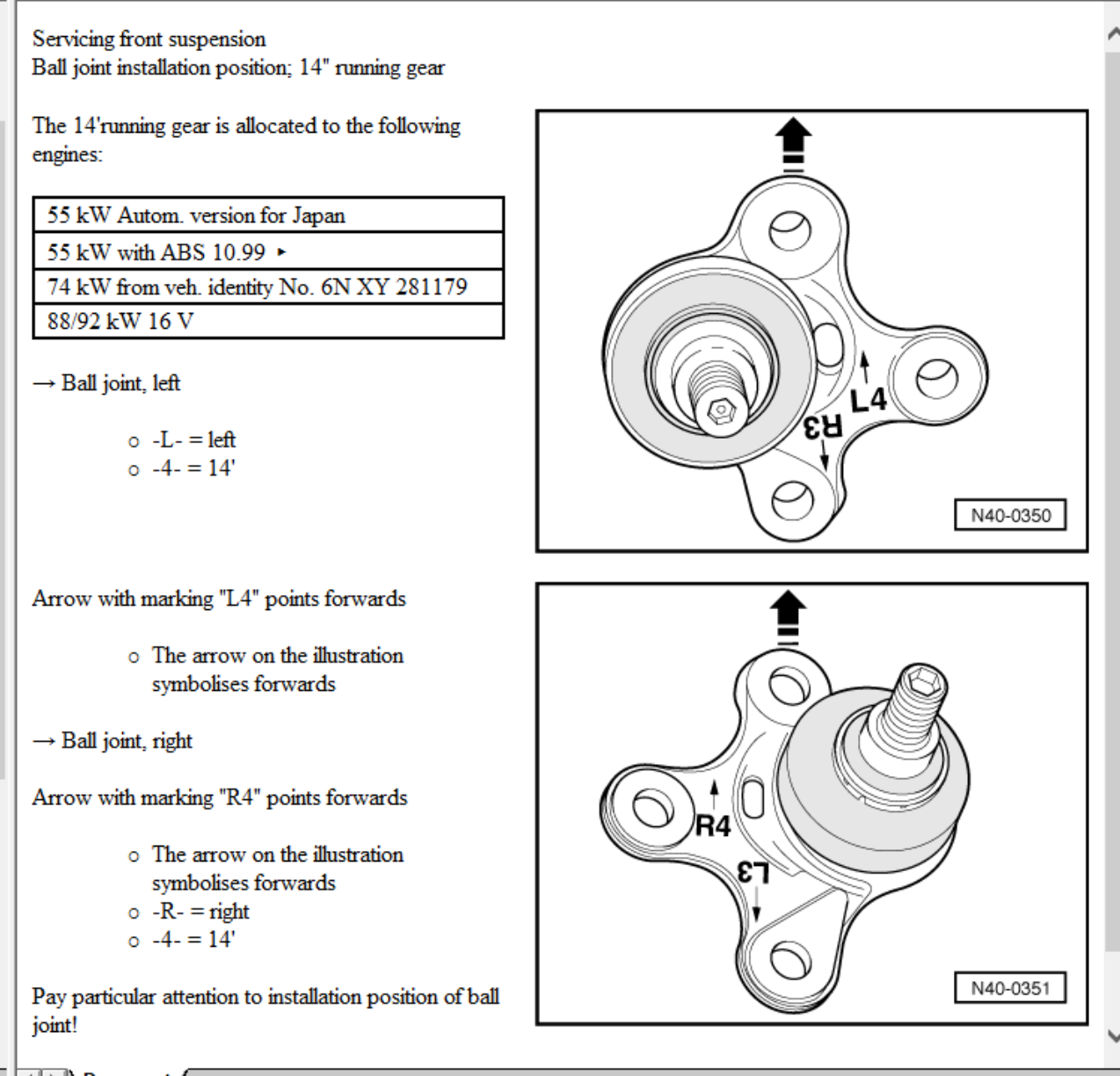

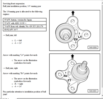

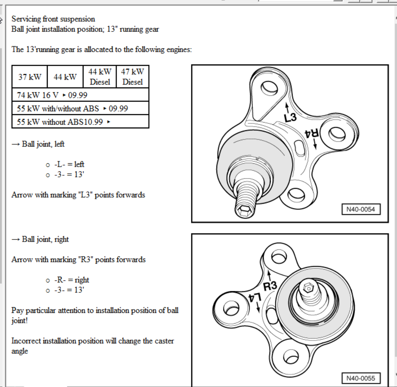

Ok, refreshed my memory on this. Same part number for all models
However, on 14" and greater wheels (16vs and GTIs), the right and left ball joints are swapped over
13" instructions - see the markings
14" and greater - see the markings

Ok so does that mean I just need to put the left on the right and the right on the left? Thanks for your help by the way
alexperkins
Site Admin
Posts: 14874
Location: Poole, Dorset, UK.
Re: Odd front wheels haha
Post by alexperkins »
Yes. The markings should match up with the balljoints. They normally cast reproductions like the originals.
