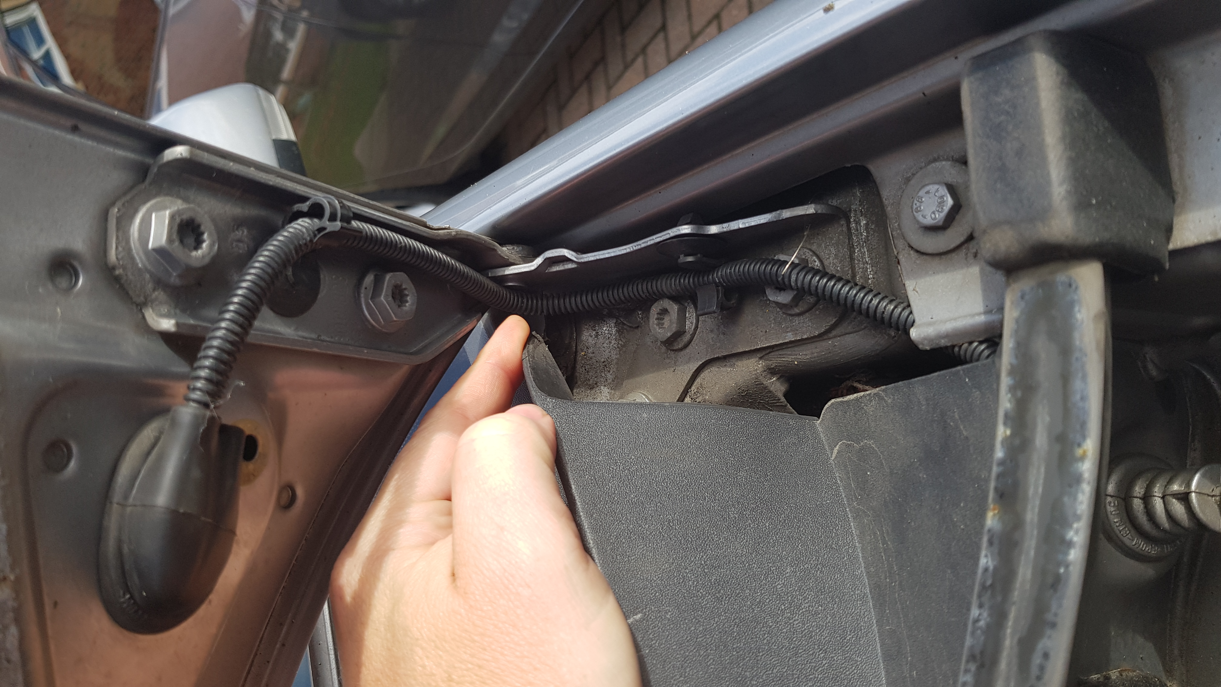

Hello everyone,
I recently acquired a second hand Polo from a friend of a friend, and largely, it's absolutely fine, but I've only just noticed (since I haven't needed it until now), that the Front Windscreen screenwash hose has a leak at the exact point where it comes up from the engine bay, onto the bonnet lid and is bent into a u-shape.
I was trying to clear the windscreen yesterday, and saw all the screenwash flying out of the gap between the wing, and the bonnet lid.
I've had a look, and it looks like a right pig to get the hose out from the bonnet lid, so I just wondered whether anyone in here has had to do anything similar, or whether there is a reasonably easy fix.
Appreciate your advice!
Kristian

The hose is actually quite easy to remove, ive done it myself
Equally, its fixable too. Can you post a photo up of where its split?

Thanks for responding.
Should be a photo attached.

Pick up one of these kits
https://www.ebay.co.uk/itm/Genuine-Skod ... %7Ciid%3A1
You can see how it fits here - https://www.drive2.com/l/507750347612094741/ easy task :)
Ill try find the english version of that document for you

https://www.youtube.com/watch?v=lbywVYU ... r_embedded Video to show how it all assembles
Cut the split section out, then join the two pipes back together with the kit

Alex Perkins, you're a star. Ordered one, and fixed it without too. Much trouble.
Really appreciate it!
