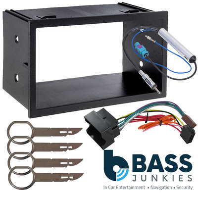

So people where is best place to get one of thease kits from ( i presume its the thing i need to fit a double din stereo in our 9N3 )
Thanks Tim
VW VOLKSWAGEN Car Stereo Double Din Fascia Panel & Fitting Kit
These adaptors will convert the non din-sized aperture left after removing the factory stereo to a Double din size ready for head unit installation. The high quality finish colour and texture are designed specifically to maintain the original look of your vehicles interior.
Kit comes complete with Facia panel, ISO adaptor lead and booster aerial adapto
Package Includes:
VW Facia Panel Adaptor (Double Din Facia)
Wiring Harness Adaptor Lead
ISO Aerial Adaptor
Removal keys
This kit allows fitment in the following vehicle:
Volkswagen Polo MK3 Facelift 1999–2002
Volkswagen Polo MK4 MKIV 2002–2006
Volkswagen Polo MK4 MKIV Facelift 2006–2009
Kit compatable with vehicles fitted with the following head unit :
RCD 200 MP3
alexperkins
Site Admin
Posts: 14874
Location: Poole, Dorset, UK.
Re: double din install kit for 6n3 ( is it correct ? )
Post by alexperkins »
Whilst you can use a fitting kit like that, you dont actually need the fascia. The hole is a standard double din and a double din cage will fit in no problem
The fascia allows you to screw the radio into it for a flusher finish, though it makes fitting it alot harder so I wouldnt go down that route.

i understood that there the hole isnt a proper double din , do i need the cables in the kit
alexperkins
Site Admin
Posts: 14874
Yes you’ll need the quad lock to iso and the fakra aerial adapter plus the removal keys
