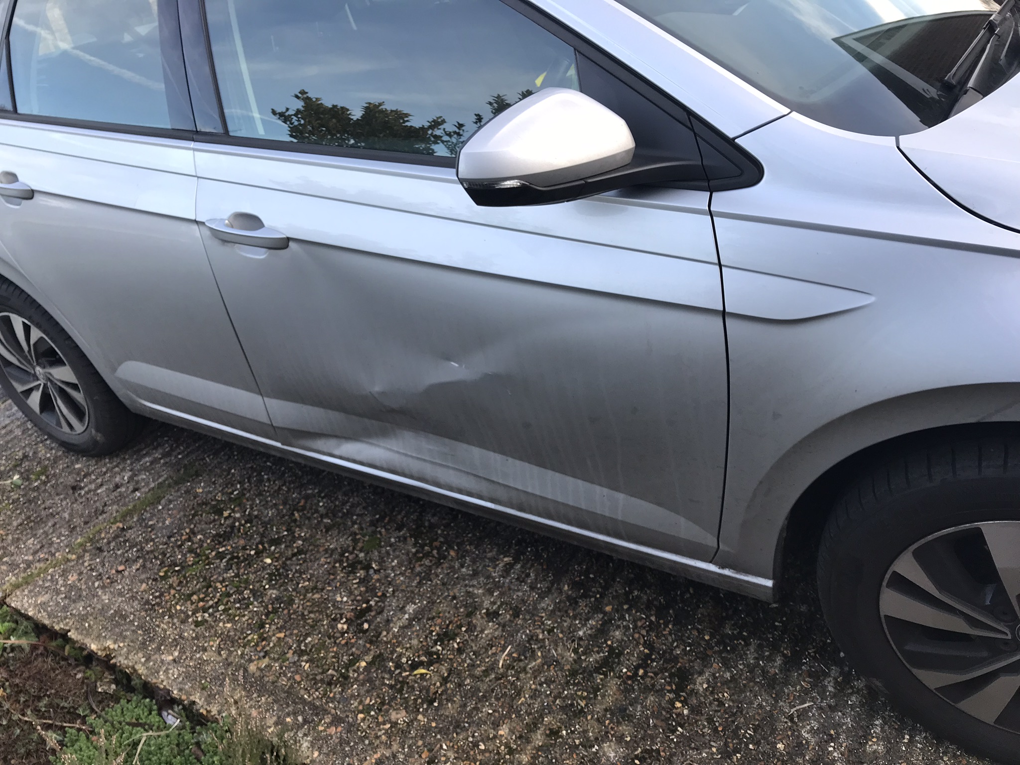

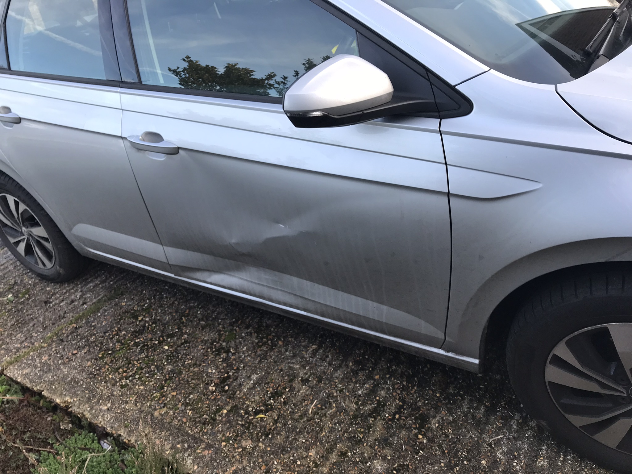

The damage:
Unfortunately the sill is dented, a door would be an easy replacement, I guess the sill means breaking open spot welds to replace it. Or perhaps they have methods to remove the kink from the sill, as you only notice it if you are looking closely.

It might not be necessary to replace the sill panel - some body shops might use a method similar to the glue pulling method that some PDR guys use when it’s not possible to gain access to the rear of the panel, like in this YouTube video;
https://m.youtube.com/watch?v=c9AgEkiTpm8
I had someone put a parking ding into my rear nearside wheel arch and there was no access to the the rear of the panel for the PDR guy to remove it. He used the glue pulling method and completely removed the ding and I’d defy anyone to find where the ding was.

That was the sort of thing I was thinking of, and I hope the body shop do that, but the cynic says that a panel replacement would create more work and profit. Perhaps the sill is a thicker component, making that technique less useful.

Some repairers (especially repaired nominated by.major insurance groups) work on a fixed contracted repair price, so they will do the cheapest/easiest option to try and make sure that even the complex/expensive jobs have costs minimised. For the sills, you might end up with unkinking what they can and filling in depressions before painting.
Repair companies are not averse to cutting out spot welded sections with an angle grinder and welding in new sections if required (had a rear quarter panel replaced this way).
If they do replace that sill, make sure they apply the underseal to the underside/bottom edges before painting (you can see the rough/ridged artex-like finish coming up from underneath).

Got the car back Friday, lovely repair, but today noticed the wing mirrors were not defrosting. So it's going back to have that fixed. Rang my insurer, and the other party has admitted liability.
