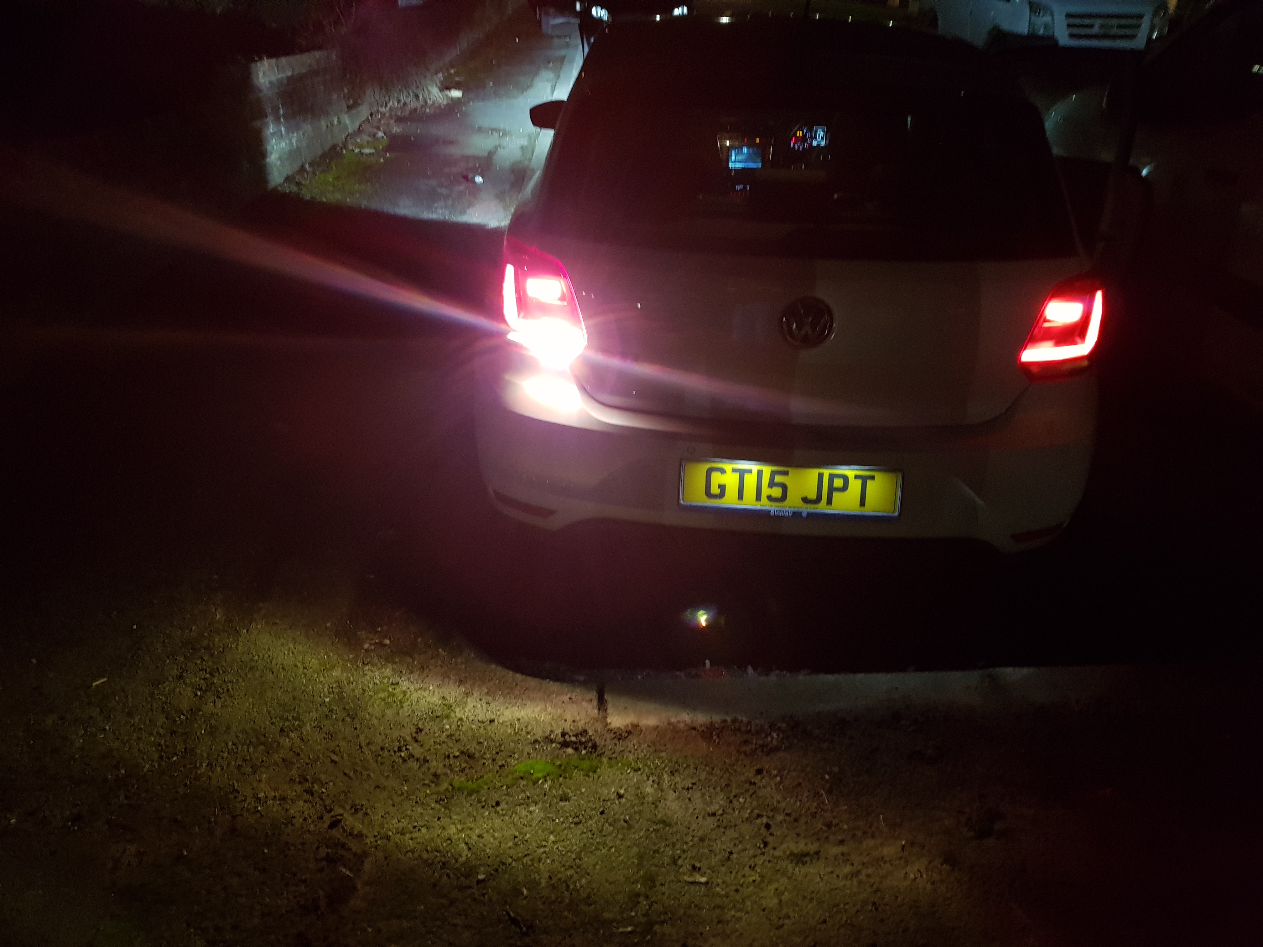

Re: High power halogen reverse bulbs
This is the LED lamp i made. Gives you an idea of how bright (the calculations say around 900lumens) and the colour compared to the led headlights.idriveapolo wrote: Fri Feb 22, 2019 8:39 pm It could help enormously. perhaps you could tell me for how long and what did you modify and is this lamp made to fit inside the current enclosure or wired to a seperate enclosure and you didnt say wether led or halogen/filament bulbs

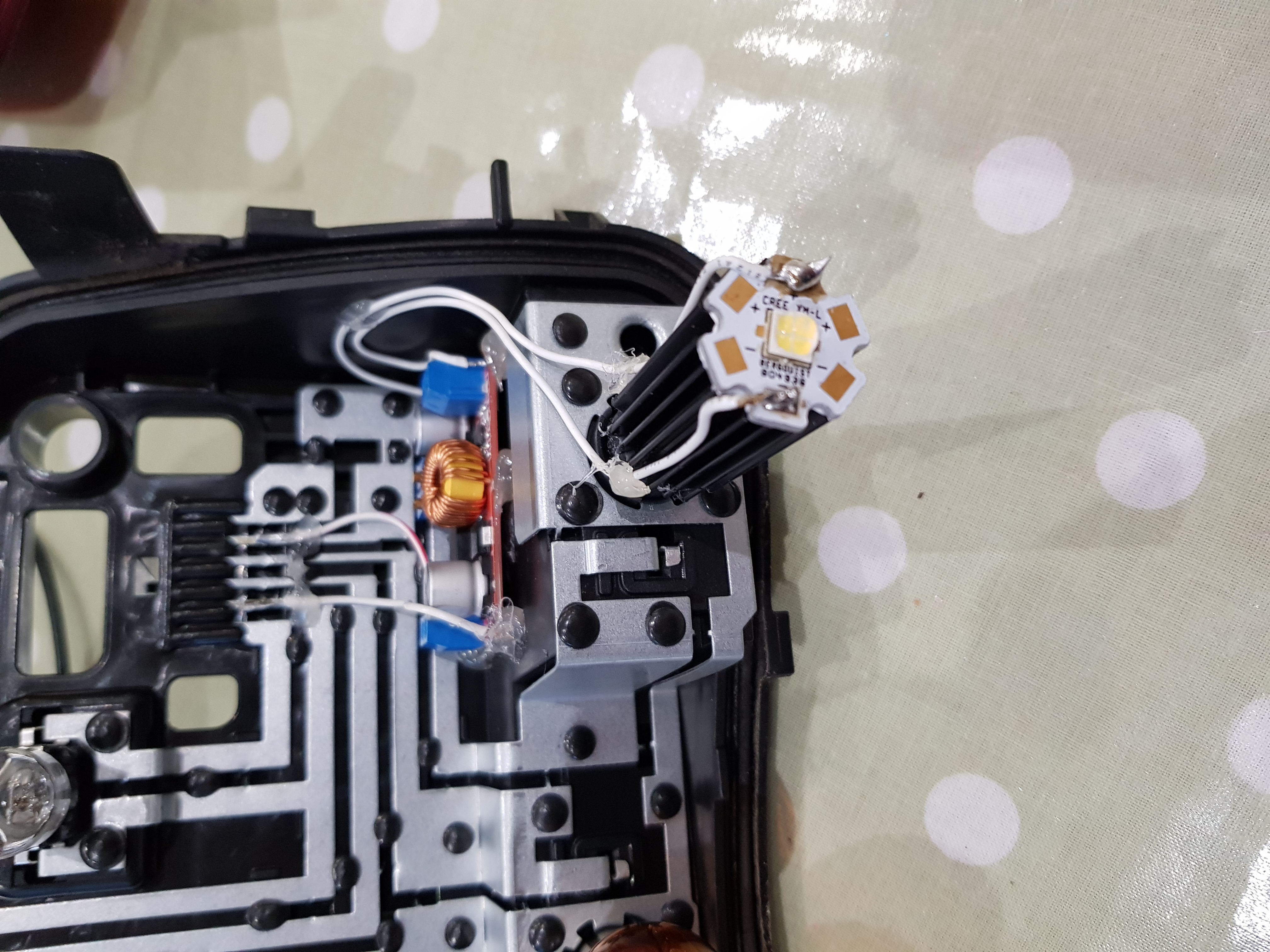

This is what I've made for mine.
It's a dc-dc converter connected to the reverse light supply.
Then 3d printed a ba15s base then epoxy glued a heatsink on top of that.
Then thermo glued the cree led on top of that.
Then set the current to a point where the heatsink starts to get warm after about a minute.
