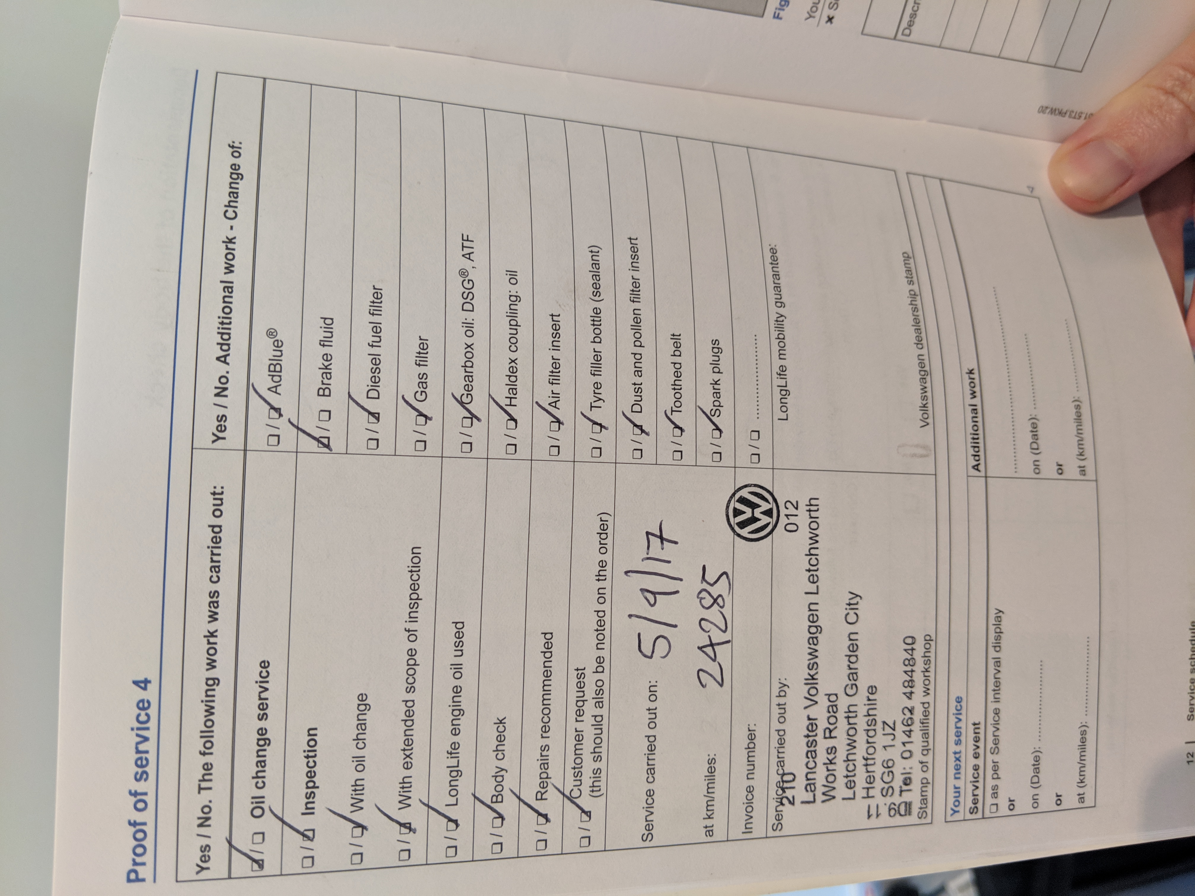

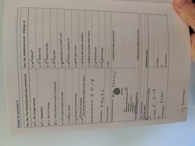

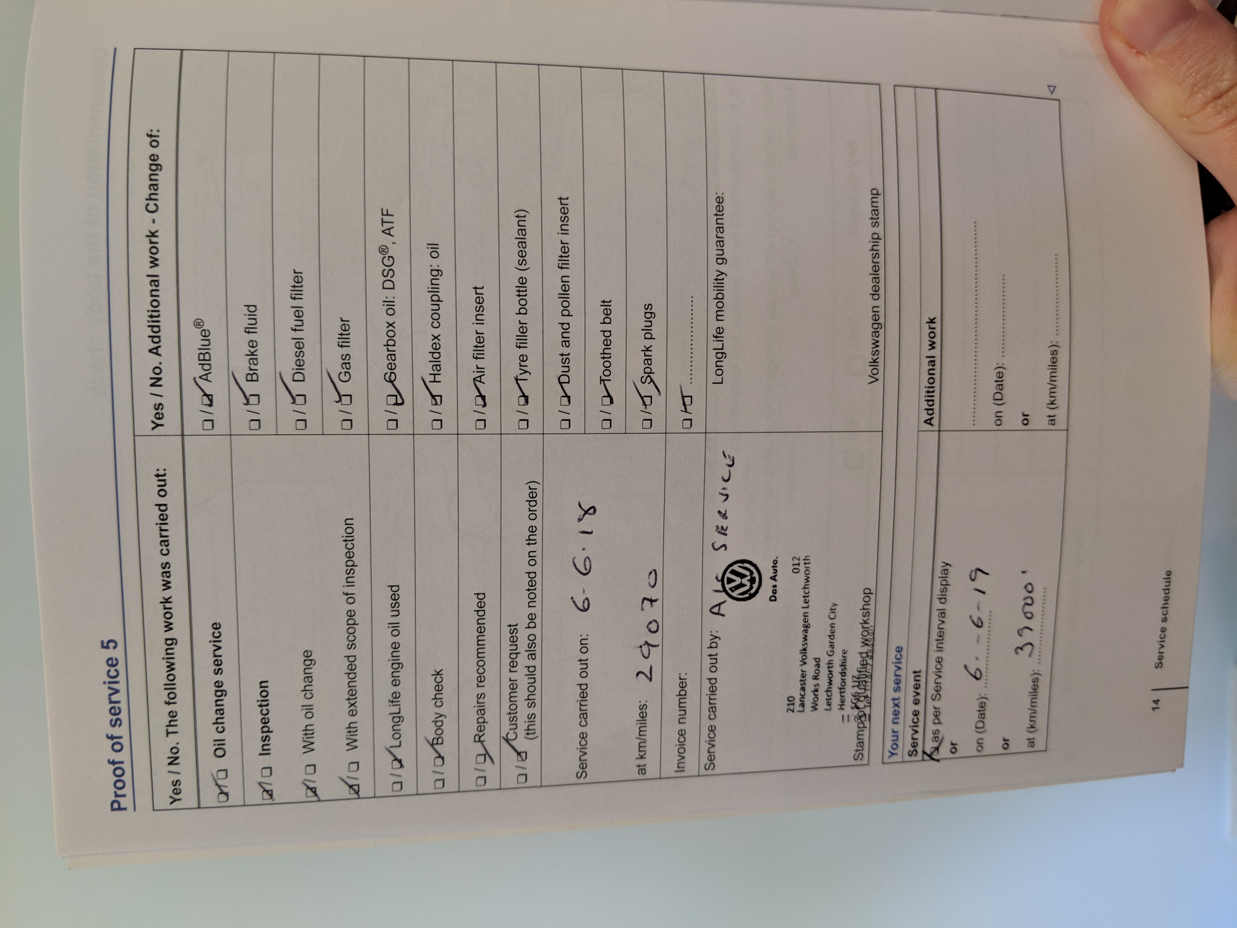

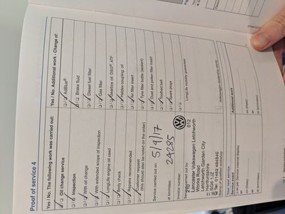

I've attached the last two entries from the service book. Both show an oil change service, but only last year's shows the extended scope.
I think I'll see if I can pop to the garage rather than try over the phone. I'm very confused.

Looking at your pictures, Proof of Service 4 was a minor service - described by VW in the service booklet as an oil change service, and this is what’s been ticked by the dealer as having been carried out. Proof of Service 5 is a major service - described by VW in the service booklet as an Inspection Service, and this is what’s been ticked by the dealer as having been carried out, including an oil change and the extended scope of inspection. The dealer has also ticked that they did an Oil Change Service under Proof os Service 5 - presumably because an oil and filter change forms part of the Inspection Service.
Based on the information completed in your service book by the dealer, I’d say your car’s next service should be a minor one - an Oil Change service - current price £179 at a VW dealer, or if you find an independent who’ll carry out the same service using genuine VW parts / approved VW parts for less, within a 5 mile radius of the dealer, the VW dealer should price match the competitor price;

Something funny has being going on, unless that car had exceeded the 10K in 12 months on one occasion, that car was first reg'd in Sept 2014, so if the annual mileage was always less than 10K, service 1 was due in/by Sep 2015, service 2 was due in/by Sep 2016, service 3 was due in/by Sep 2017, service 4 was due in/by Sep 2018 and its next and minor service 5 due in/by Sep 2019 - so any other explanation for it being the 6th and so claimed to be a major service?
Edit:- I think that what has happened here is that the selling VW dealer has carried out a "point of resale" service as required if it is an approved used VW, and that has messed things up as that next service should have taken place in Sep 2018 - but that would still have been service 4, so find out why that was.

Only one previous owner, but you're correct - I bought the car in June, so they had serviced and MOT'd it prior to sale. There's also one additional service logged in the book, with no ticks in any of the boxes, just a note of "A/C", presumably meaning they just had an A/C service, which is why we're up to entry five instead of four. See below about the independent VW specialist garage.SRGTD wrote: Tue Apr 30, 2019 10:46 pm Depending on the number of owners prior to the OP, the car could have had more than one point of sale services, in addition to the scheduled annual services.
