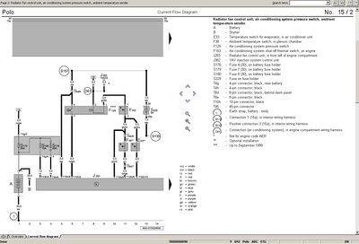

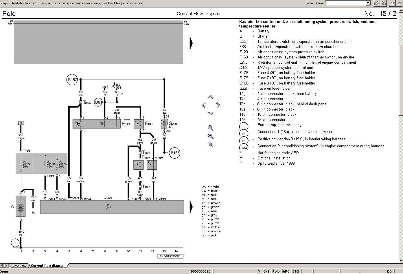

I don't know off the top of my head - but if you are looking at a wiring diagram then that would seem a sensible conclusion (are you sure it isn't 1-3 )

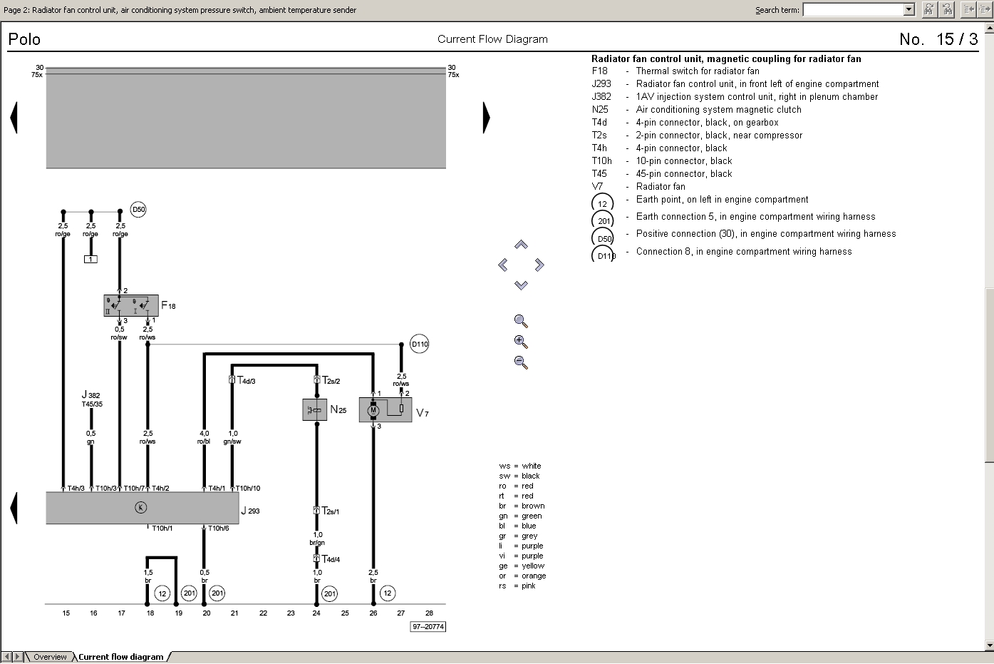

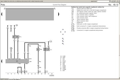

I found a post on Club polo staying what pins do what. It was 1-2 for low speed but I tried all combos just encase. From what I read shorting pin 1-2 should start the fan low speed, this is separate to AC demanding low speed fans.
The post on there also said that it was high speed for water cooling and low speed for AC I think but I will check again, either way low speed doesn’t work.

Regardless of gas levels etc shorting pins 1-2 should turn the fans on low speed, as this by passes all the AC controls.
https://www.clubpolo.co.uk/topic/318109 ... 1557747603
This to me says it’s poss the fan controller box under the battery which is playing up so I will have a look next week I next see the car for a bit. Once I get the fans working on both speeds the AC can be regassed and hopefully that’s sorted.
