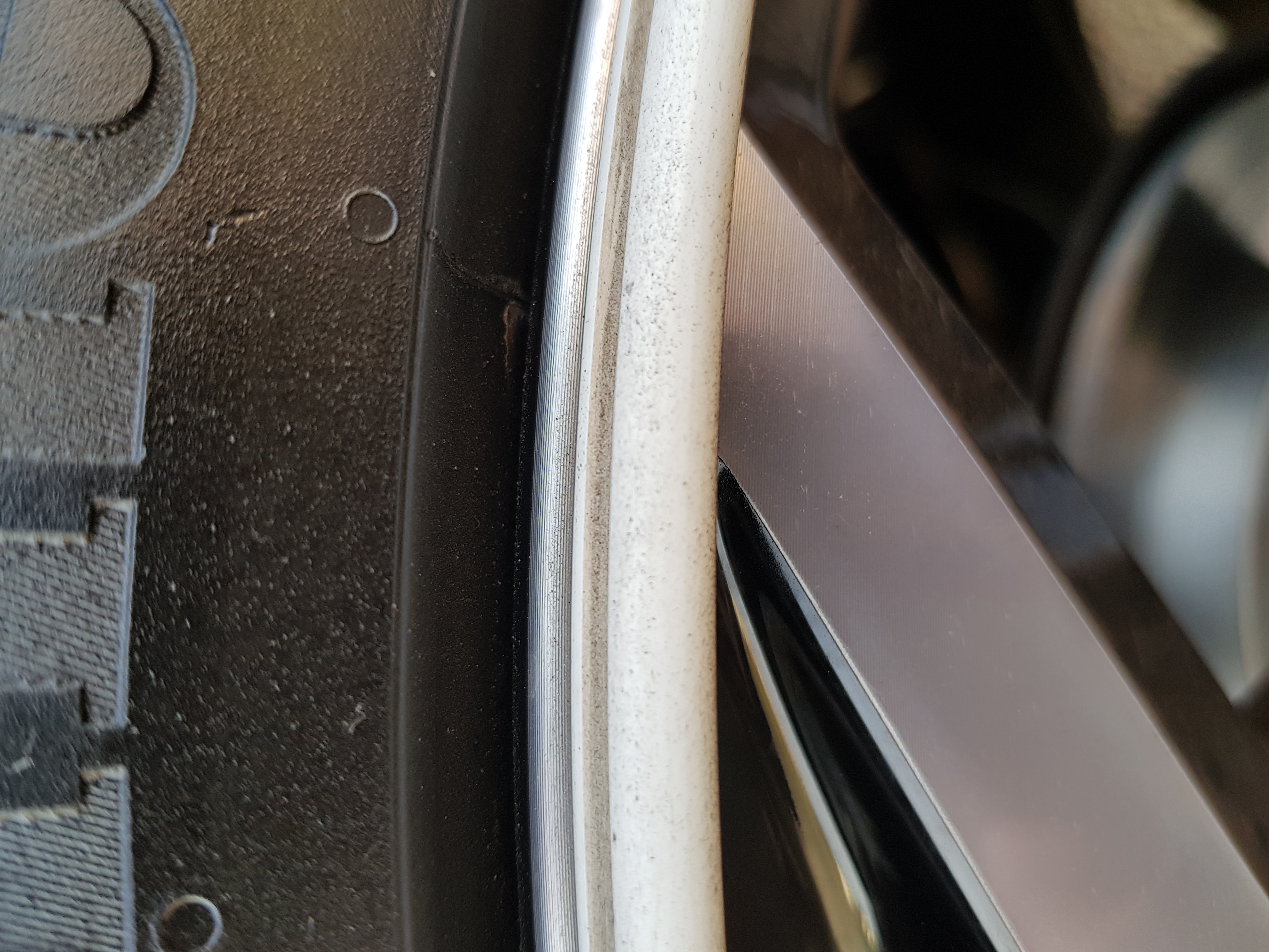

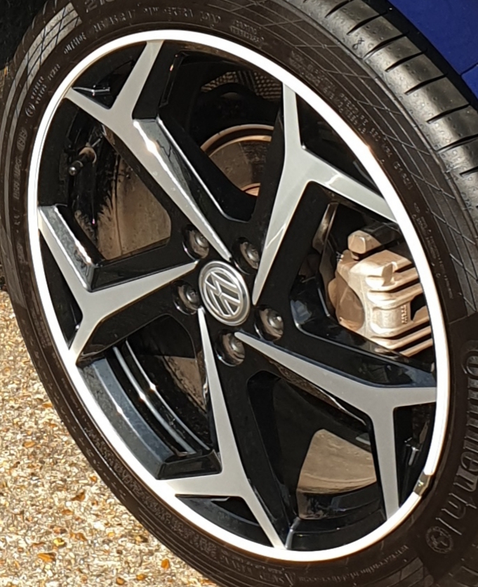

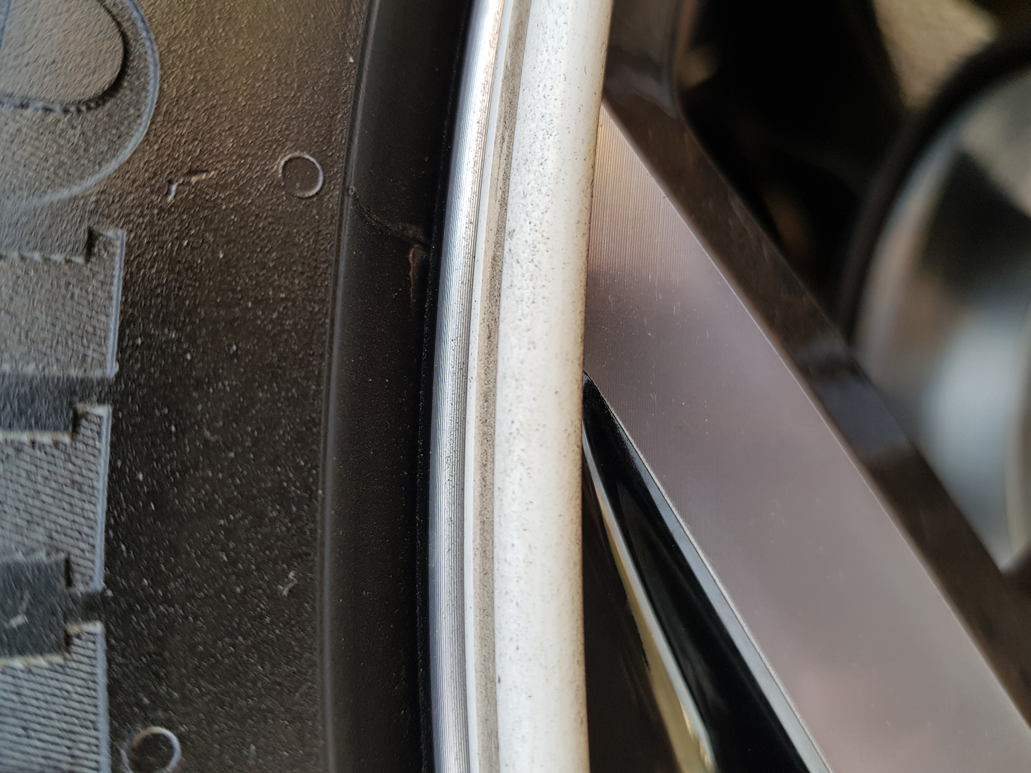

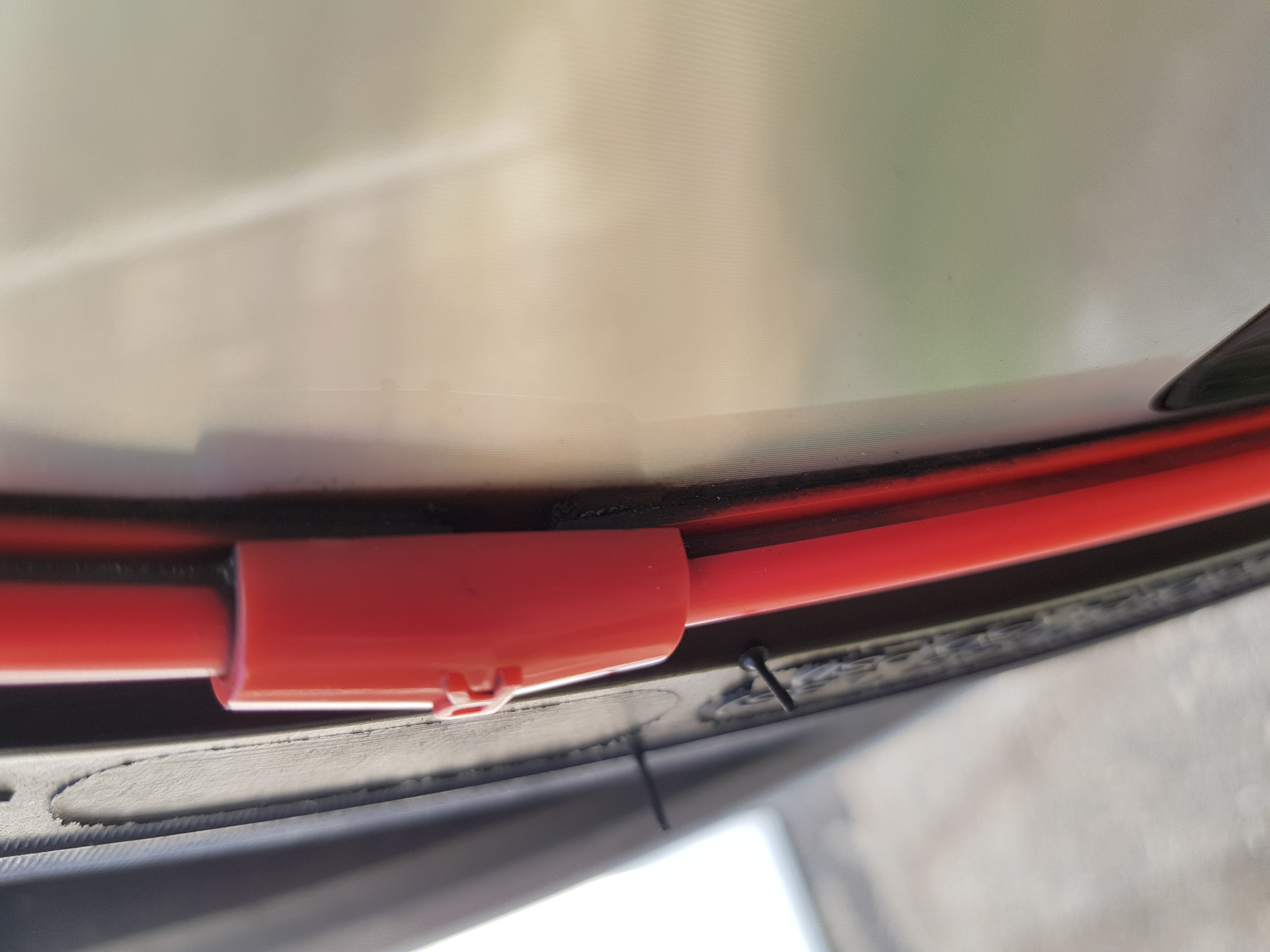

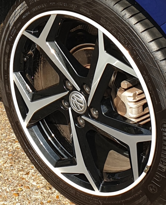

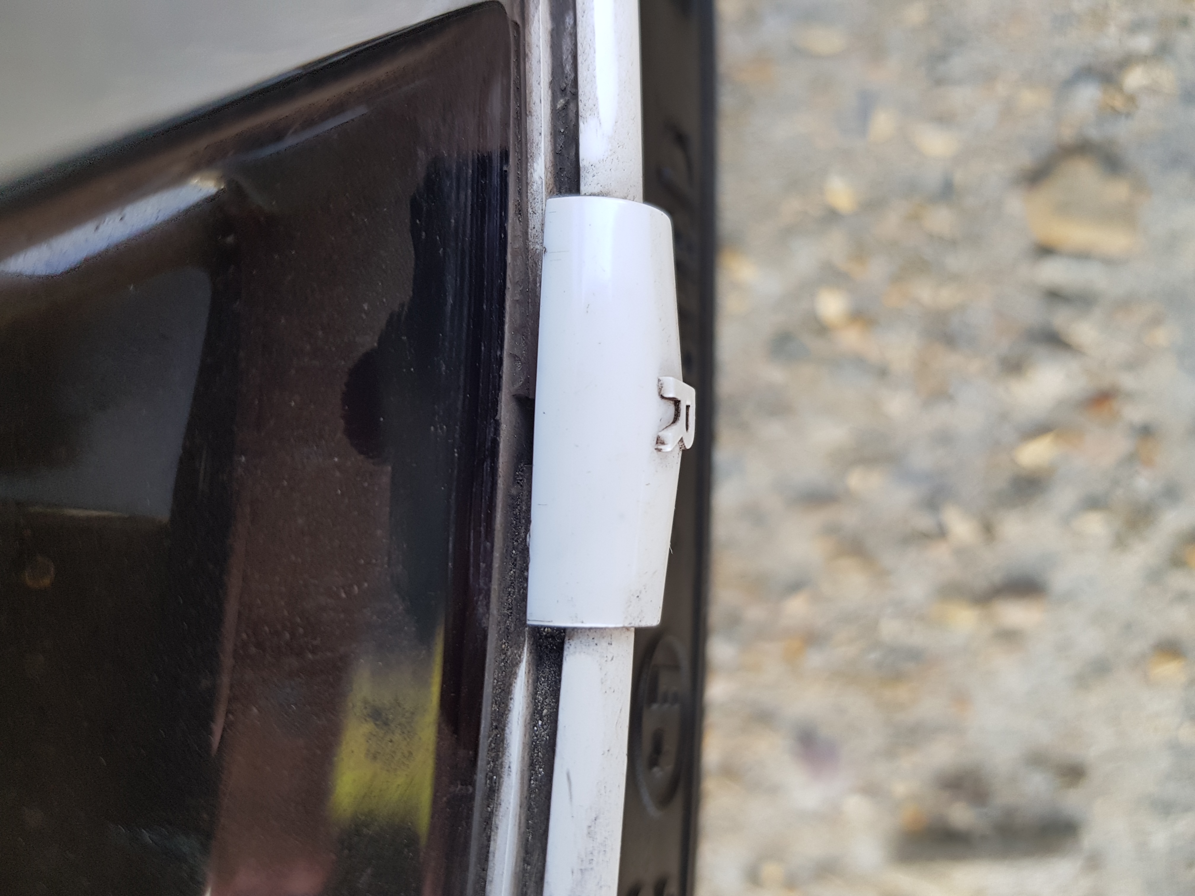

As above, I do have them on both cars, they aren't hammered on, they are 3M double sided tape, maybe confused with Alloygators which most definitely shouldn't be used with diamond cut wheels.
After 6 months on the cars I have one scuff on each rim sadly, they were cause by the car reversing up slightly onto a kerb and then slipping off, so a downward scuff rather than a side on scuff which it's designed for. I have had a couple of sideway scuffs which have not damaged the wheel but you must stop and take the Rimblade off at the first opportunity if possible as the speed of rotation will pull it away and then it whips around and could possibly damage your paintwork like that.
For the damaged ones, I clean up with a stanley knife, tar and glue remover and then bought a roll of 3M tape and reapplied it, so far so good. To get the glue off the alloy it's easy with a rubber wheel (links below) in a drill, you'll be there forever with tar and glue remover!!
The Rimblades Pro that I have are a preformed circle, the cheaper Rimblades are like a rubber with double sided tape but I have seen these applied and they look awful as it's very tricky to get on evenly and round!
Carbon Collective Platinum Wheels is excellent for protecting your wheels too https://www.carboncollective.com/produc ... um-wheels/
I went for white so as not to make the alloy appear smaller on the R-Line, red on the GTi to match the red accents.
