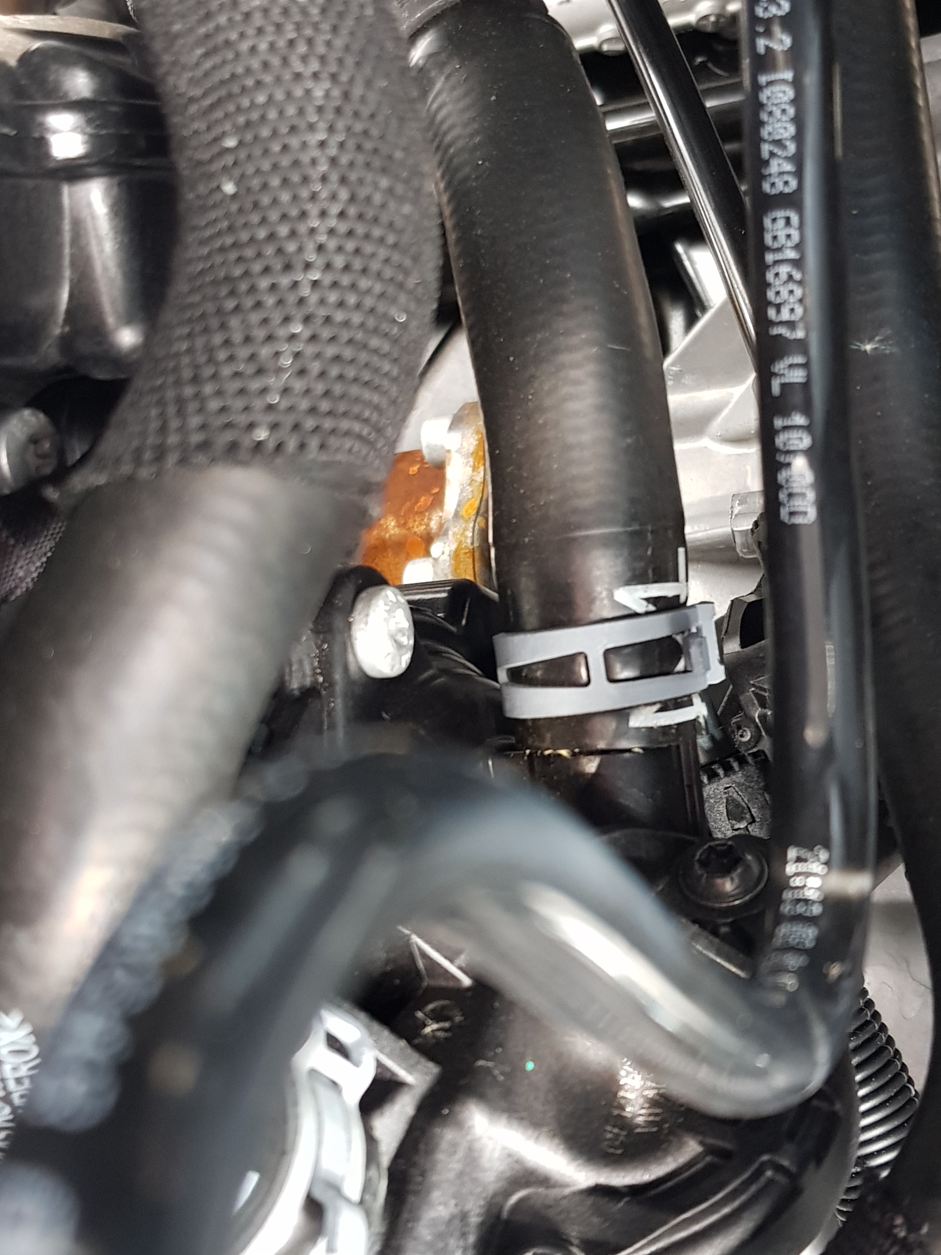

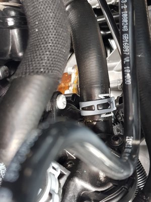

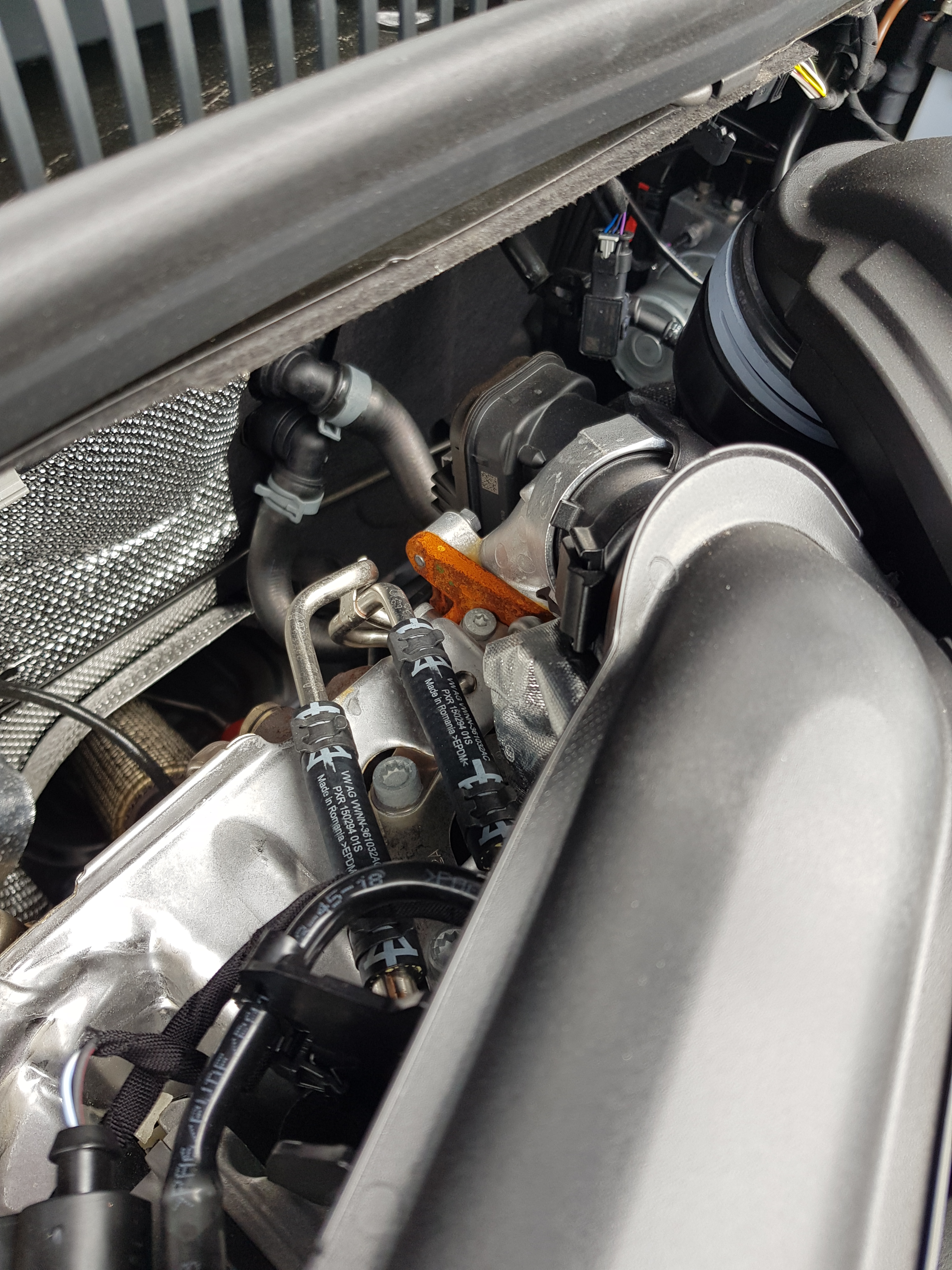

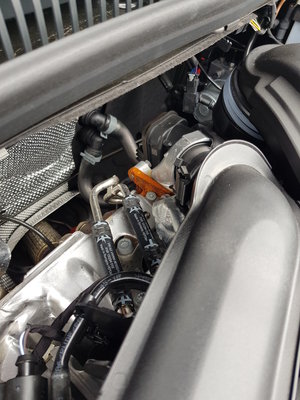

So I've had my car for 2 weeks after waiting 6 months from ordering it and already started to have issues with it.
The car has just done under 500miles and I've had to top of the coolant and noticed the stop-start doesn't work due to High Power Consumption (Even though I have nothing else running apart from the engine)- I do get a battery light coming on when the car isn't running, but that is like 4-5mins afterwards.
When taking a closer inspection of the engine, I've noticed rust in parts. This surely isn't normal for a car that is less 500 miles.
Be good to know what your views are!

I'd say it's perfectly normal. It's only surface rust, nothing to worry about. My car is also very similar, despite now being a year old and 13,000 miles. It certainly hasn't got any worse.

Iron or steel parts will rust. I would have thought you would only get high power consumption with high load on battery. ie aircon, heated rear window on. My Gti engine seems to stop too much even though aircon has been on constant due to hot weather. I don’t think the 2.0tsi has to work very hard in a Polo.

Rust on the iron or steel parts in your pictures isn’t anything to worry about and it isn’t uncommon - as Blackpug has said (unpainted) iron and steel parts will rust. This seems to happen quite a lot on the wheel hubs on the mk7 Golf. If you do an internet search on ‘mk7 Golf rusty wheel hubs’ you’ll see lots of owners have experienced this.

Getting back to the original subject, try and get a small wire brush around the item, then with a small brush coat with waxoil, give it a couple of coats.Mch101 wrote: Fri Jun 07, 2019 2:31 pm So I've had my car for 2 weeks after waiting 6 months from ordering it and already started to have issues with it.

Ouch, I'd be ignoring that advice, that area is part of the turbo charger and they have a habit of getting quite hot!

Let's get this right, that part on your car was also rusting, and you cleaned it up and applied Waxoyl - does the Waxoyl not smell a bit when it burns off?silverhairs wrote: Tue Jun 18, 2019 4:28 pm There's no "ouch" about it. mines OK never had any problem.
- Posts: 2643
Re: 2019 R-Line - Engine Rusting!
The wax will melt and just dribble off - or worst case (but unlikely) ignite and cause an engine bay fire.RUM4MO wrote: Tue Jun 18, 2019 5:56 pmLet's get this right, that part on your car was also rusting, and you cleaned it up and applied Waxoyl - does the Waxoyl not smell a bit when it burns off?silverhairs wrote: Tue Jun 18, 2019 4:28 pm There's no "ouch" about it. mines OK never had any problem.
There's a reason VW (and any other automotive company) don't paint parts that reach 800C - paints either degrade or combust at that temp.

Those parts look like they are cast iron, esp if they are part of the turbo\manifold, which is perfectly normal and nothing to worry about. I wouldn't try and clean them up and put anything on them as they get VERY hot, unless you want to spend a fortune on getting them ceramic coated which is pointless for anything other than a highly tuned race car.
