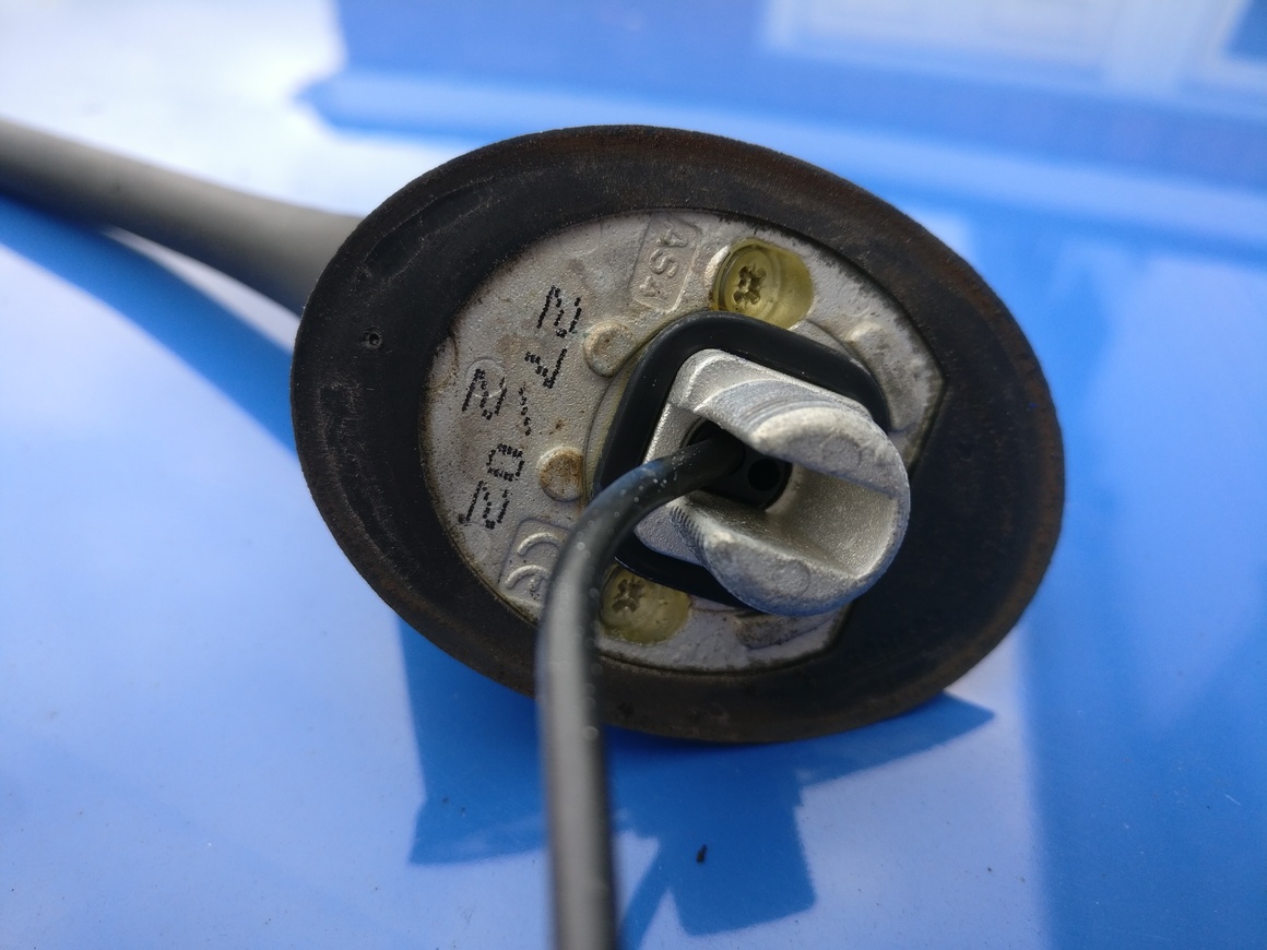

Old antenna.

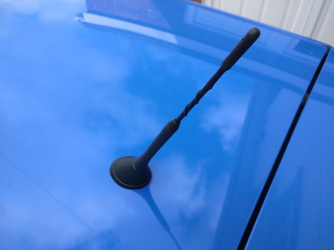

New antenna
It looks very similar but you need to open out the roof aperture to 20mm to clear the plastic mount.

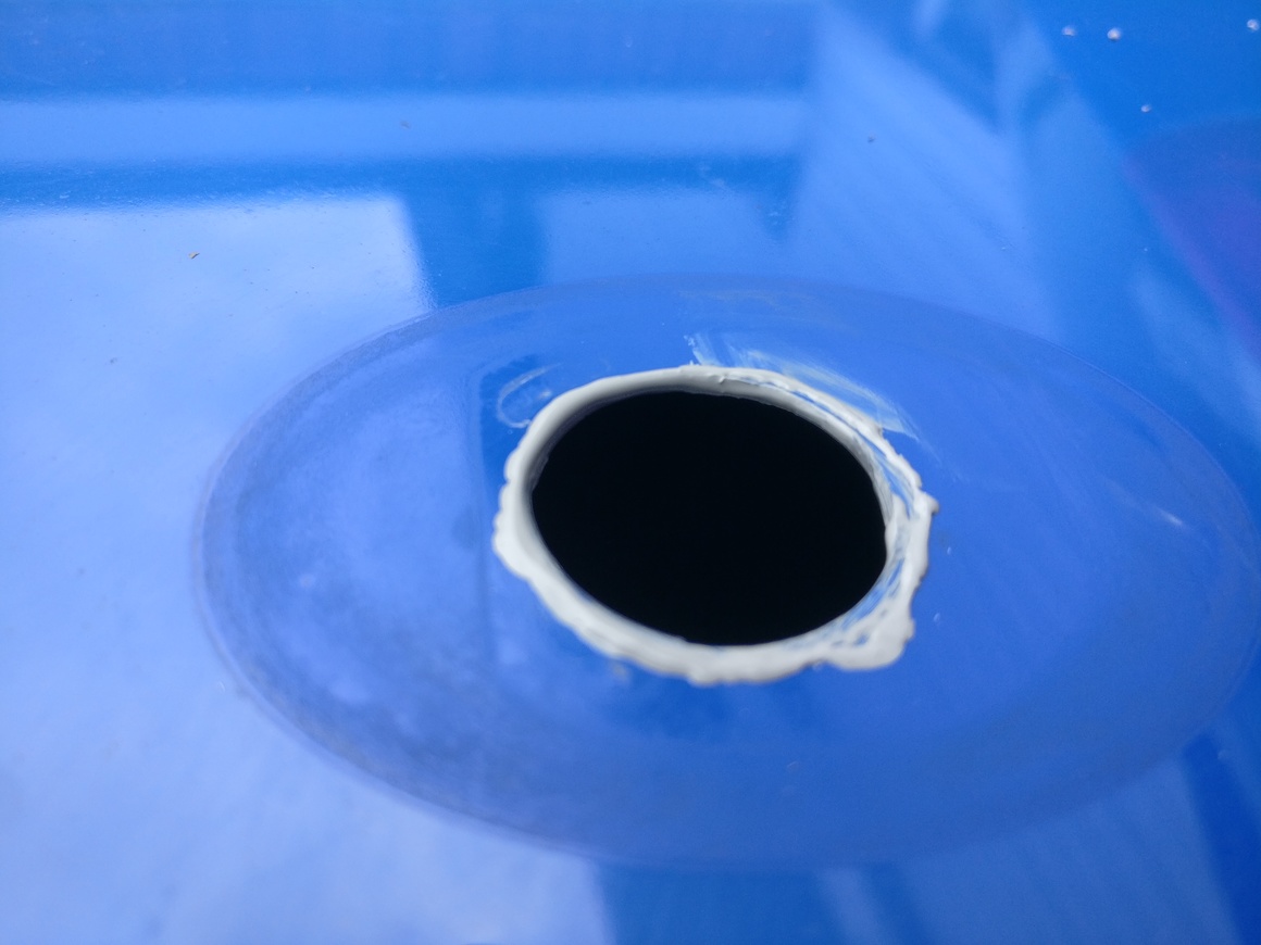

I used a countersink/step drill for this.
Put a cloth under roof and over the headlining if you are bothered to catch the swarf.

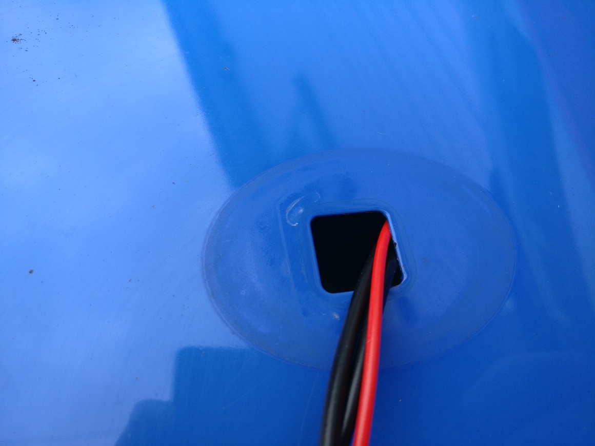

Used some Hammerite primer on the bare metal

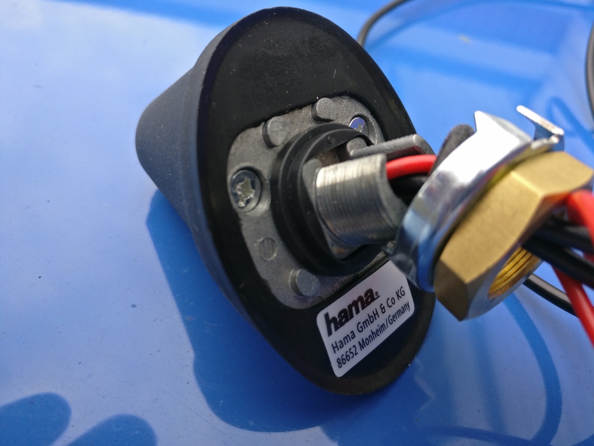

New mount has some cross marks on the top so you can use this to align it north-south.

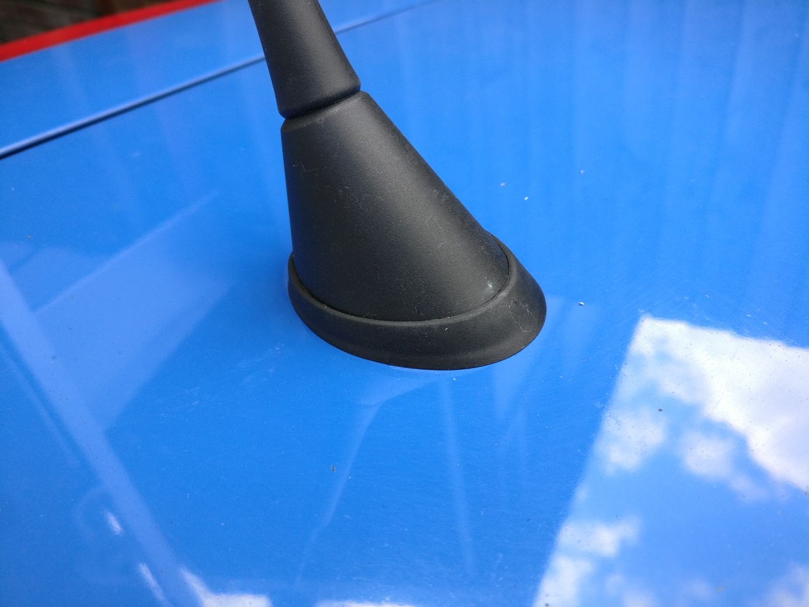

The seal at the roof line seems fine.
A bit shorter than the original antenna.
