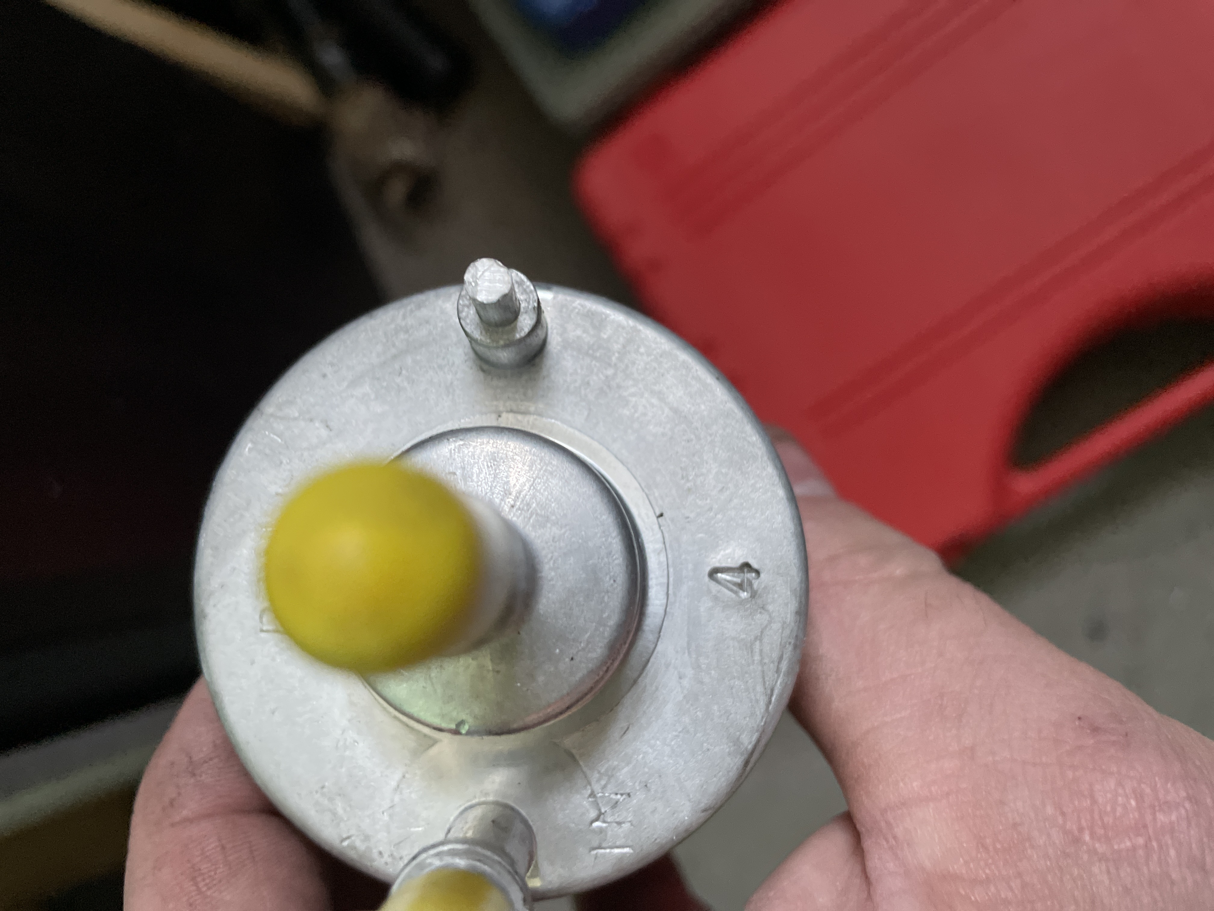

Hi ppl… i know this is a oldish thread but ive jus come across this & i recently like last week had an issue with the fuel pressure & a fault code saying ..fuel pressure regulator”A” performance . So i checked it out on google & i was seeing all kinds of possible reasons for why i was seeing this error fault code, it got me quite worried as some of the issues i was reading were going to be a costly repair , So for two days i was using more fuel than normal & i couldnt for the life of me figure out why !? Now prior to this issue i done a fuel filter service & put a new bosch fuel filter on the car which was needed & thought all would be fine as its just a filter renewal but NO i was wrong !
I got the filter off ebay from a reputable car parts seller i wont mention the company name “but i wont be using them again “!, not so professional tbh, anyway the advert for the part stated that the filter was a direct replacement & fits my car “even down to the engine code “ so i brought it & fitted it to the car as stated .

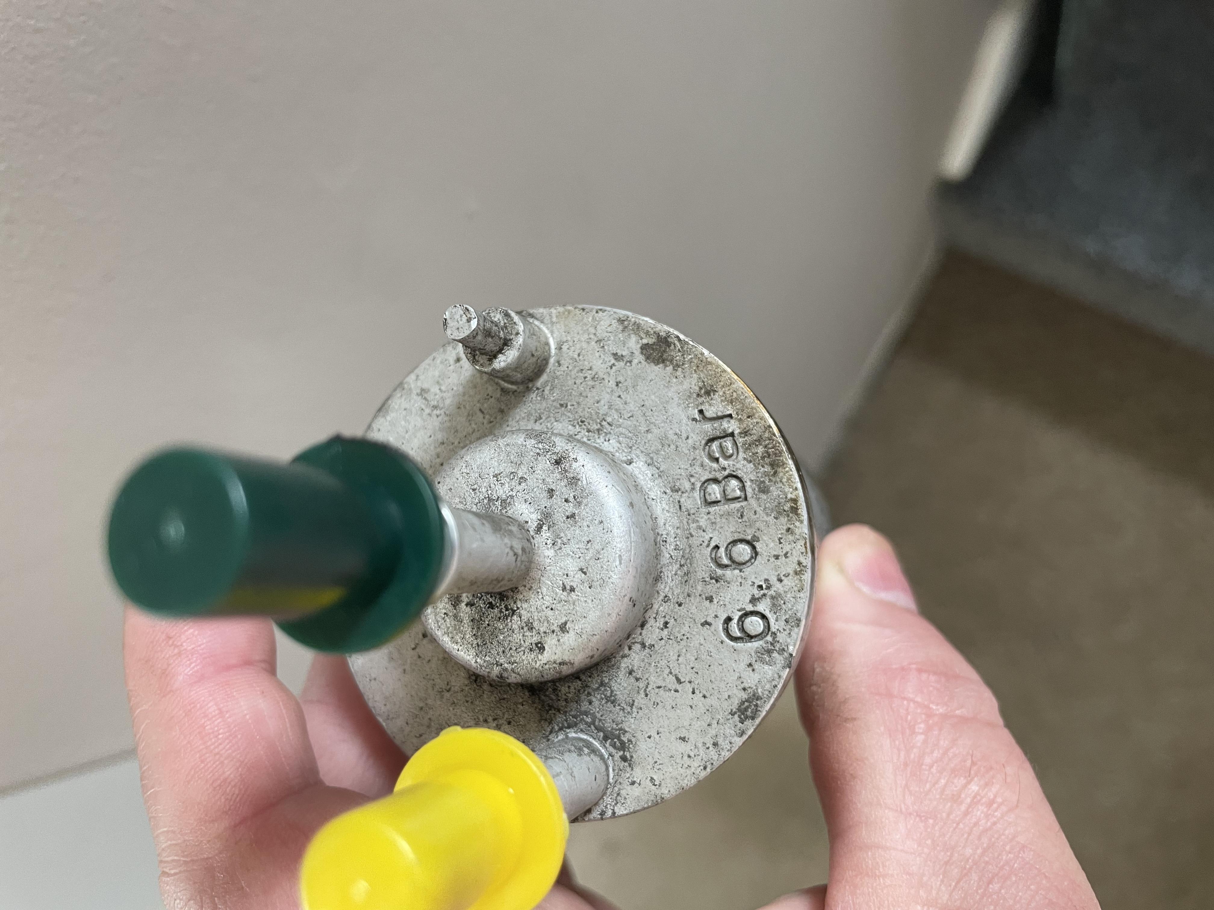

Right so with these newer cars most parts have to be specific or the ecu wont recognise it & throw codes about causing issues which in my case this happened as the filters for these cars have different pressure bars for the fuel system actually in the filter !! I didnt know this & the filter they sent me was a 4bar thus messed with the pressure flow to the injectors ! I then only found out via google about this lol my polo takes a 6.6bar filter & it is stamped on the actual filter , i put the old filter back on the car & the code went & no more issues & a load off my mind .
Well after all that i purchaced another filter “the correct one” & fitted it & alls good thank goodness
the info could be valuable to someone not in the know lol i havnt been interactive enough in this forum so i was unable to create my own thread about this issue but this thread is relevant so sortov piggybacked sorry . So if any1 has had or has this issue when replacing a filter please check your filter pressure bar stamp on filter, i thought i had messed something up on the car by maybe not priming the fuel pump after changing the filter but i did prime it ,
