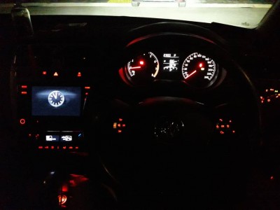

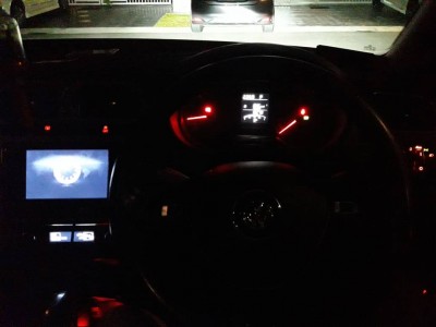

Below photo are when auto mode, no instrument cluster and steering light. Manual mode is normal. Also, now when I code it as 0728DD, it says coding accepted, but when open again, it's still the original code, is there anything wrong with my rls? Please help

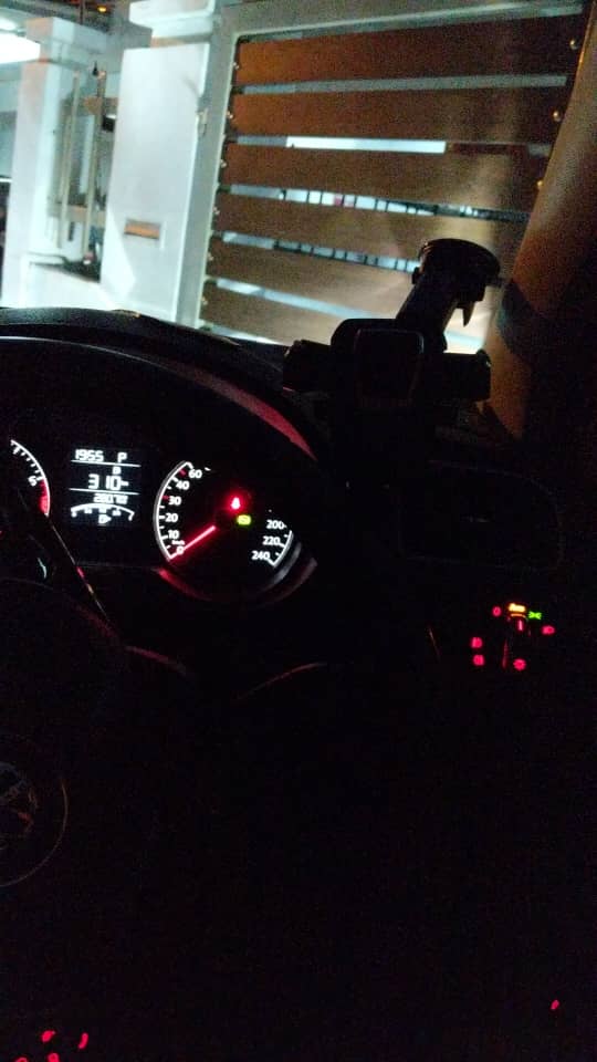

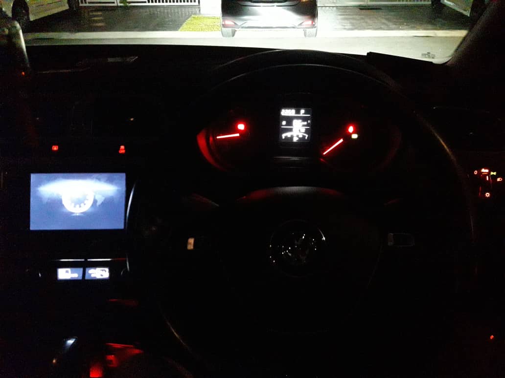

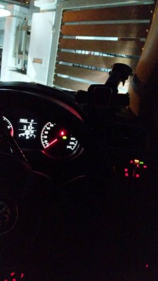

Hi, seeking help on my installed RLS, 5K7 955 559B. I have installed the RLS accordingly, but the problem I have faced was the headlight will turn on, but other parts like instrument cluster and steering wheels light will not turn on.

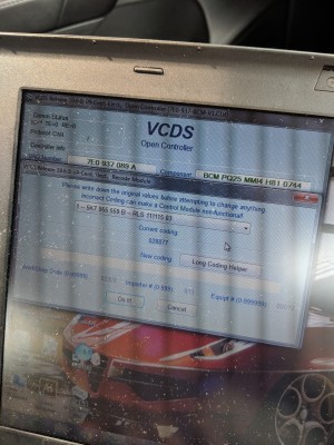

Re: Rain Light Sensor, RLS, Volkswagen Vento
Have you set the rls options in 09 Central Electric?

Could you please attach a full autoscan?

I guess your VENTO has no dimmer for interior lights next to the light switch.

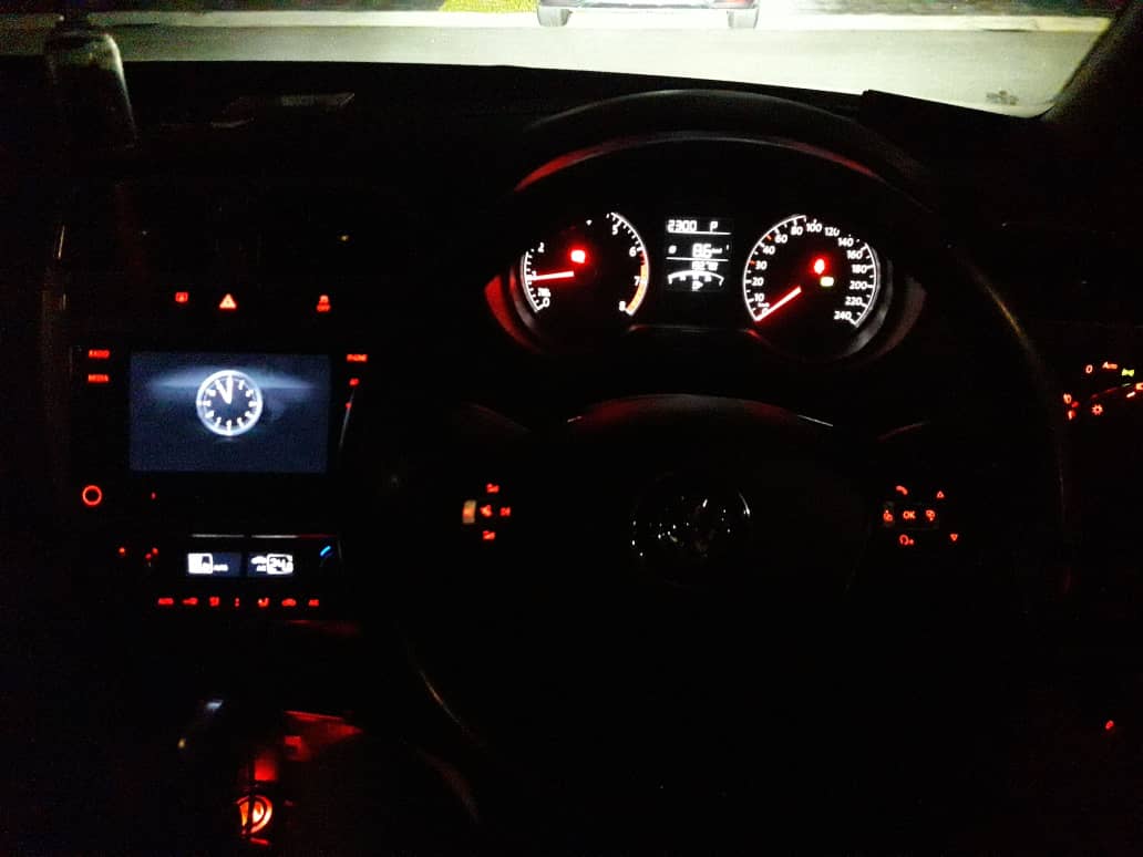

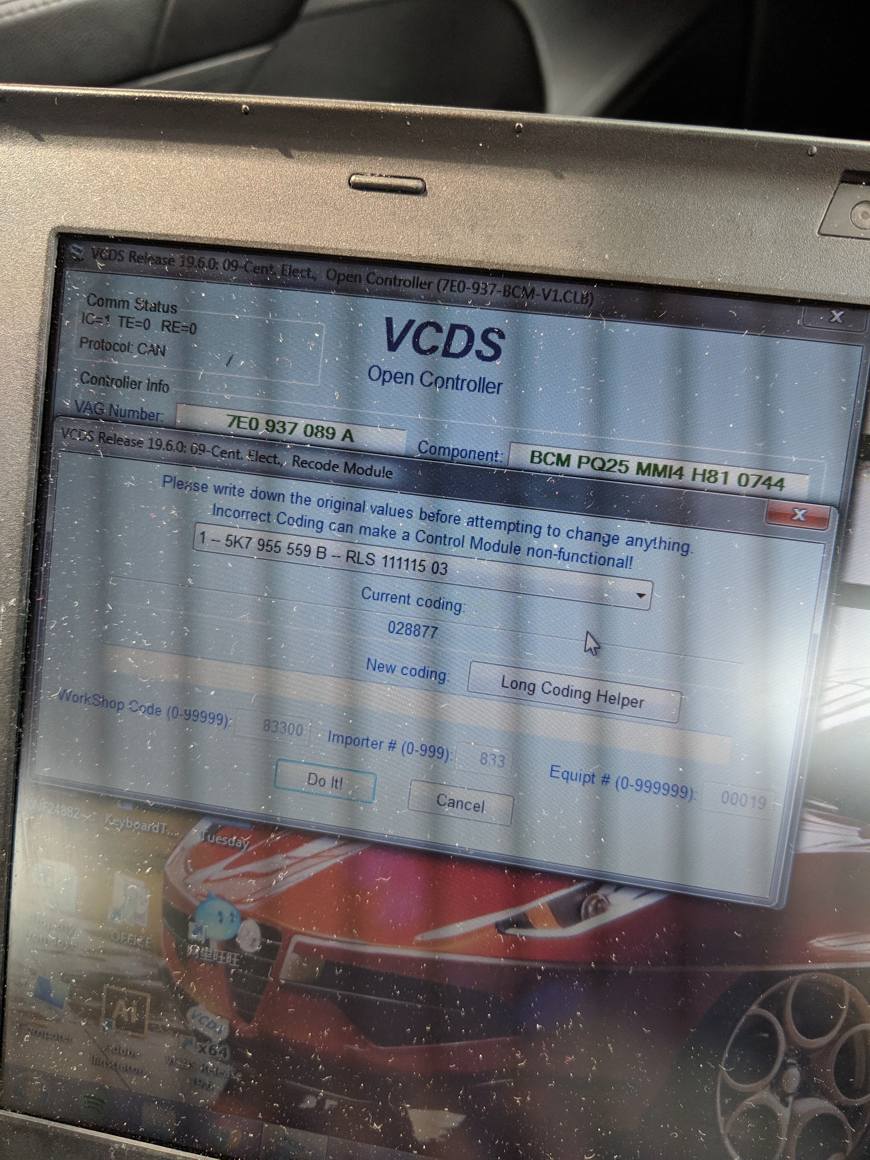

It's finally done! Thanks to a friend of mine Alvin, he instructed me to change the adaption channel 69, value change to 1. Wonderful!
Also thanks to Ciclo and iichel for sharing and teaching.
Now I've re-scan, here are the problems in the report.
