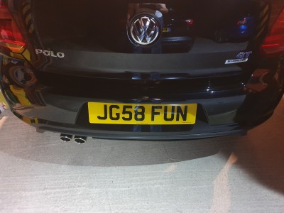

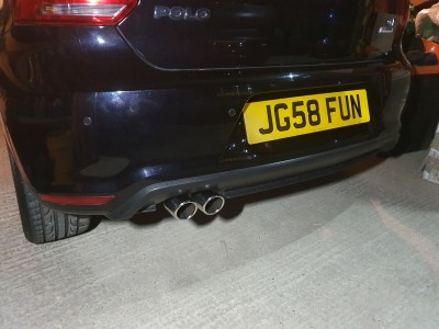

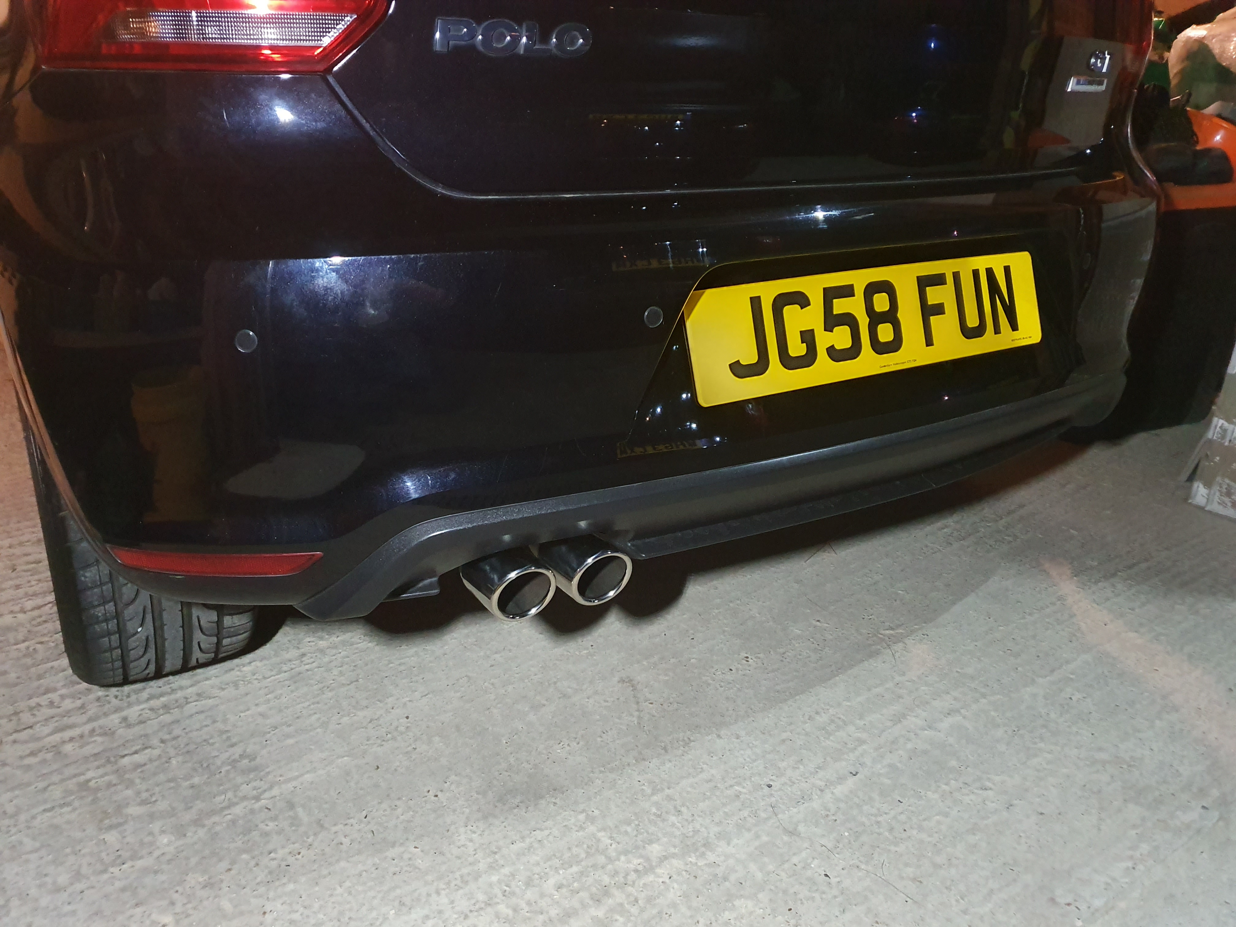

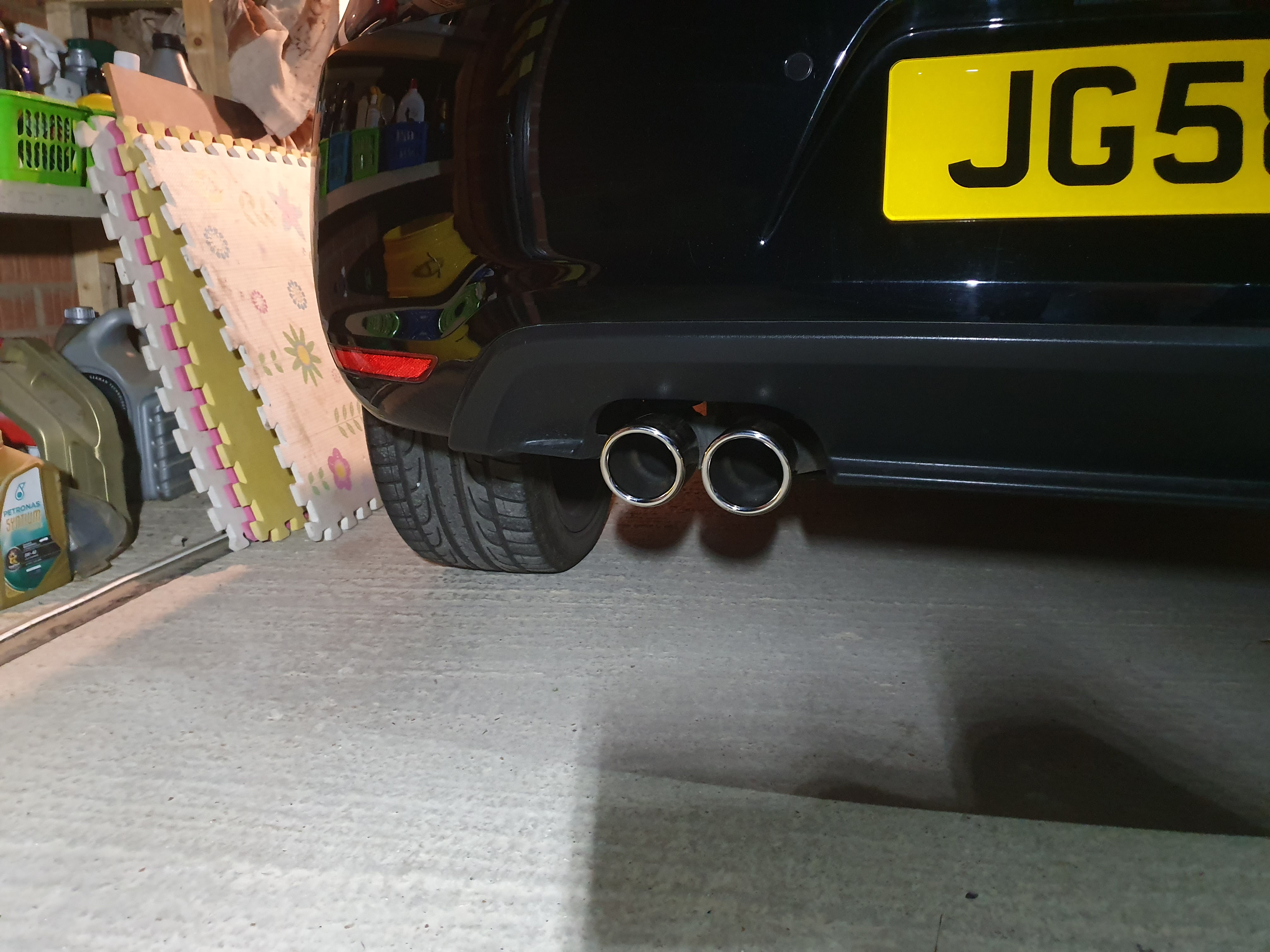

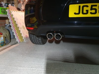

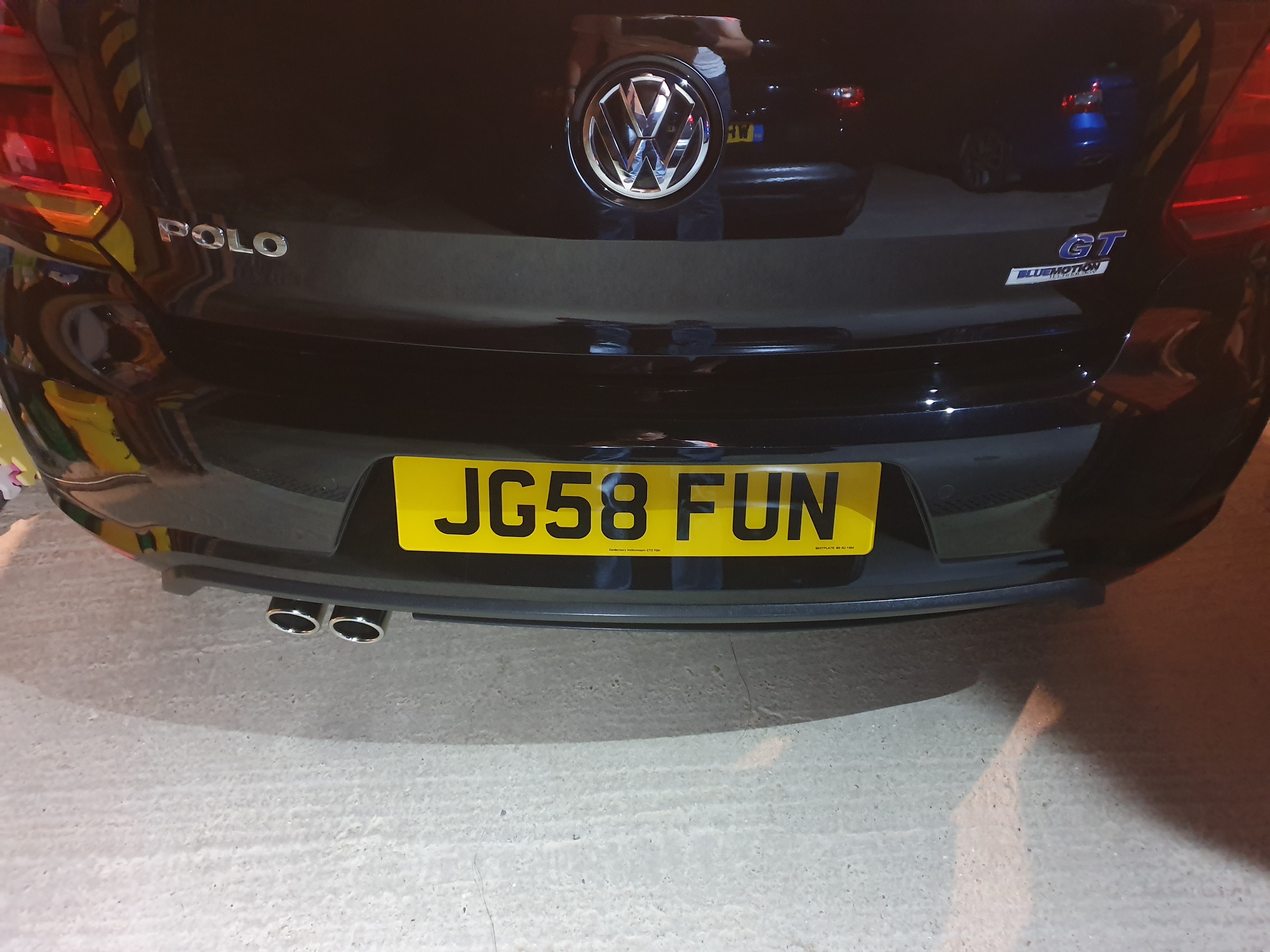

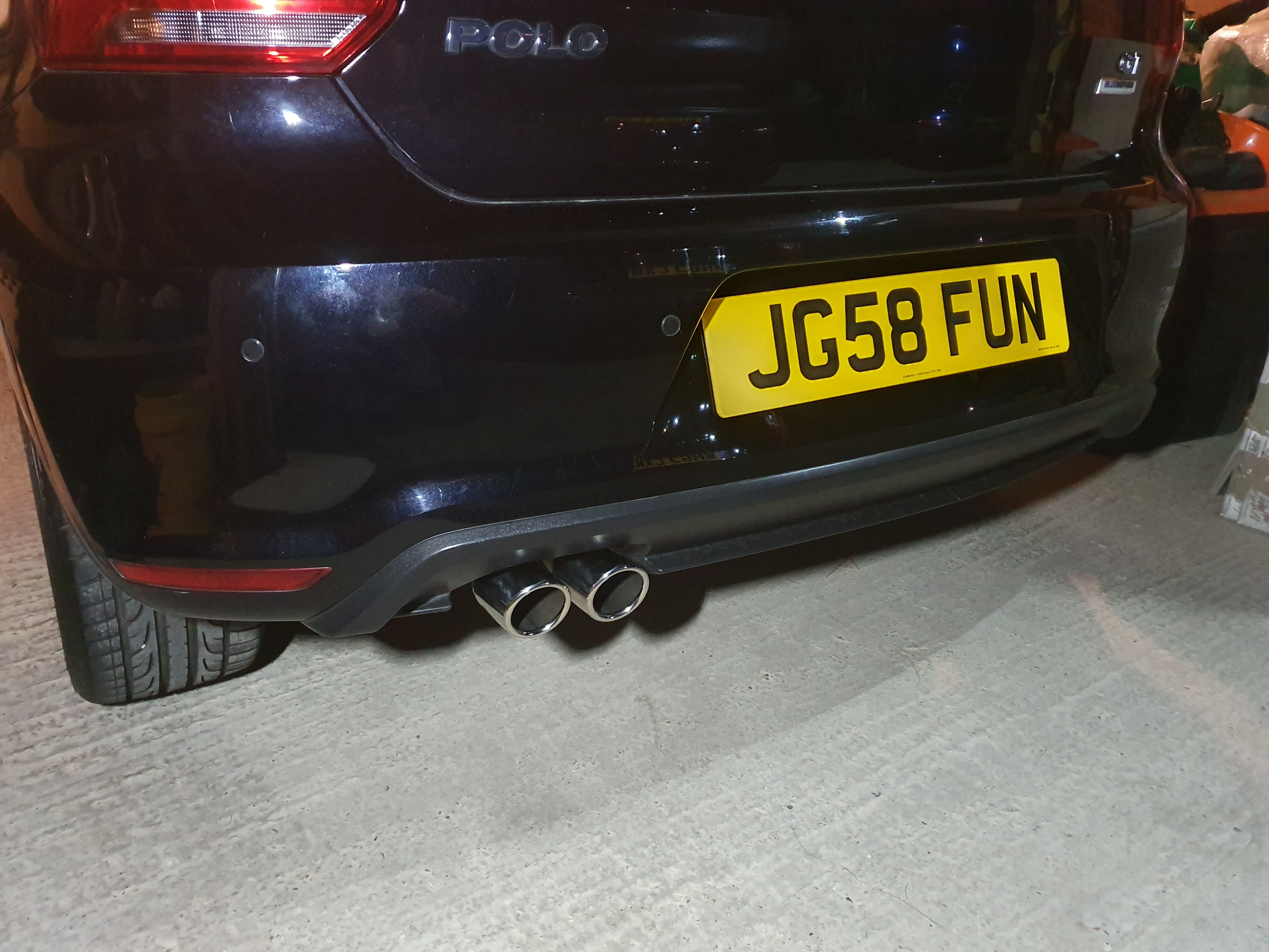

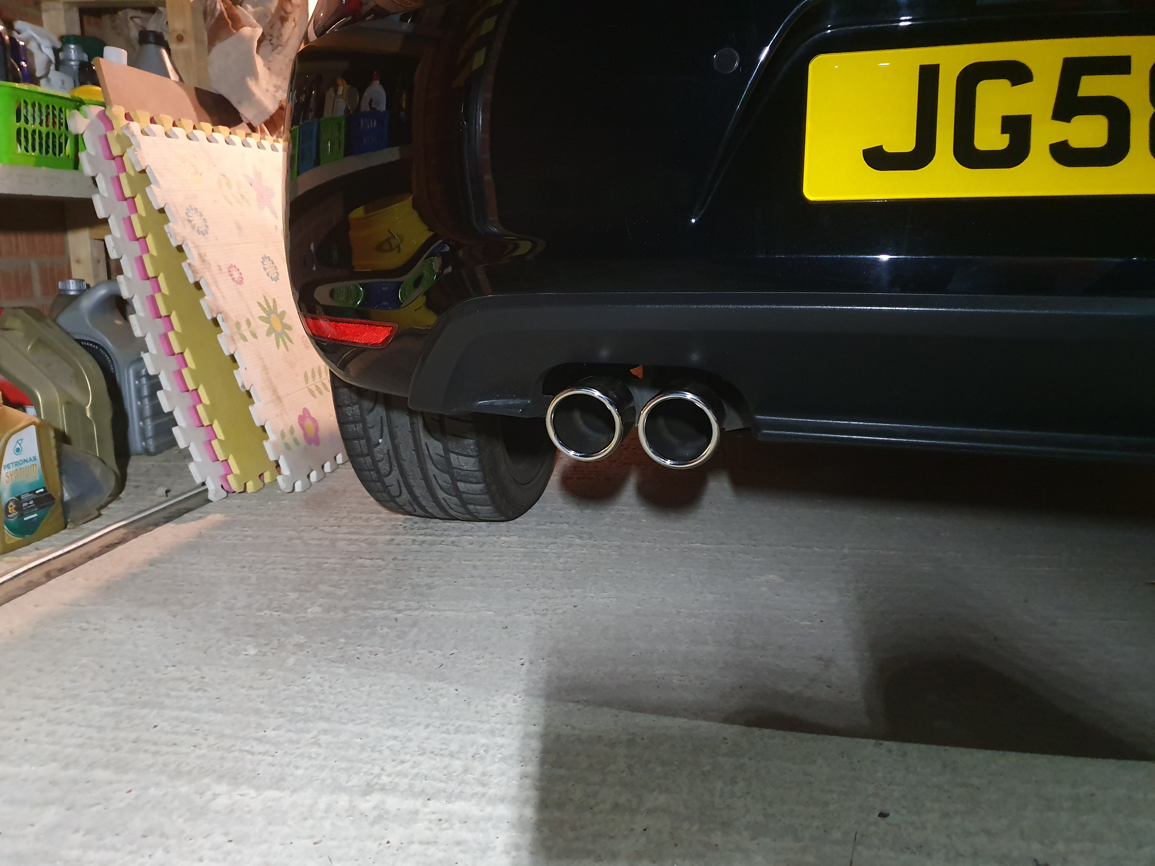

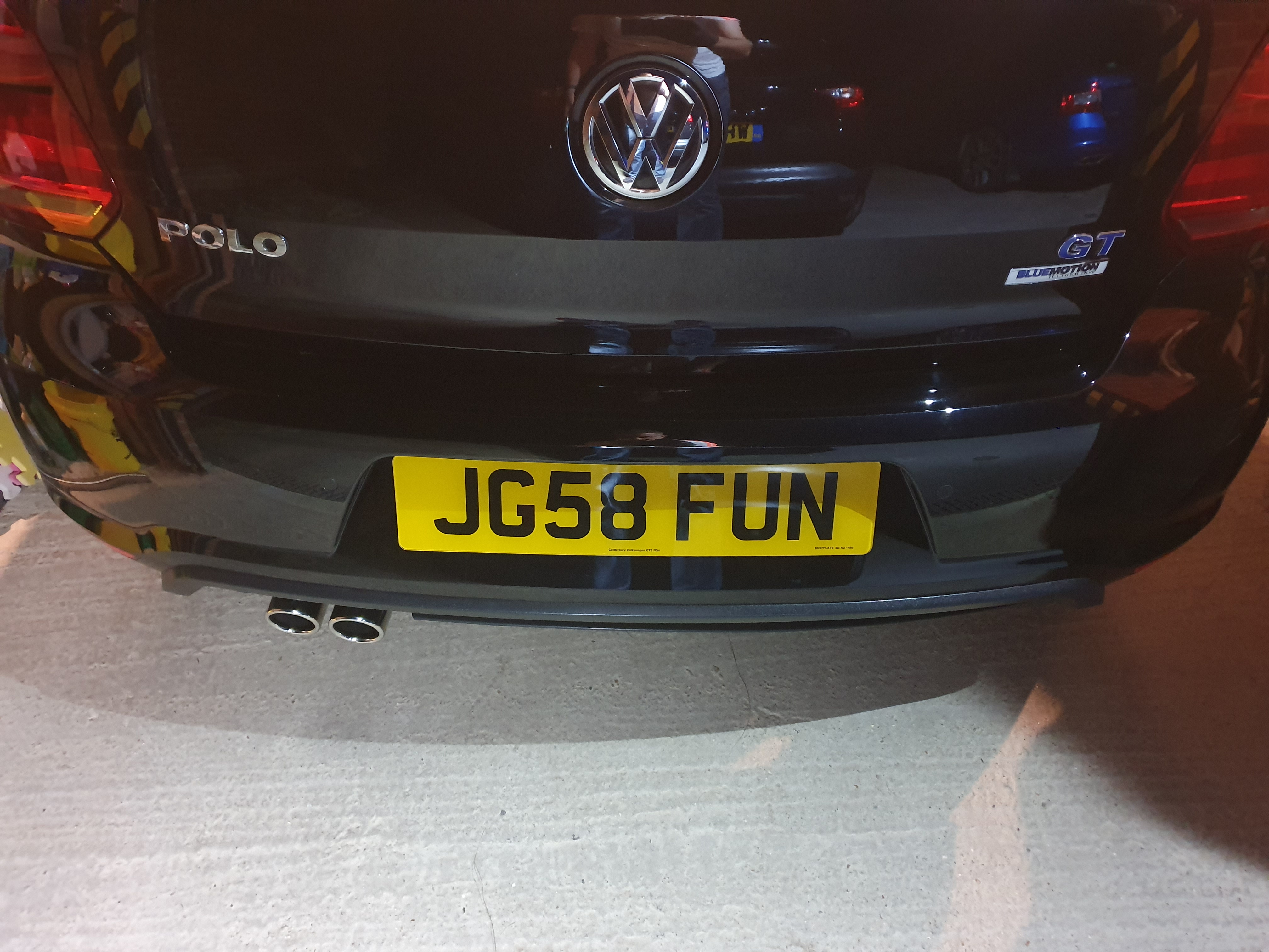

So following on from other threads about chrome tips for the exhaust on the BlueGt, I took a gamble and ordered a pair (comes as 2 in the box) of chrome tips on ebay for £35 from Caffyns. They are for the Skoda Yeti but with removing 2 of the 4 retaining clips, they fit very securely after being tapped into place with a rubber mallet. There's no way they are coming off anytime soon.
Super happy with the end result and much cheaper than the genuine Polo trims. They do sit flush to the end of the exhaust so look totally normal and oem.
I've attached some pics and of the part number/box they come in.

They look good and totally OEM, and as you’ve said, much cheaper than the Polo versions.
The Skoda Yeti exhaust tips fit other VW models too; quite a few forum members over on golfgtiforum.co.uk have fitted them to mk6 and mk7 Golfs.
