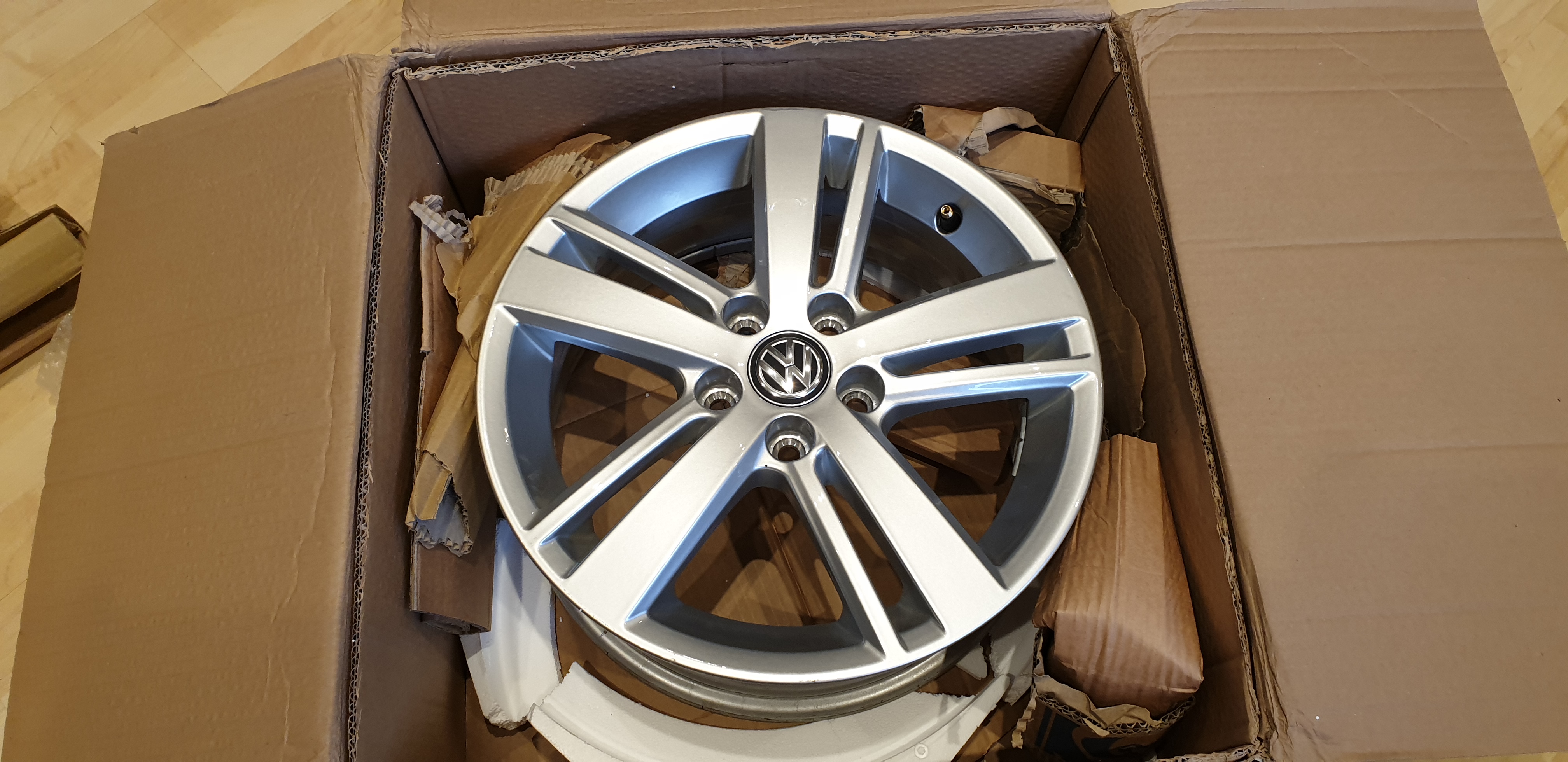

Quick update, I have VW original alloys (6QS 601 025 C) alloys (old stock) being shipped to me which look the part. Fresh out of the box. Just to source new winter tyres now.

Wheels arrived today. Factory fresh having been in storage.
