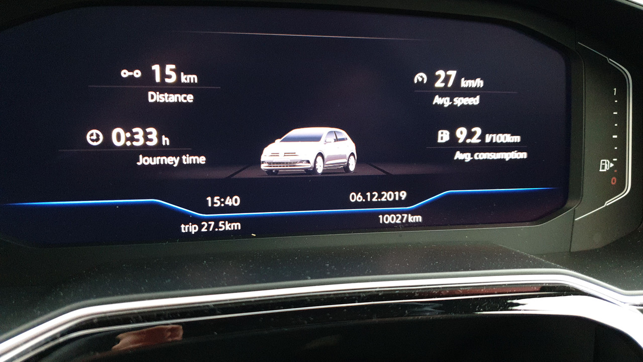

Stupid question maybe but what does trip 27.5 at the bottom right of the screen refer to? On the AID, I never have to reset the trip computer like on traditional instruments as it does it all for ya when you fill up. It's not the distance for the journey as the above was 15kms. It's not the distance since the last fill. It seems to be the distance since I hit 10,000km. Confused :?: :?:

It's your trip mileage..
It's synced with main odometer from new, so if you never reset it, it will count up with the main mileage up to 9999 and then back to 0 every 10K KM/Miles.
To use it's intended functionality, scroll down the Driving Data using the up and down arrows on the right hand side of the steering wheel until you find 'TRIP' Click OK and it will display the current trip mileage as in your main view.
Holding down OK resets the trip meter back to zero. It will then increment once more until the next time you reset it.

roywolfey wrote: Mon Dec 09, 2019 2:30 pm It's your trip mileage..
Thanks for that! You are correct.
