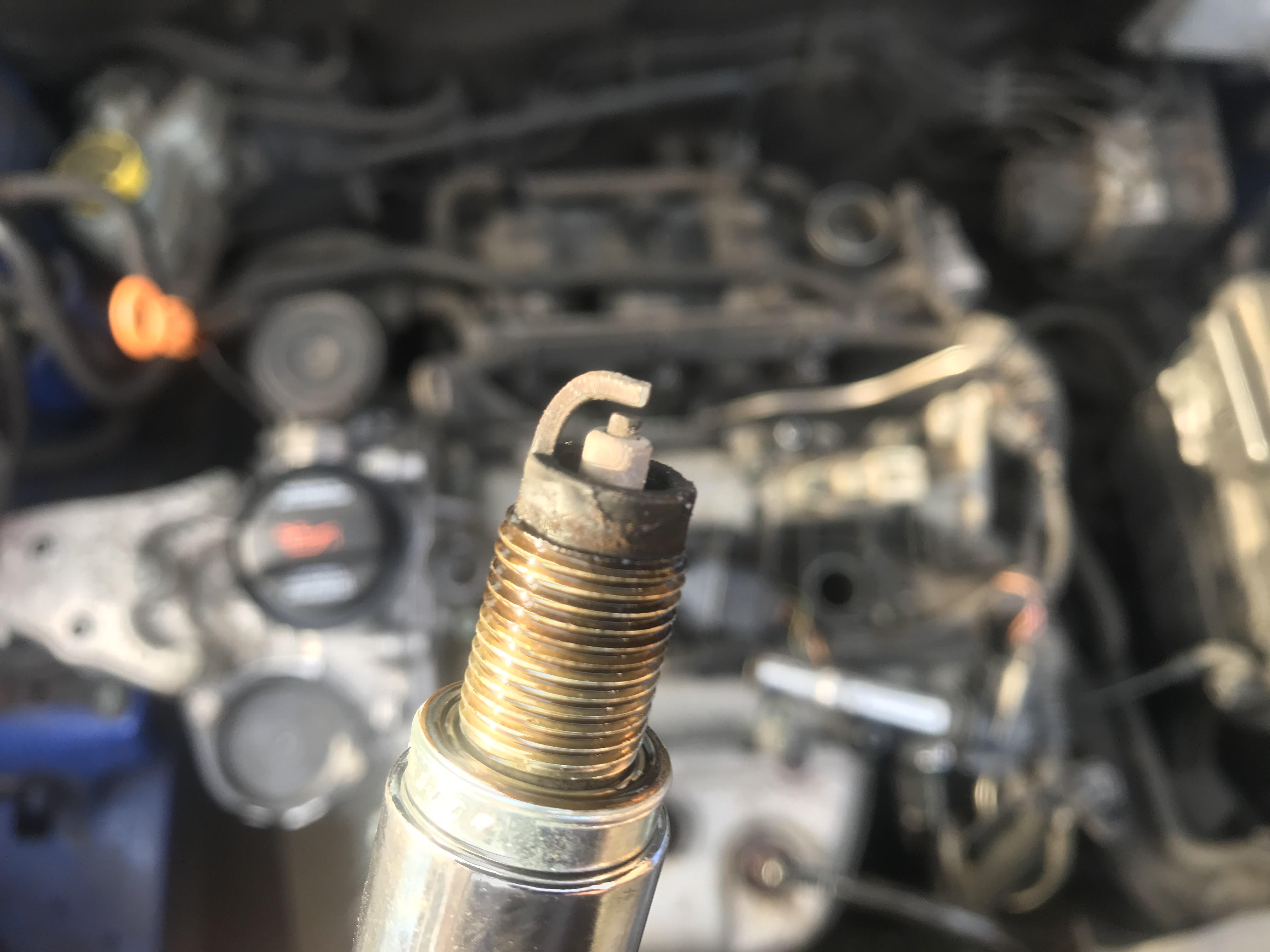

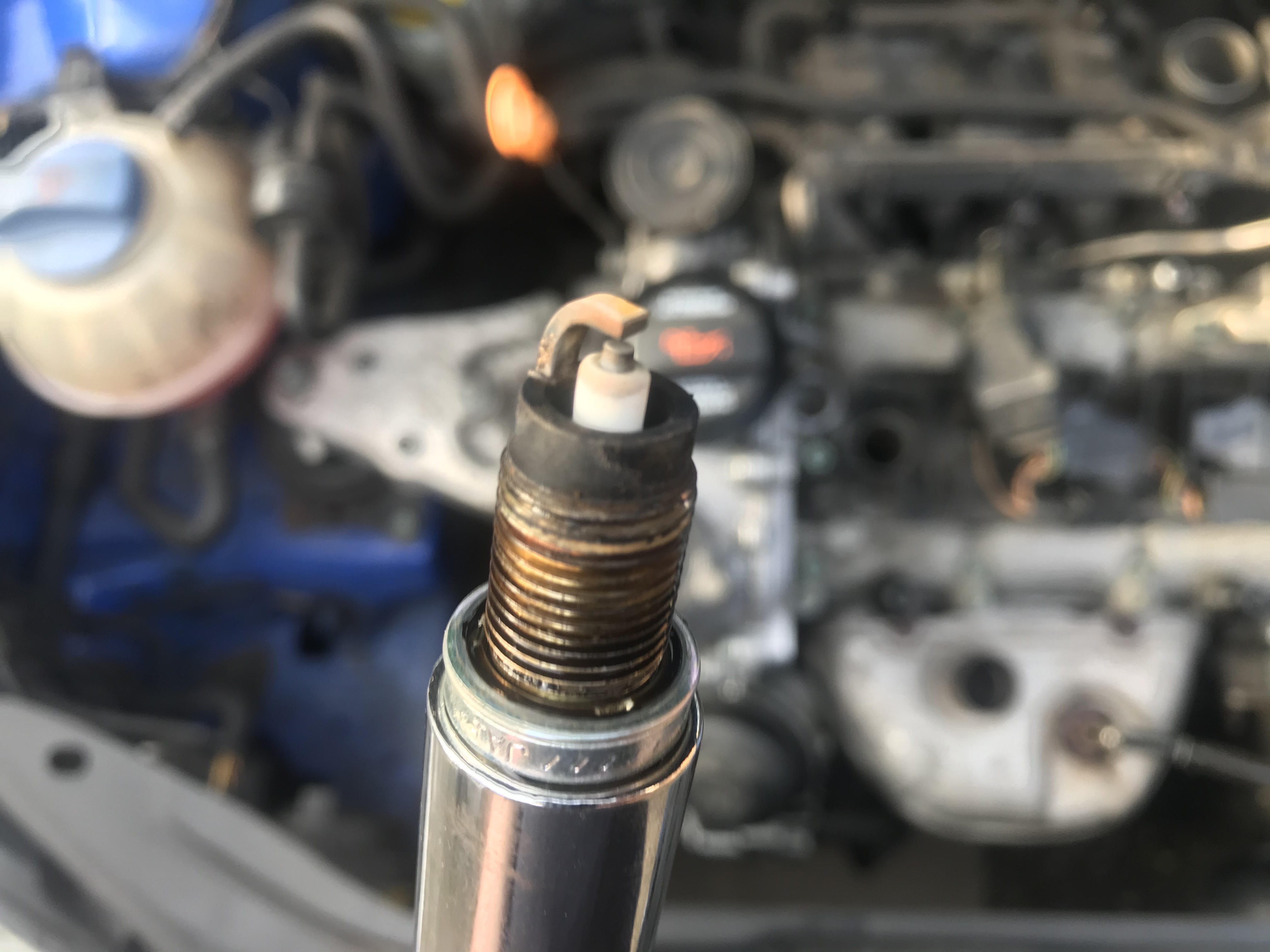

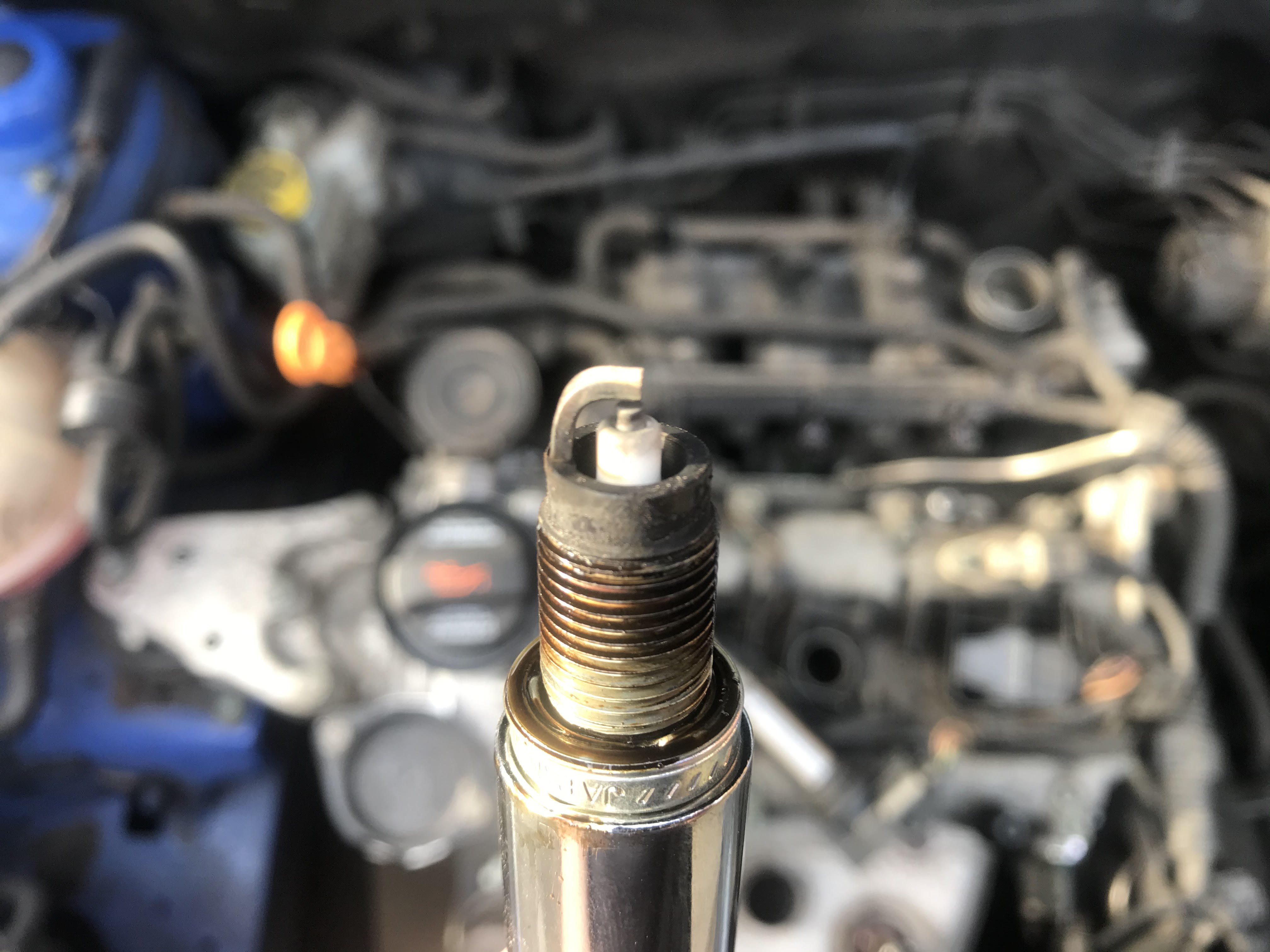

Pulled the plugs and they look fine to me and I have attached pictures.

Forgot to attach pictures of the spark plugs.
Cylinder 3
Cylinder 3
Cylinder 2
Cylinder 2
Cylinder 1
Cylinder 1
