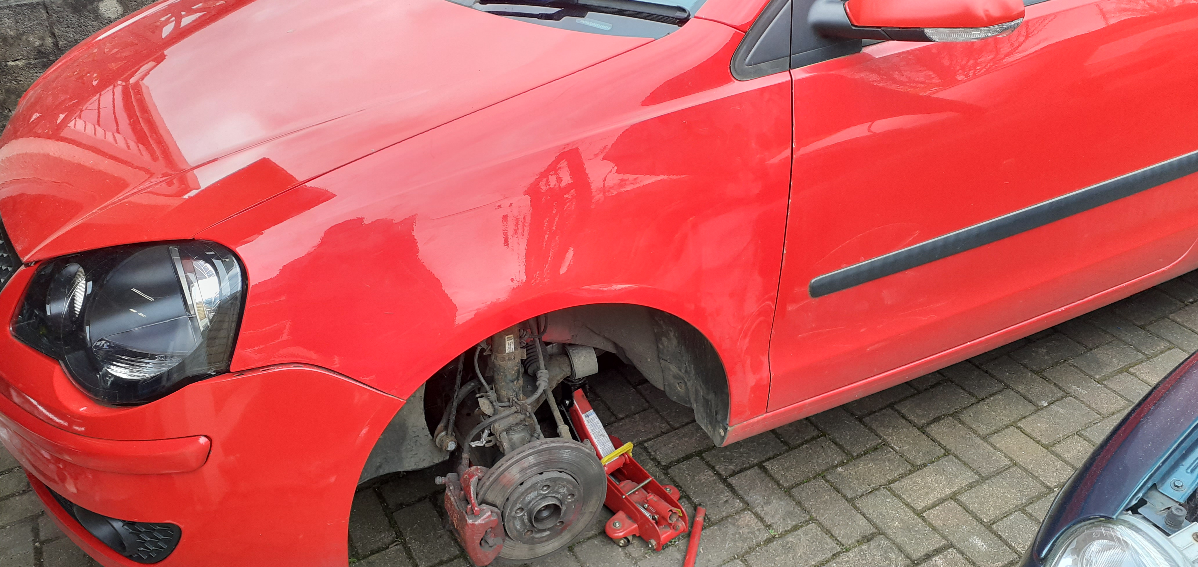

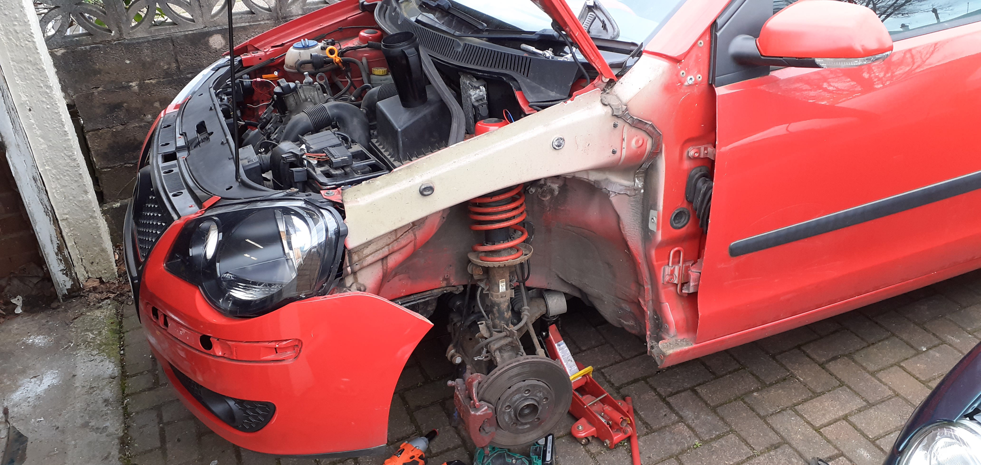

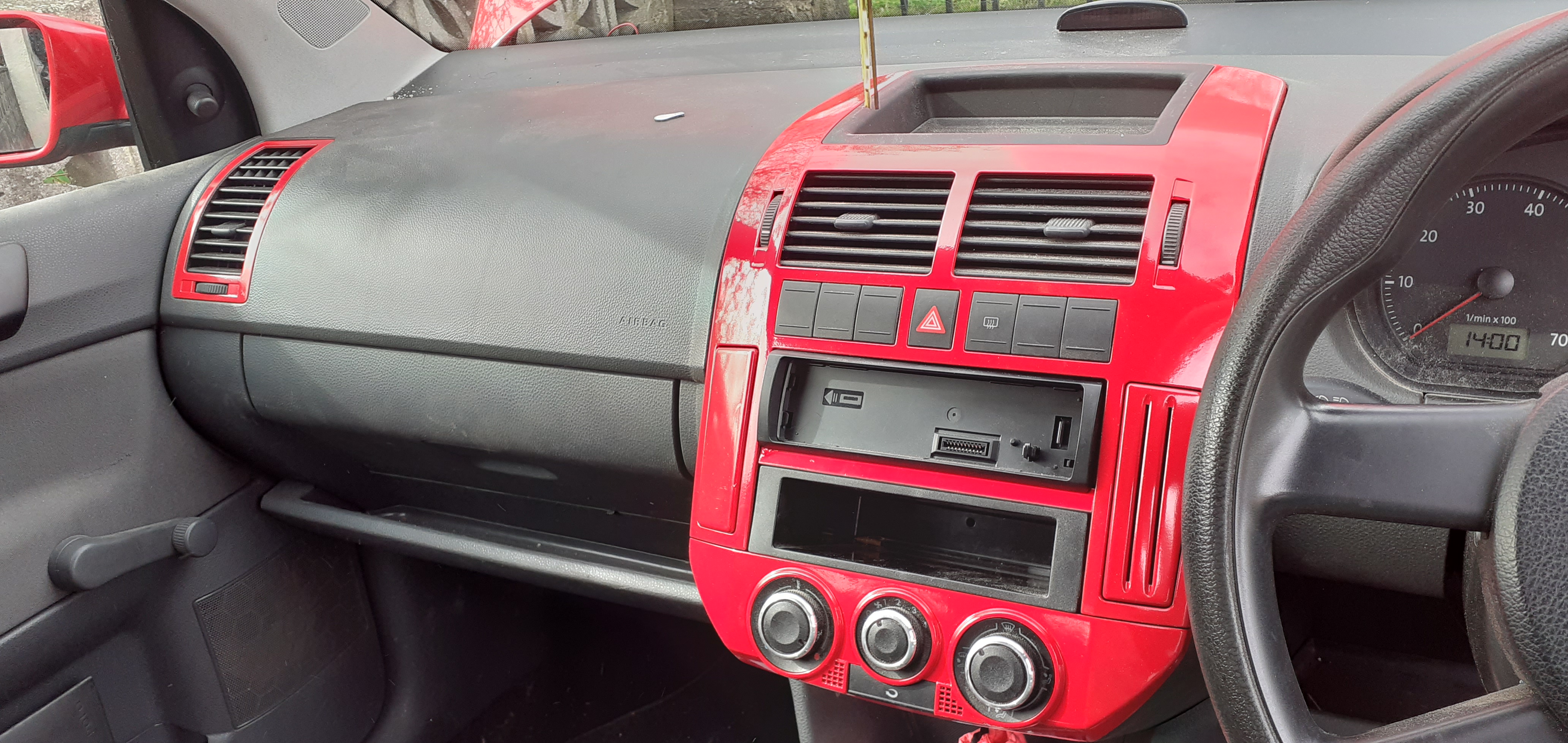

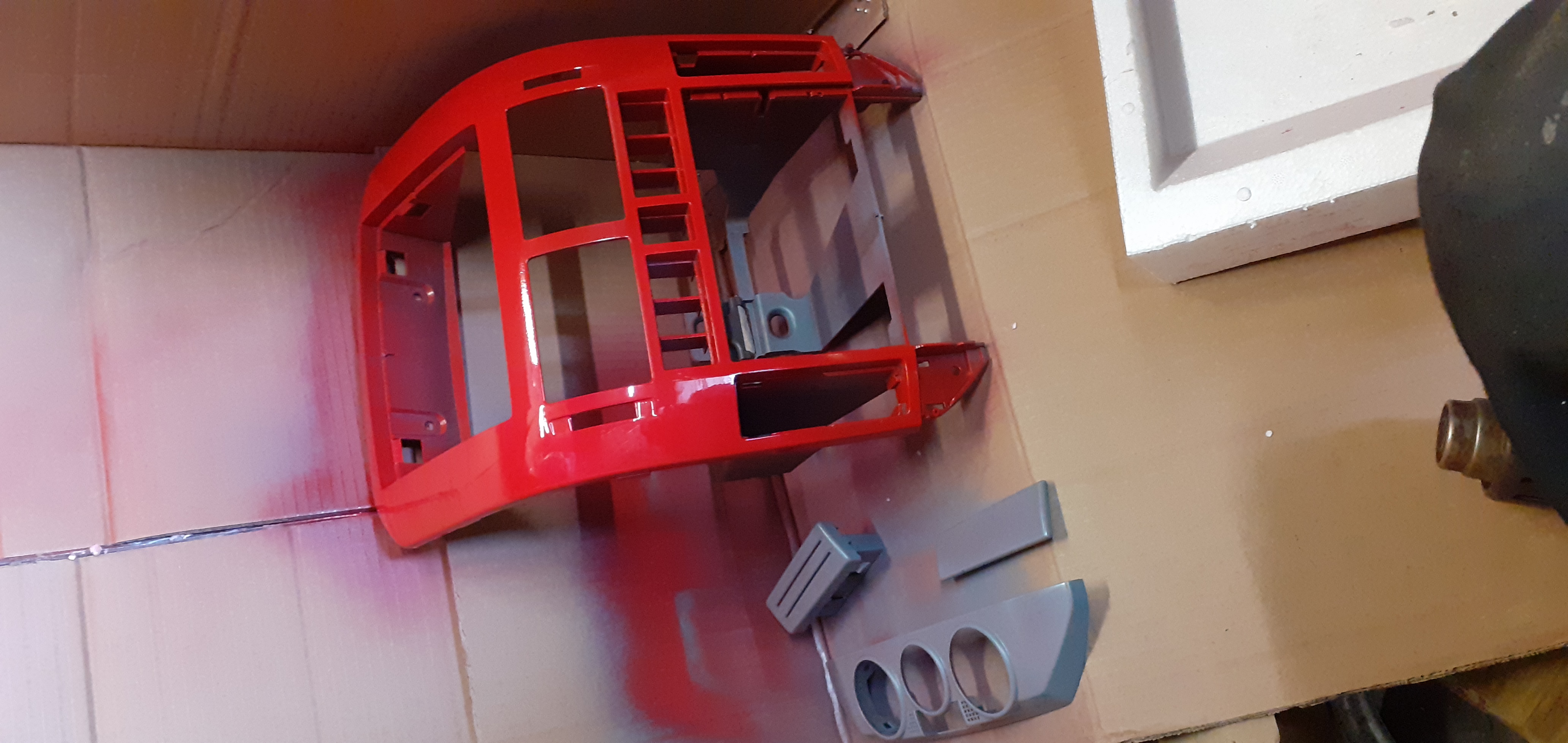

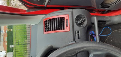

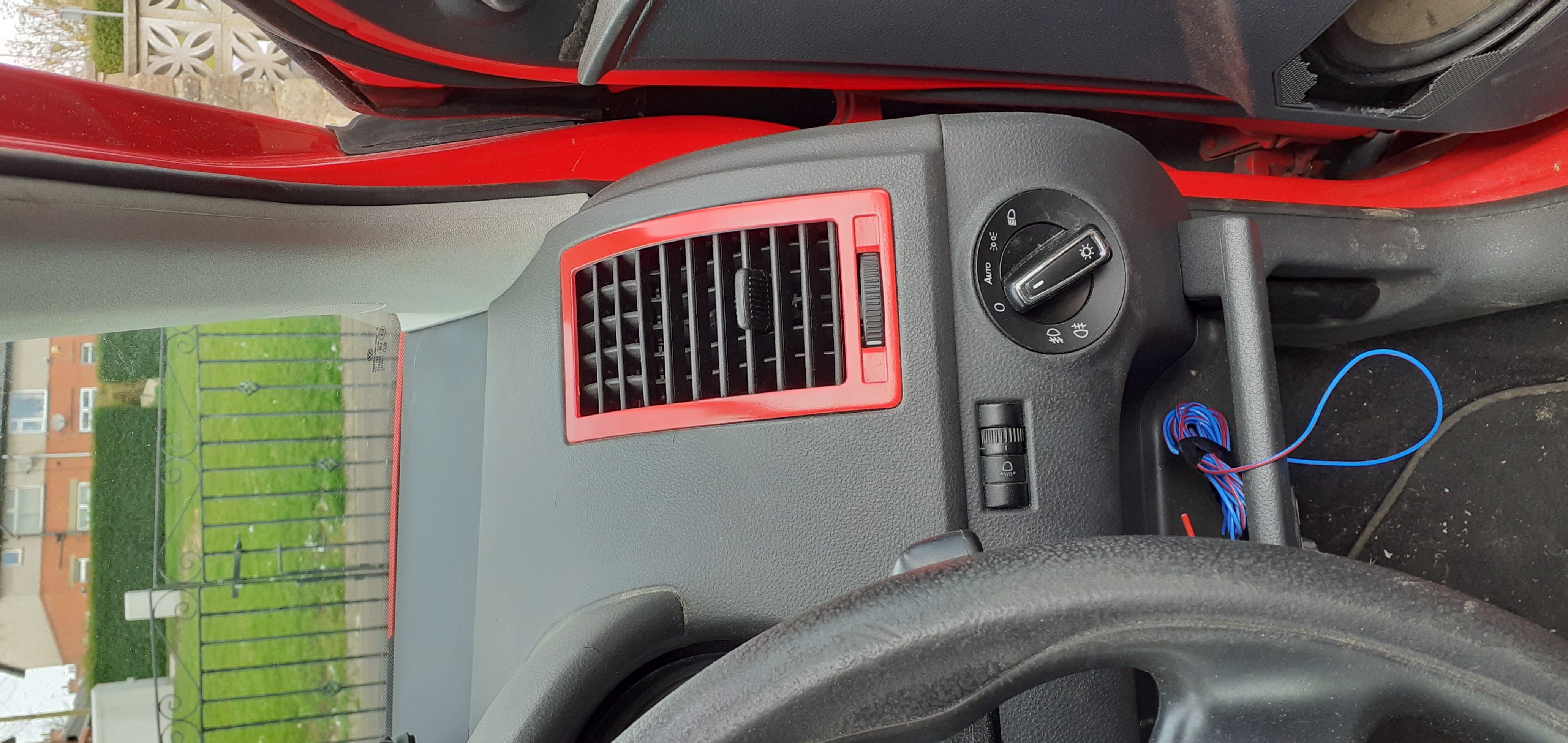

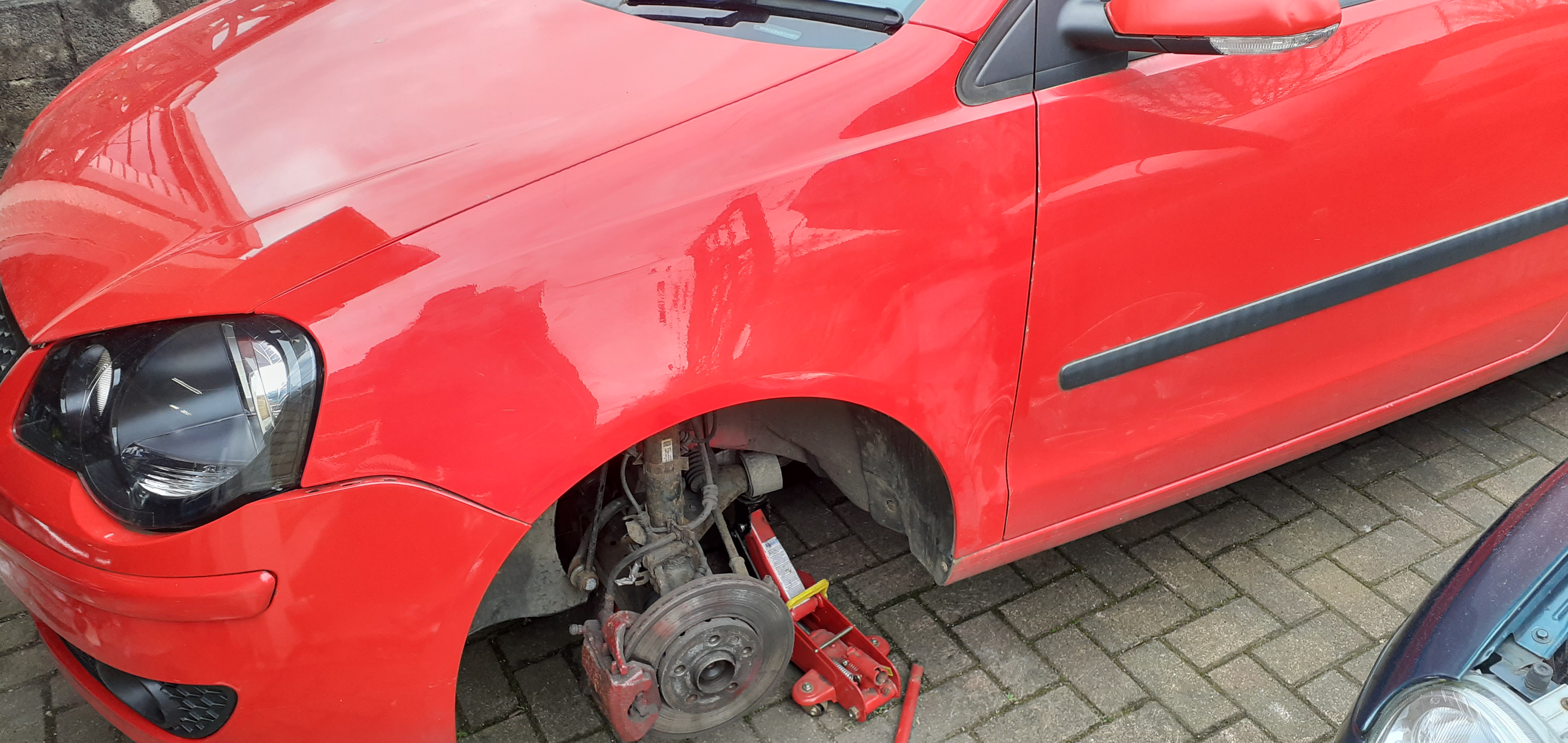

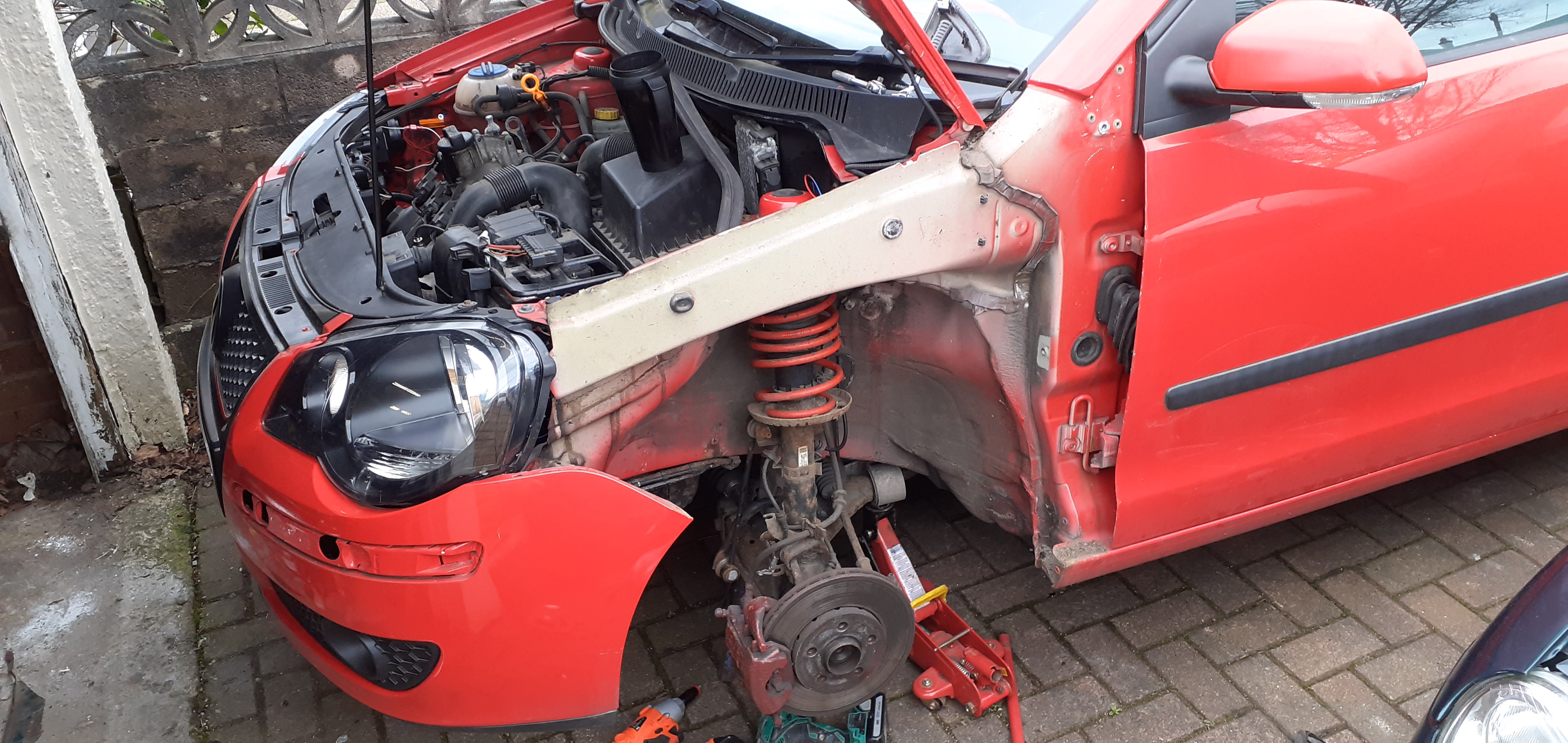

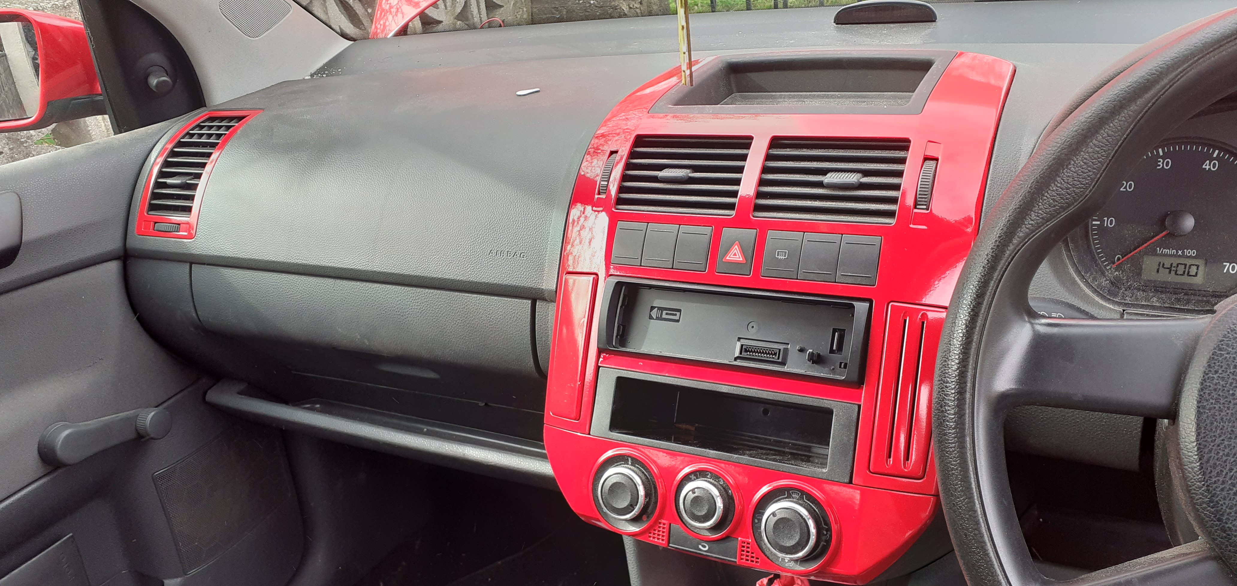

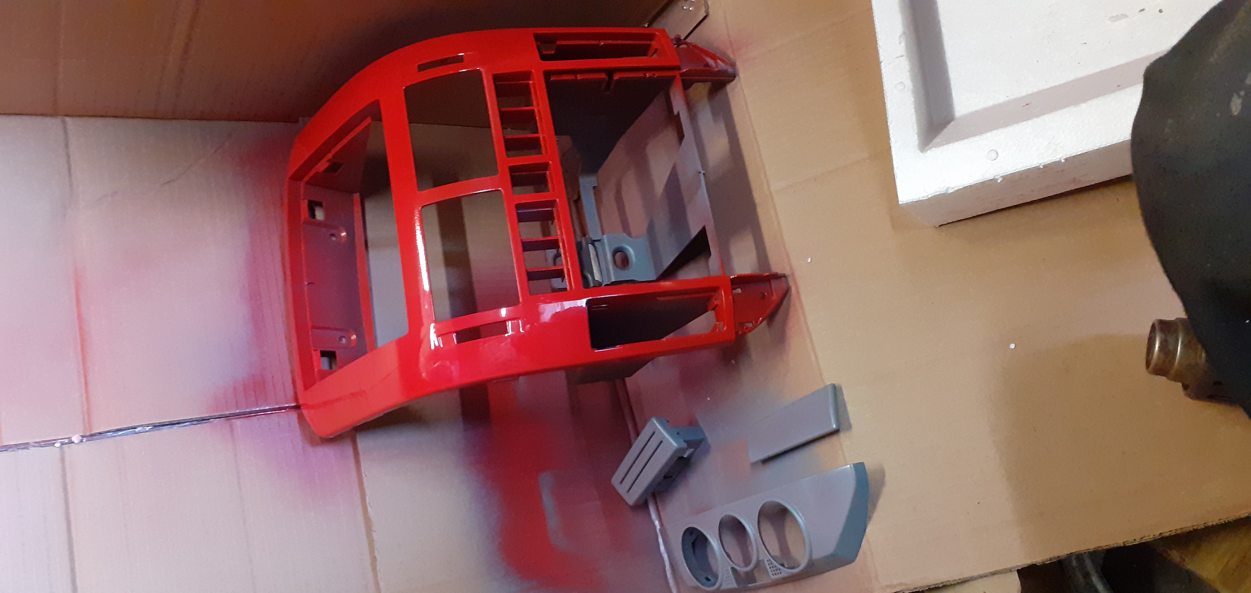

Both front wings were dented on it, I've managed to get one in the correct colour so that's been fitted, and sprayed the vents and centre dash to match the car. Foglight and daytime running lights fitted with new headlamp switch.

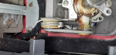

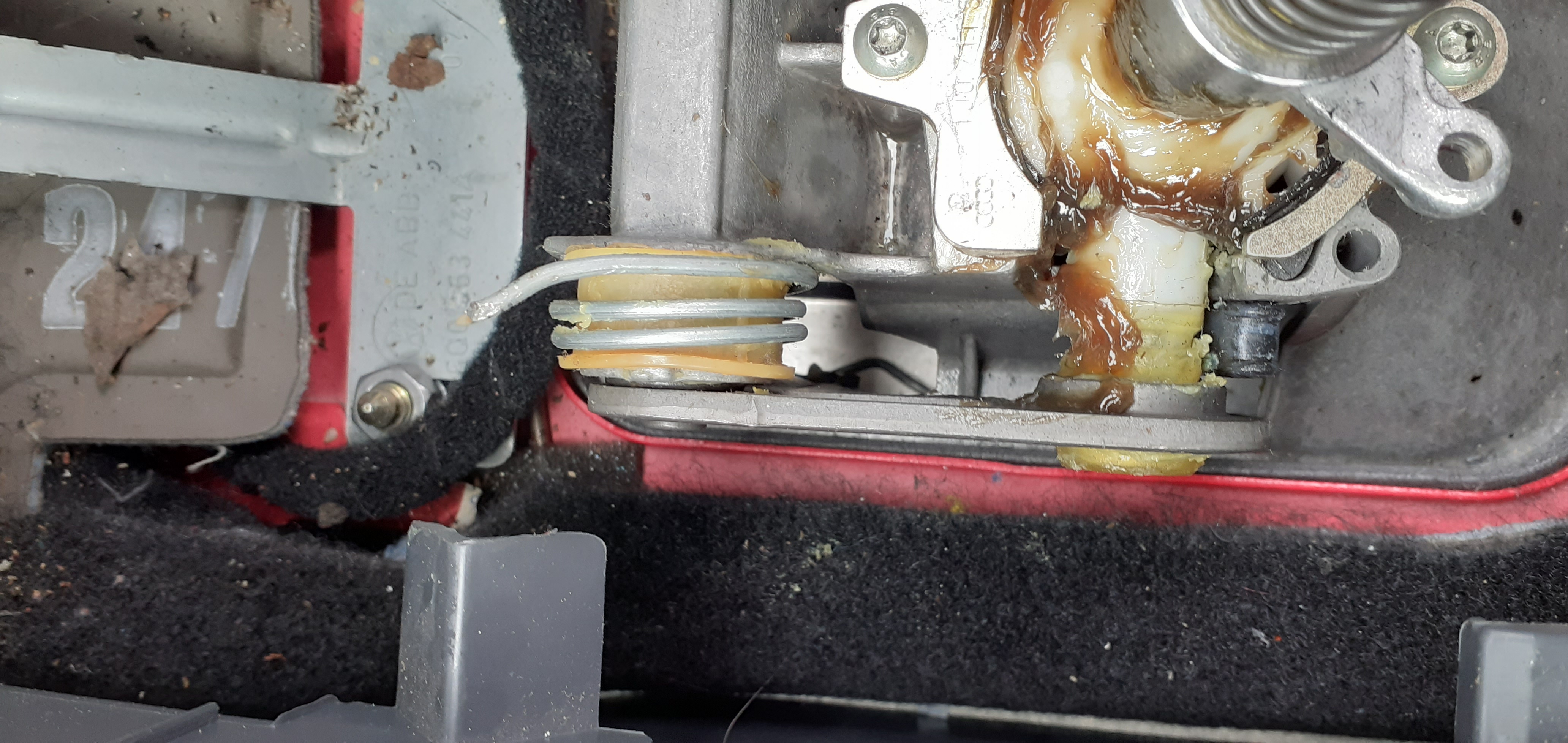

Something else that needed sorting was the gearstick stopped centring a few weeks ago, investigation showed the spring had snapped. Ebay showed prices of £16 for them, jeez! An online vw parts supplier were three pounds, but seven for postage.

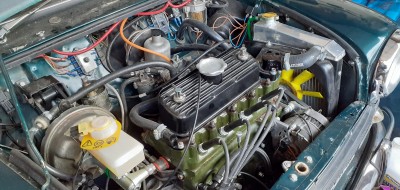

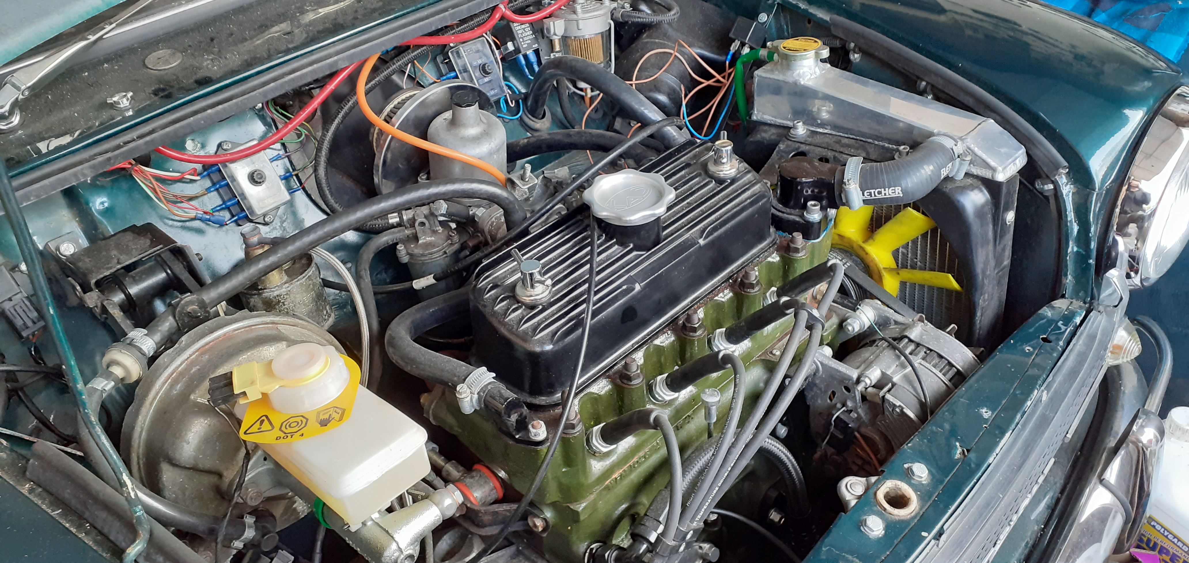

Master cylinder replaced as was the cause of the mysterious brake fluid disappearance, slight weep through the body of it, then starter stuck on, so new one of them.

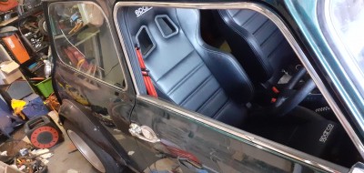

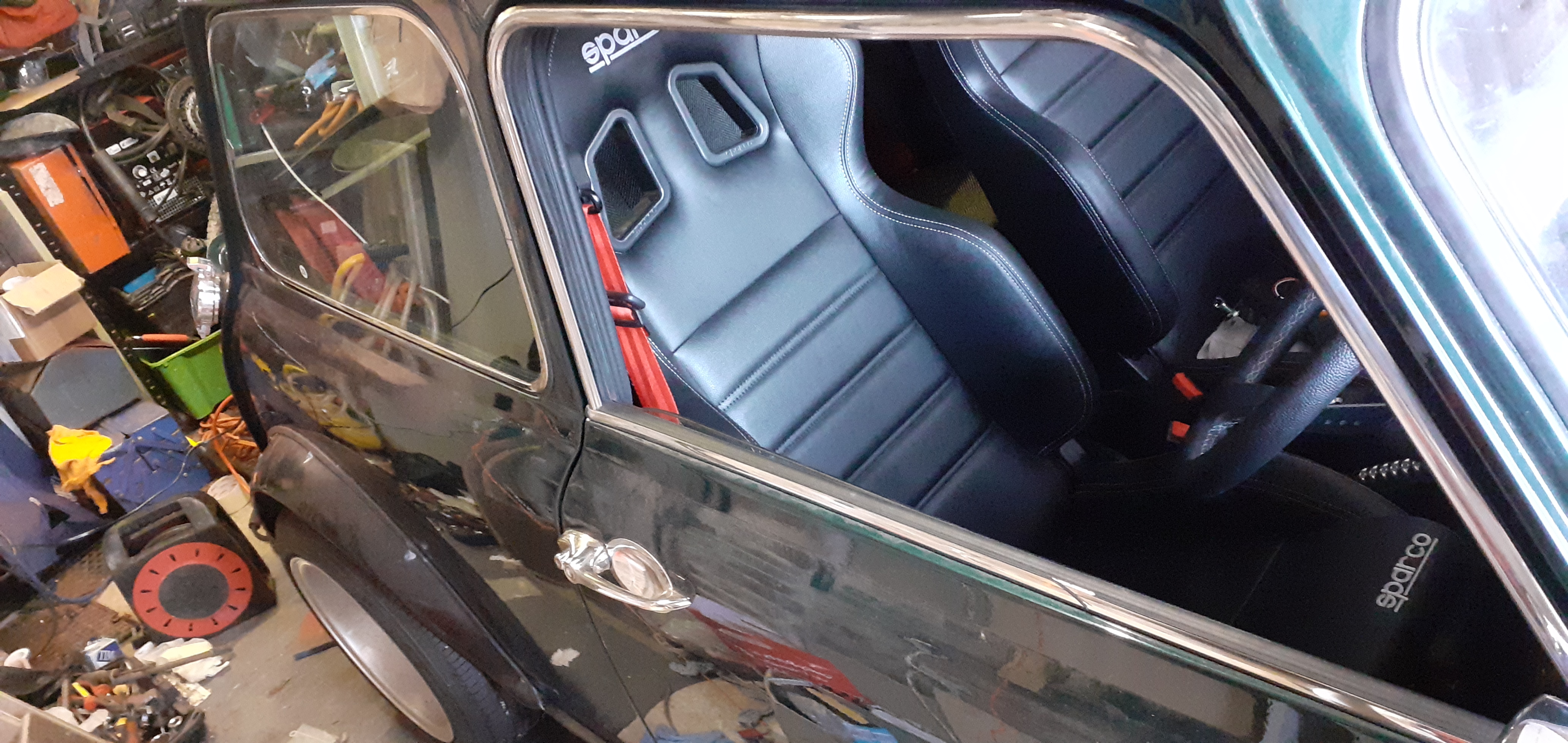

Wanted some more supportive seats, finding some narrow enough was the challenge, Sparco r100 fitted well, modified the subframes to bolt them in too. Steering wheel didn't match so got a sparco one, which then showed up a seized indicator stalk, replaced that yesterday along with oil pressure switch to tidy up the engine. Dashboard out and front speakers fitted.
Carbon fibre sheet arrived and was able to make ashtray blank and fit shift lights, just got to program them properly, running megajolt ignition so plug in laptop and alter output.

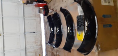

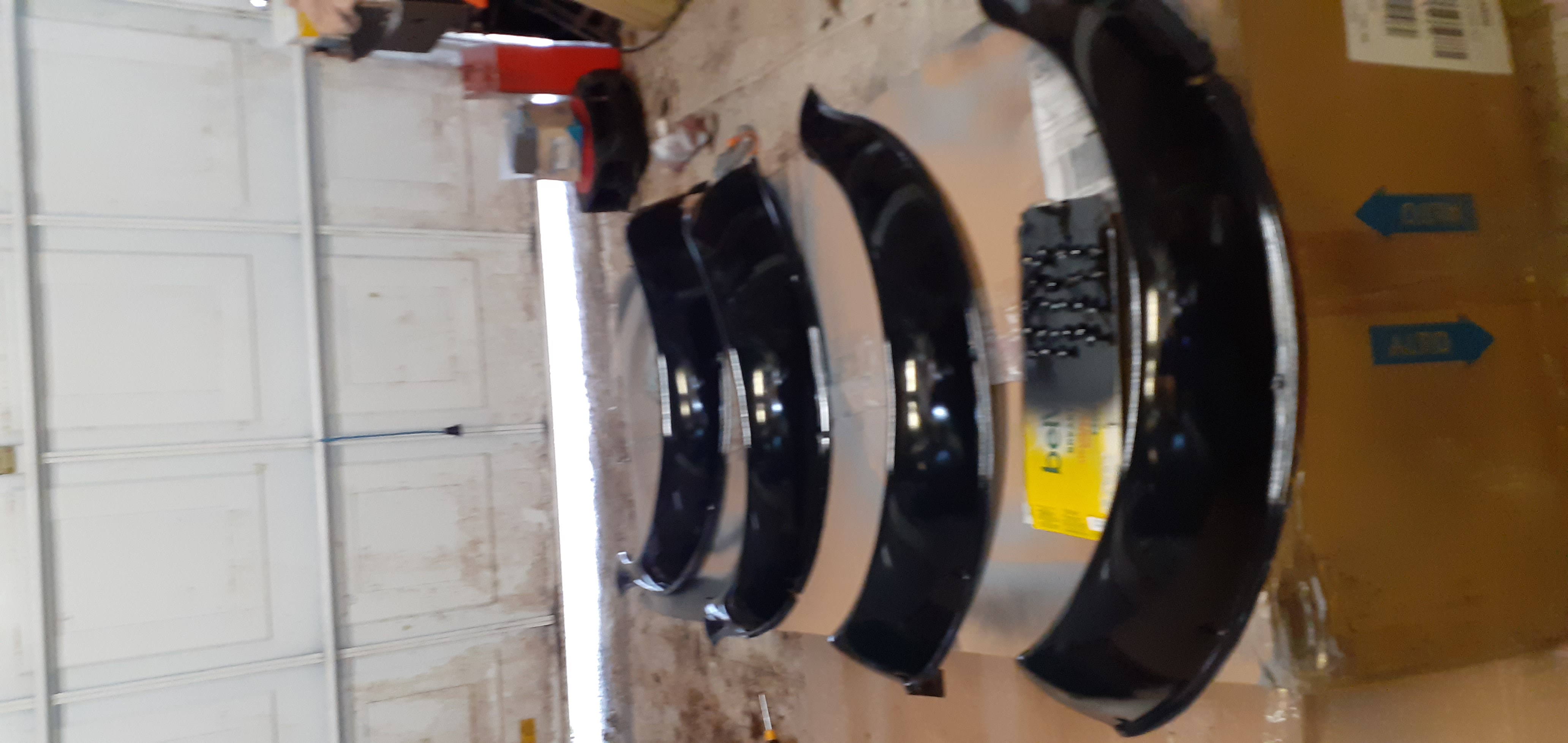

New arches fitted (fourth set that have been on car) and bonnet almost ready to fit after bonding mounting points in.
