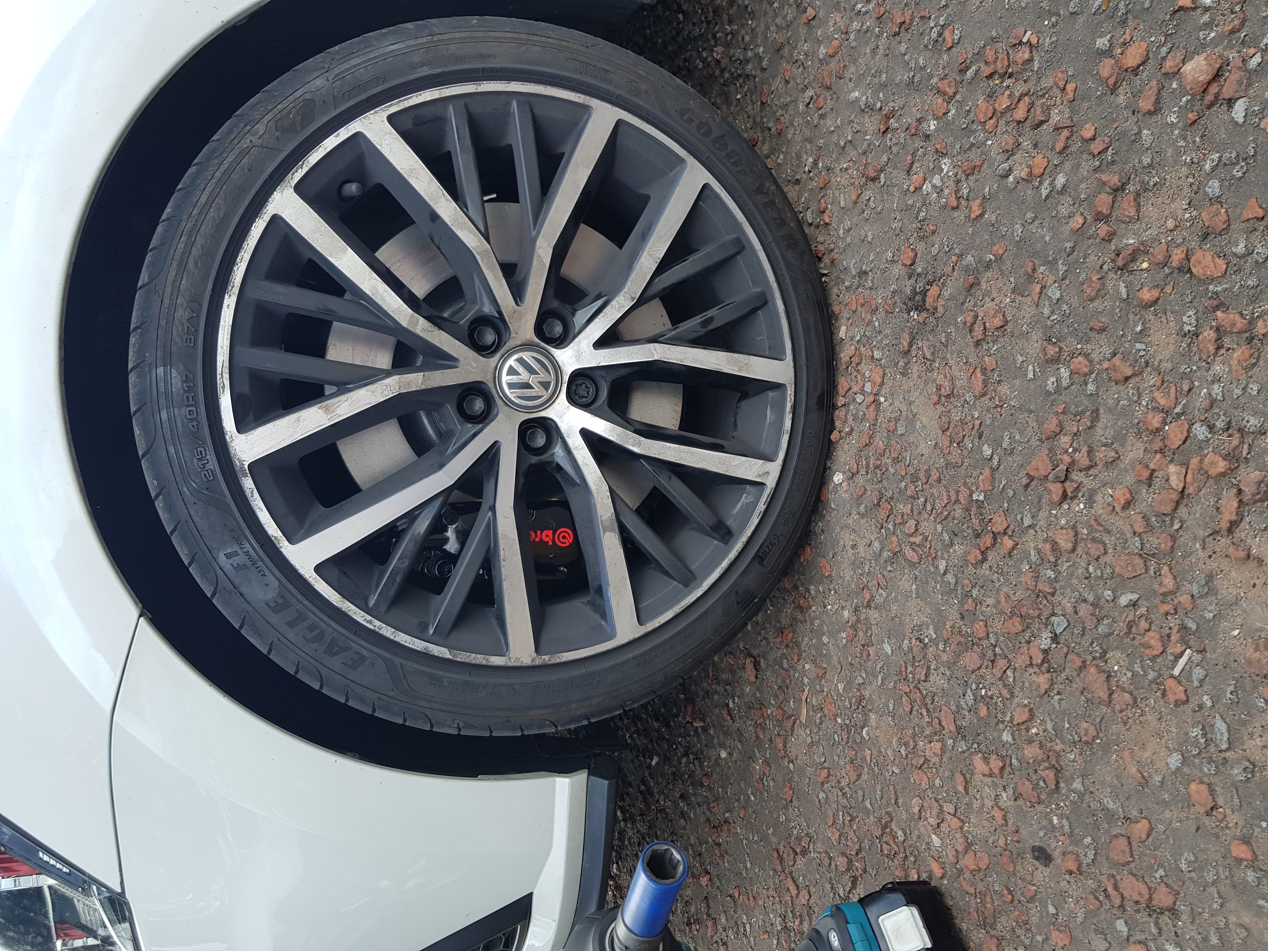

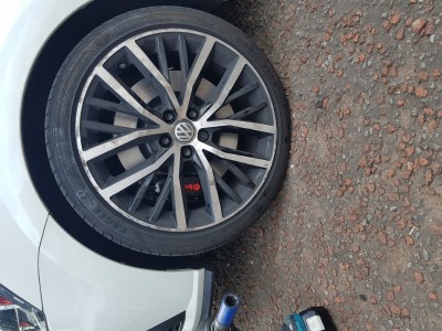

Post by Dink »
as i said you will have to get braided lines made to fit not just off the shelf polo ones.
i run brembo HC discs and ebc yellow stuff pads.
i'd also upgrade the rear to 256mm vented rears as the rear does go light under heavy braking imho (i have upgraded the rears)
