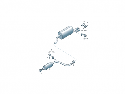

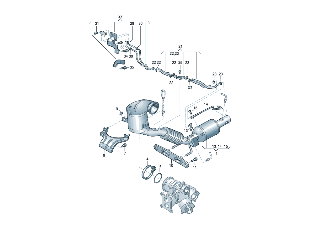

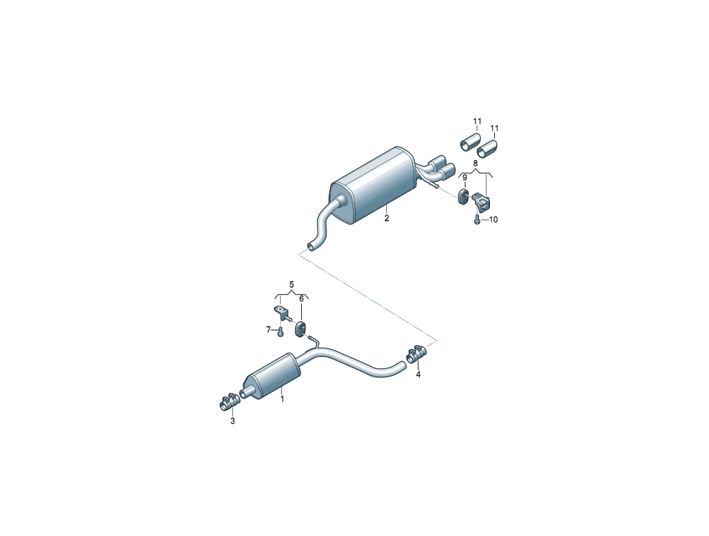

This is whole exhaust from turbo to the end (MY2019). There is no ventil or flap on exhaust also there is no changes to MY2020 or 2021.
- Posts: 2643
Re: Exhaust valve and aftermarket exhaust
Dark_cze:-
Those diagrams are of GPF implemented exhaust though aren't they? I assume MY19 started after Summer shutdown of 2018 when all the non-GPF cars for Europe had been built pre-WLTP compliance. The cylindrical box at the end of the front section looks like a GPF.
Do you have diagrams of MY18 GTI exhaust (pre-GPF) to confirm valve or no valve?

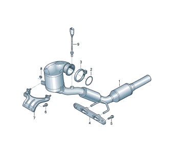

This is pre WLTP and no valve either.
