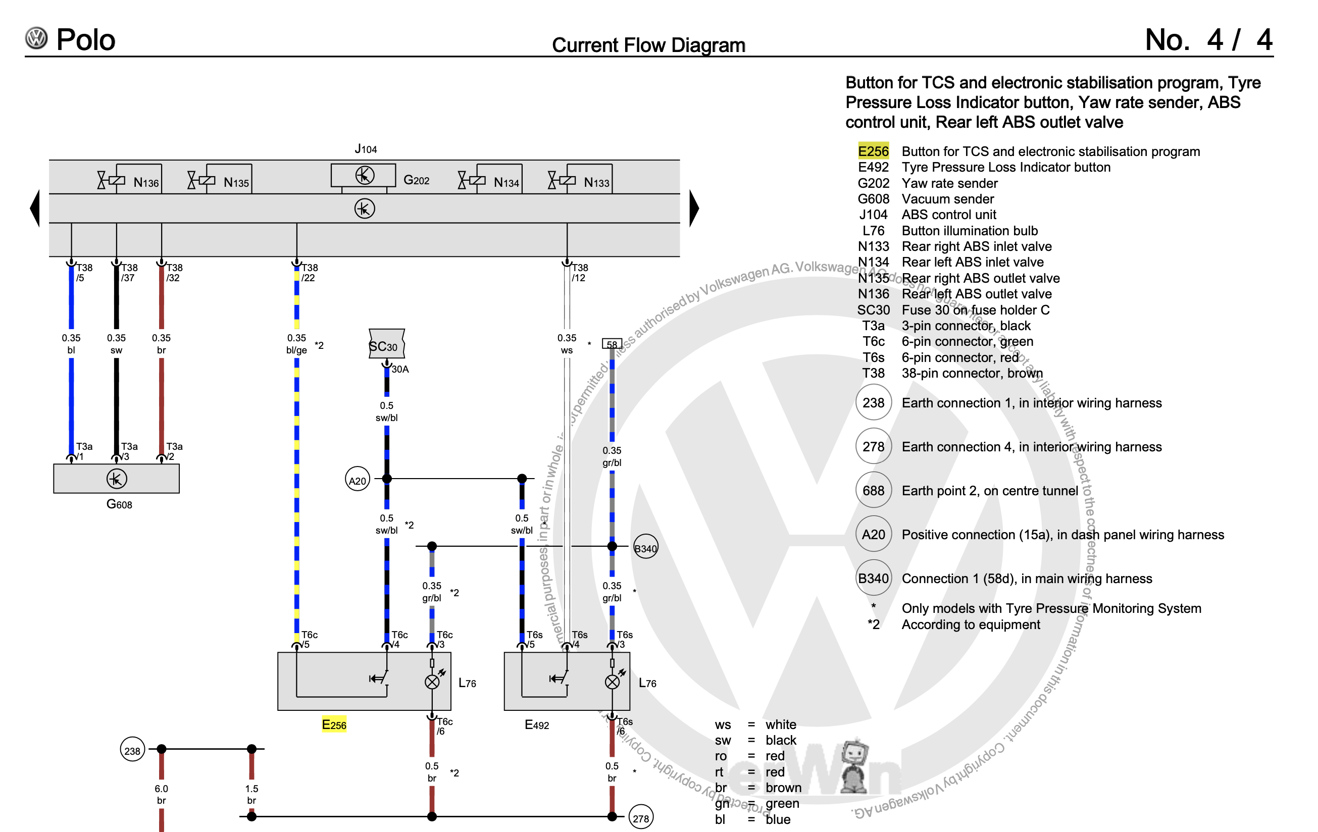

- Posts: 6695
Re: Polo 6C ESP off retrofit button
Here is the wiring diagram for both the ESP and TPMS button
Tex
- Posts: 99
- Joined: Mon Apr 06, 2020 8:44 pm
- Drives: Polo 6C 1.2 TSI DSG
- Location: Portugal
Thanks,
After I get my BCM installed I'll try give it a go and post the results.
