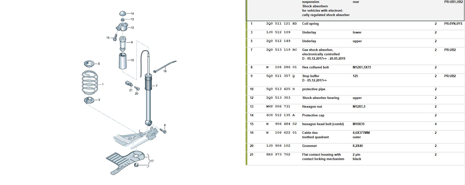

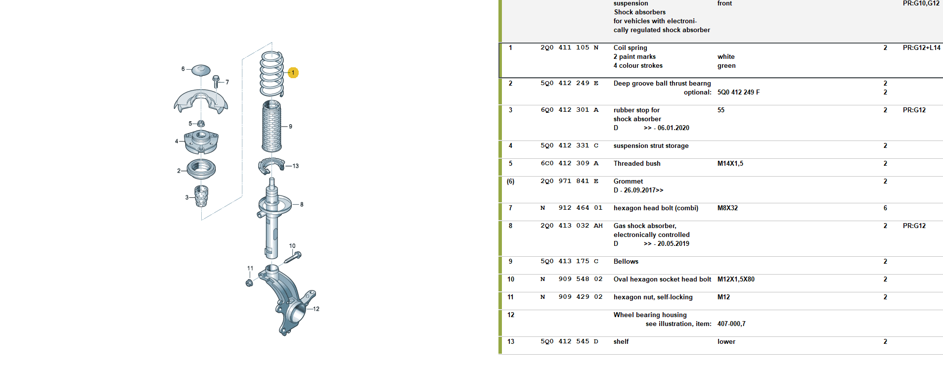

I´m looking for the part number of OEM Polo Gti spring. I live in Brazil and i want to buy it at Volkswagen.
But i need the prt number to find here.
Can someone help me ?
Dark_cze
Posts: 447
Drives: AW GTI with MT
Location: Czech republic
Re: part number spring polo Gti 2018
Post by Dark_cze »

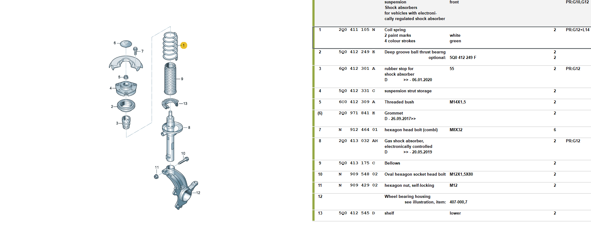

front
front

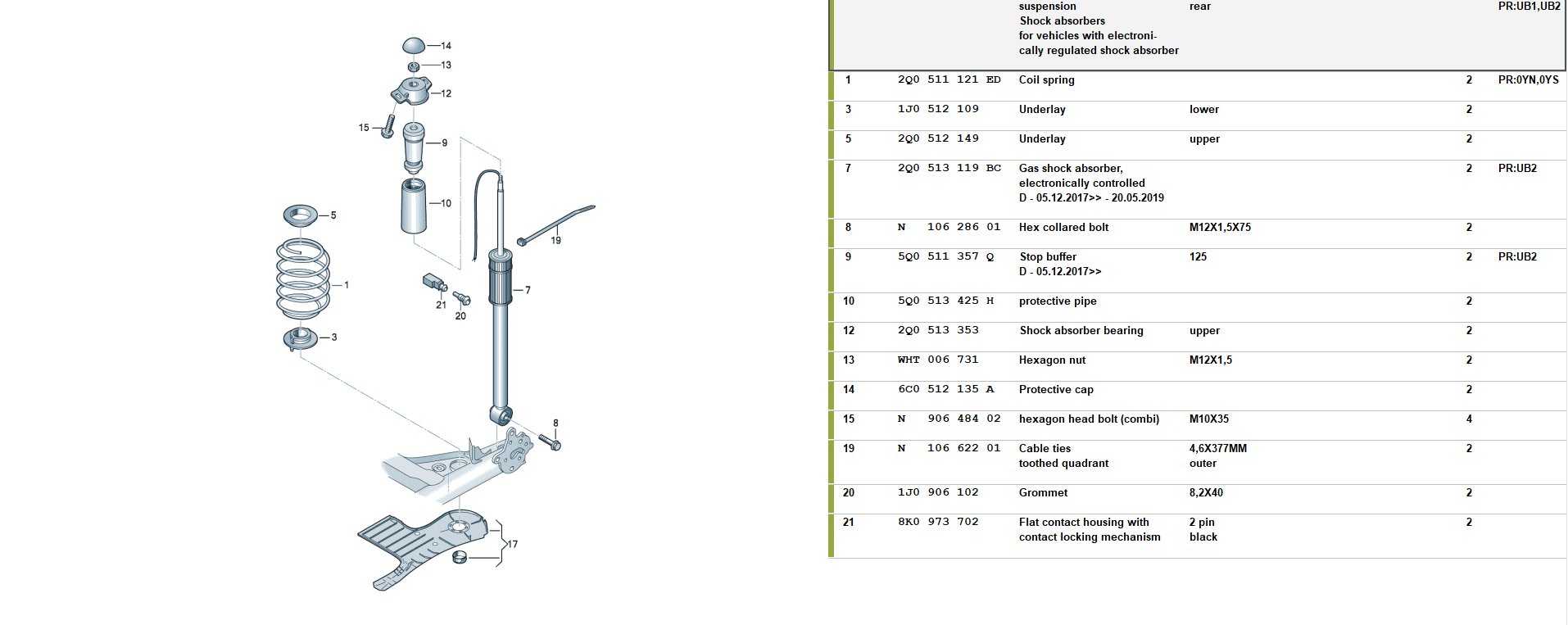

rear
rear
