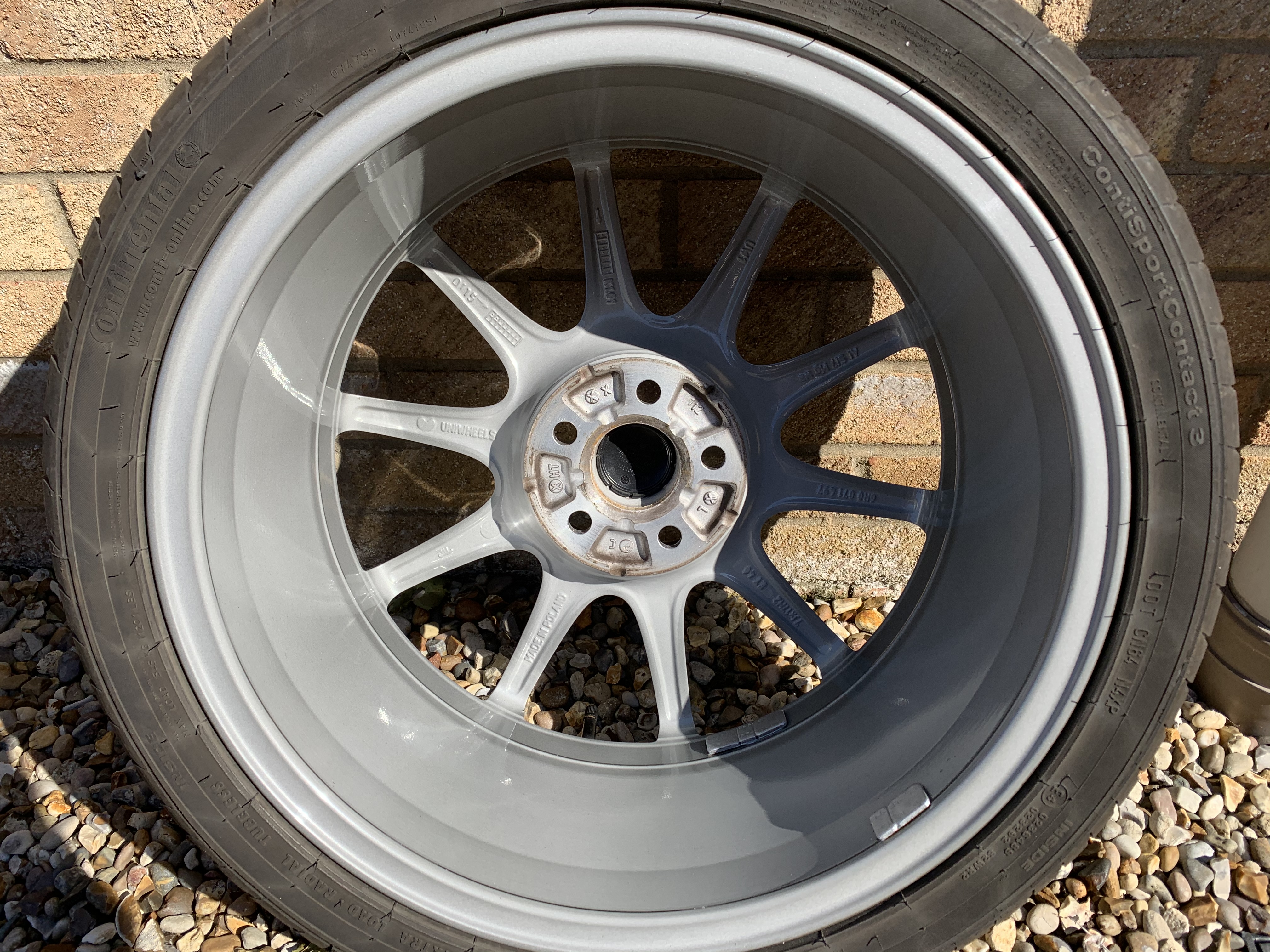

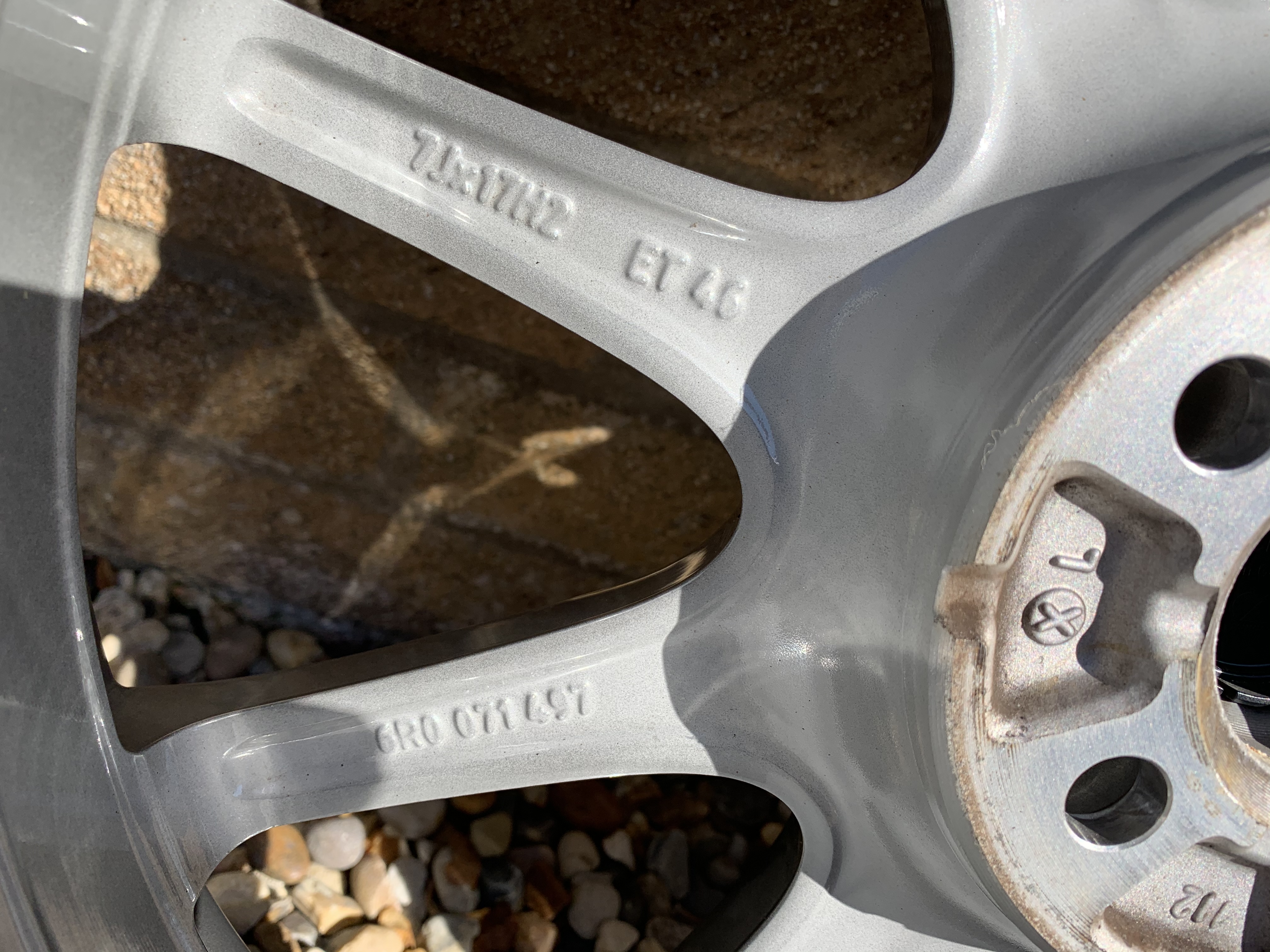

I doubt you’ll find a paint code on the reverse side of your wheel. The VW wheels I’ve just sold were available in three colours and when they are manufactured, the manufacturer would have needed to know which of the three colour options each wheel was going to be painted / powder coated in order to add the correct paint code for that colour at time of manufacture.
The details stamped into the reverse side of the spokes will include the following;
- part number (without paint code)
- wheel size (the width and diameter)
- offset
- certification mark (e.g. JWL, ABE, TUV or similar)
- manufacturers name
- possibly the VW emblem
Here’s a couple of pictures of the reverse side of one of the wheels I’ve just sold. You can see the part number (lower spoke in the first picture) but the additional three characters for the anthracite paint code (16Z) aren’t included. The colour of the reverse side of those wheels was much lighter (light grey) than the face of the wheels which was a mid anthracite grey colour.

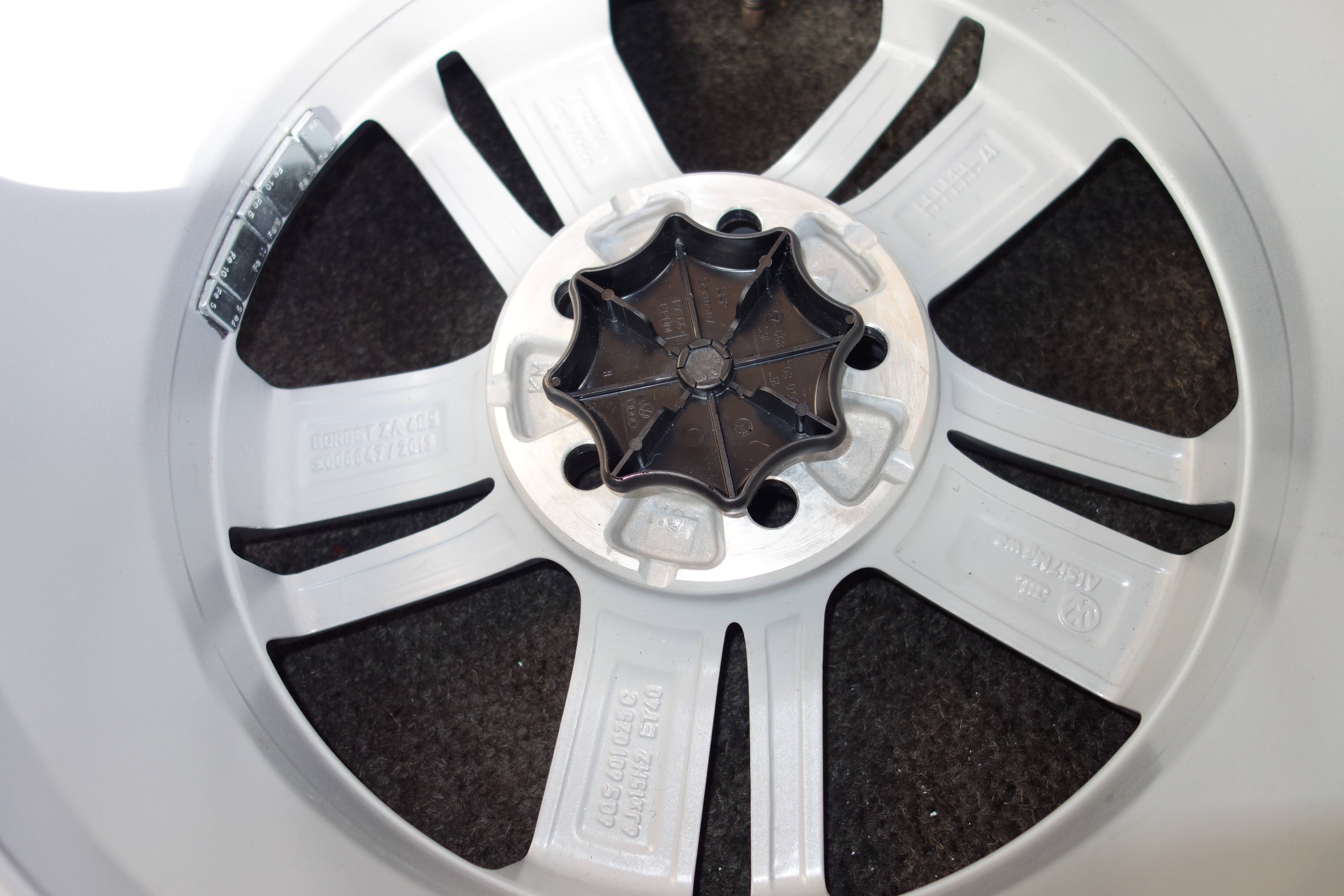

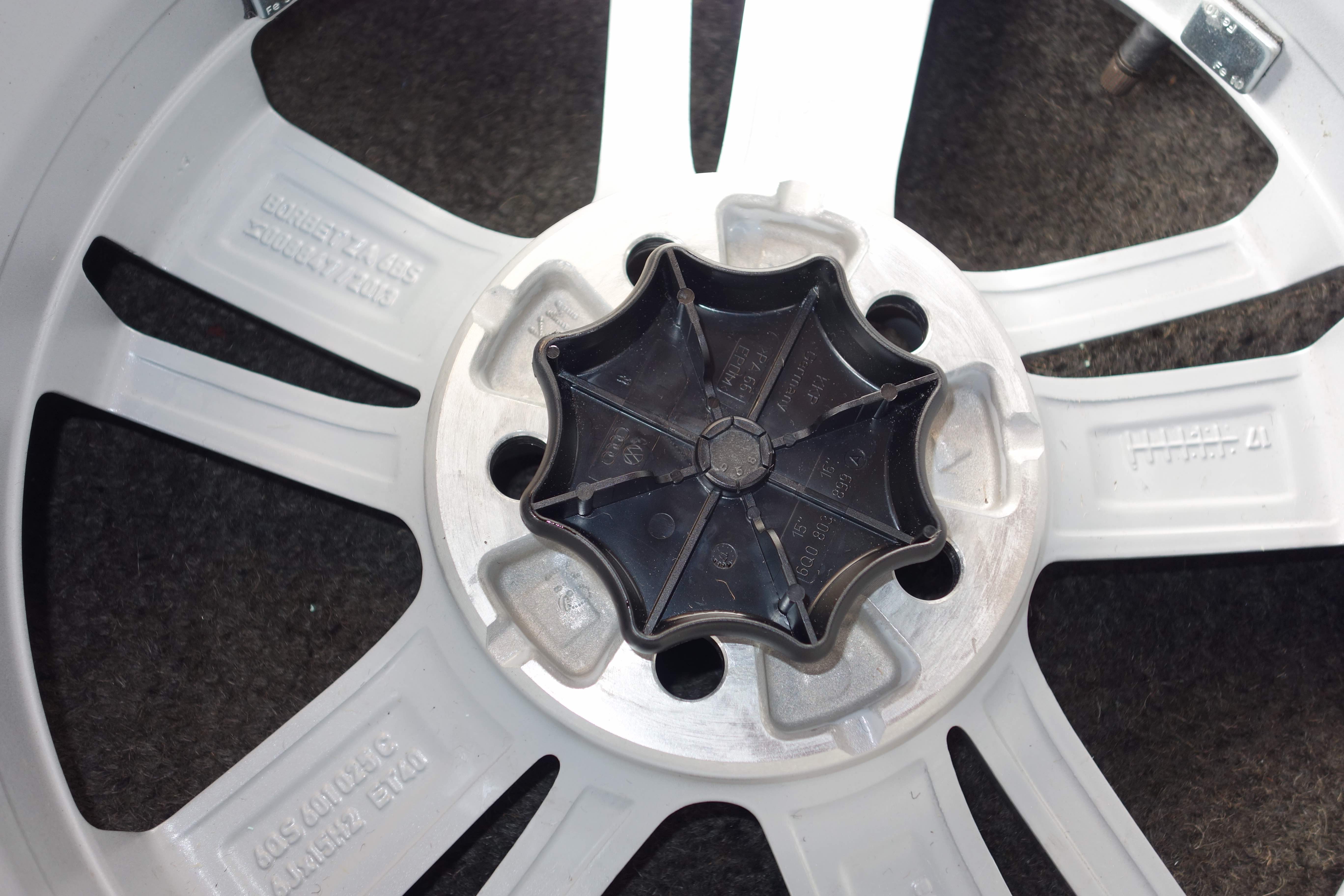

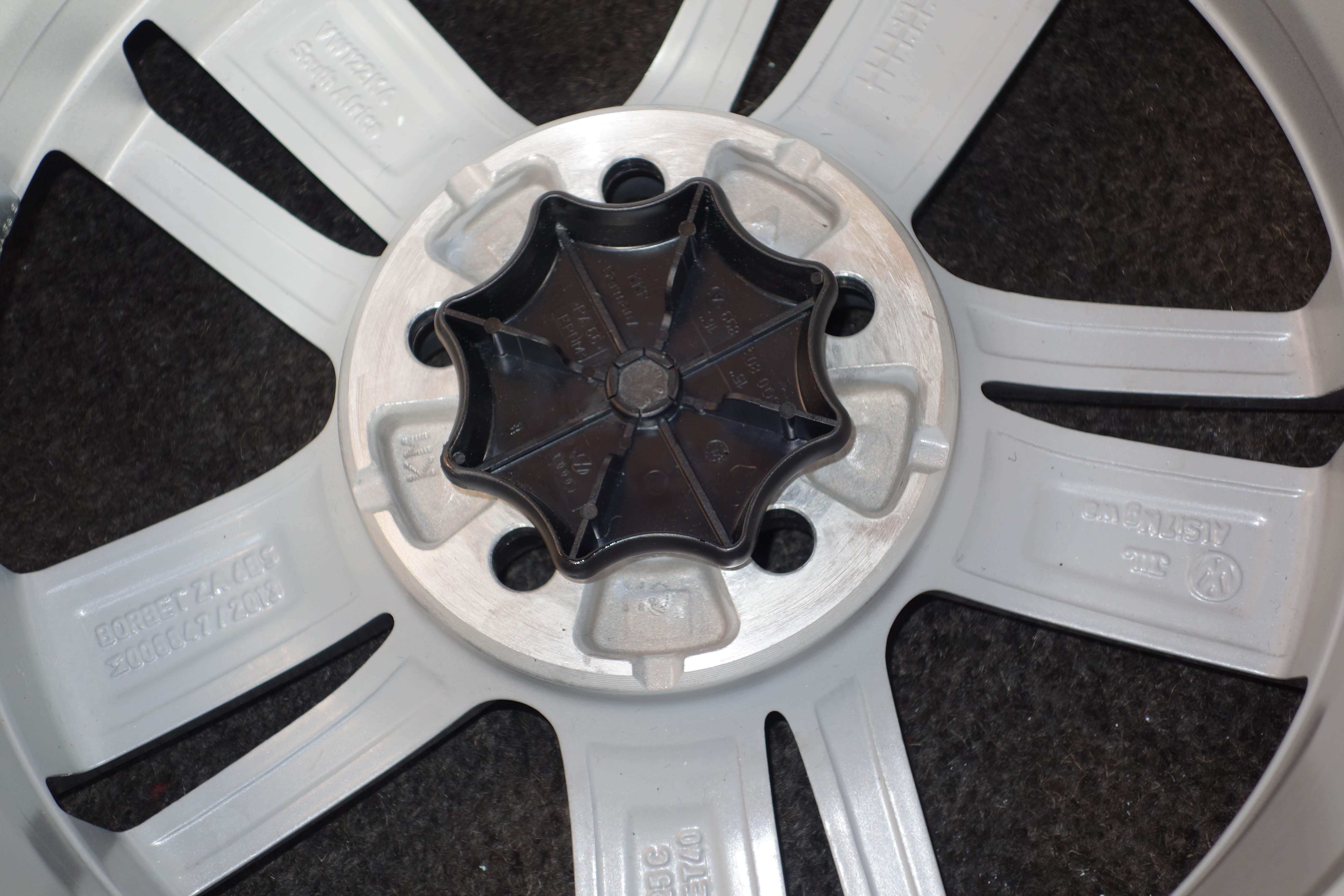

For what it's worth, here are some rather badly-taken pics of my full-size spare wheel in the boot.
Some of the embossments aren't very distinct in the first place, due to amount of paint over the tops of them. But these pics may confirm with you the kind of grey used on the back sides of my Polo's wheels. The camera being used unfortunately had auto-flash, and the flash quite often 'whites out' light colours in the subject.
The embossments appear to be:
VW 1221 K4?
South Africa
Borbet ZA 6BS
?008847/2013
6QS 601 025C
6J x 15H2 ET40
JIL
A1Si7Ngwa
Not sure whether this gets me any further, though. Probably not. Borbet are most likely the manufacturer, ZA obviously stands for South Africa, but maybe 6BS defines the entire wheel colour, ie. a particular grey, with spokes done in a certain silver colour?

- Posts: 3850
Re: touch-up paint for alloys?
@veteran;
- Barbet is the manufacturer. They also make good quality aftermarket wheels and OEM wheels for other car manufacturers.
- 6QS 601 025C is the part number for your wheels
- 6J x 15H2 ET40 is the size and offset for your wheel
- JIL; actually JWL, which is a safety certification mark
Sorry, don’t know what the other marks are.
As for the options to get a good colour match so you can repair the damage on the reverse of your wheels;
- if you have a larger Halfords or other automotive superstore near to you, you could always ask one of the store assistants to bring a selection of light grey paint touch up pens out to your car in the car park to compare them to your spare wheel so you get as close a colour match as possible. The touch up pen will either be clear plastic so you’ll be able to see the paint colour inside the pen or the packaging will show the paint colour.
- if you’re really worried about getting a perfect colour match (personally, I wouldn’t be, as it won’t be seen), you could try and see if there’s an automotive paint supplier near to you who might be able to mix the exact colour, once they’ve seen your spare wheel.
- contact Borbet, who might be able to provide you with the information to enable you to get some paint mixed to the exact colour.
