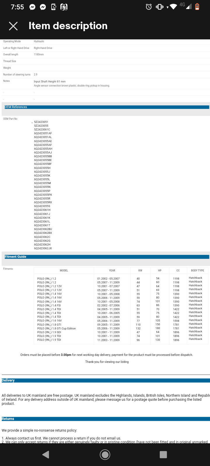

Rum4mo, can't seem to add a picture. I have a screenshot showing part numbers and the models they fit that would be good to add. Do you know how I can add it to the post?

This is the list I found
