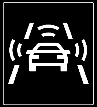

My 1yr old Polo had its 1st service a month ago. The garage assures me there were no software updates.
Since then, while driving on 3 occasions, the central display showing mileage, speed, outside temperature etc. has been momentarily replaced by what can be roughly described as a white thick-lined diamond geometric shape. I can't describe it better than that because the instinct is to brake, whereupon it disappears. It is accompanied by a beep. No other warning symbol appears. I can't find anything like it online. My garage don't know.
Any suggestions gratefully received

Are you describing a shape briefly appearing in the main display where speed / time / distance is given? This might be the forward collision warning system flashing up it gives a sharp single tone beep noise and a symbol if the front radar suspects a collision is imminent (situated behind the VW badge on the grille).

@pgwill; is the symbol you’ve described in the owners manual?
My initial thought was the same as @Simonz and the symbol might be associated with the front assist systems. When the symbol was displayed, did the conditions exist whereby the car would have applied the brakes if you’d not intervened and braked first?

Definitely sounds like the front assist/collision warning symbol and beep . . . . .
front assist warning symbol.png (16.22 KiB) Viewed 6671 times

Oh god, that bloody nightmare of a system - the described shape didn't make me think of that.
I've yet to have that pop up on the Gti, it used to get triggered quite easy in the beats.
Both were/are set to medium.
It's either less pernickity in the Gti, or I've learned how to drive to avoid it triggering.
Weird that the OP has had the car a year and it's only triggered recently though - is the VW badge at the front dirty (the radar is behind that) :?:

That is exactly what you are getting, has happened to me twice first time when the person in front of me doing 70 suddenly and with no warning turned left into side road at speed and radar on front of my car picked it up instantly and applied brakes milli- second before me. Gave me a real fright 1st time it happened but now I am aware of it I'm prepared for it. Also just for information had a loan Ibiza about two to three years ago and the radar sensor in the lower bumper got covered in snow and I got an orange warning on dash, so as we are coming into winter may be something to look out for on the Polo!!

Thanks to all who have replied to my question. The symbol posted by POLO Clive is indeed the one in question. As I said, I had been unable to find it online, and it is not in the handbook. I've just looked again, now that I know its purpose, and still can't find it.
It has only been triggered (with no other cars anywhere near) since the car was serviced, so I will go back to the garage and get them to look at it. At least I can tell them what the symbol is, which they didn't appear to know

I’ve just found the symbol in the owner’s manual - it’s not that obvious, so I’m not surprised you didn’t find it. In my version of the manual (edition 11.2019) it’s at the bottom of page 14 and in red (Driver information - symbols in the instrument cluster) and again on page 135, in red (Front Assist - advance warning).

There's honestly umpteen things will set it off.
On my old route to work, it consistently thought I was going to drive into a wall one one corner.
On my new journey home, it thinks I'm not going to brake down a slip road.
I either switch it off and suffer the orange warning light, or just lightly press the brake pedal to show it I am awake, I can see, I'm not attempting suicide and I'm not stupid..... :roll:
