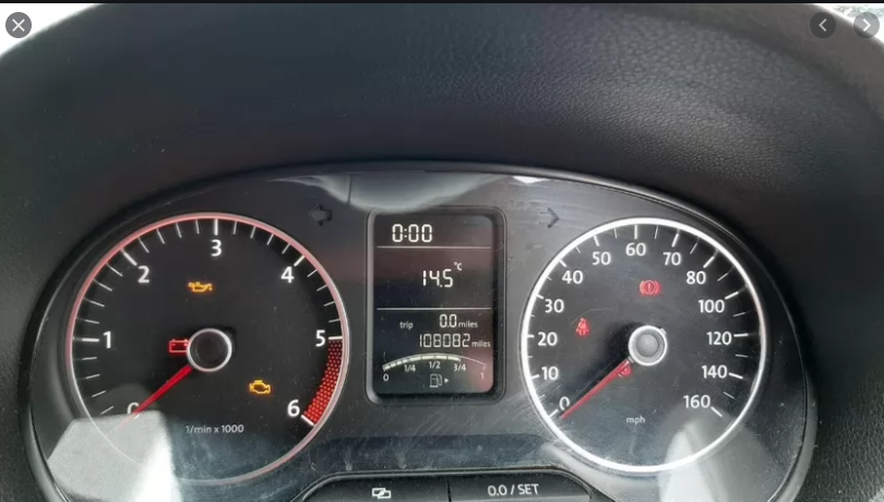

Currently I have the basic instrument cluster and no trip or OK/RESET button on my stalks. My instrument cluster only shows the outside temperature, the time, trip and mileage/speed in mph like in the photo bellow.
I am not sure about my IC's part number. If it's necessary I will go and check. I know it's last letter is F because I can't enable needle sweep on it.
My question is if I upgrade the stalks will I be able to switch between the screen modes in my instrument cluster? For example have the fuel consumption in real time or the speed or anything else? I was thinking of upgrading to a MFSW, but the stalks are cheaper.
