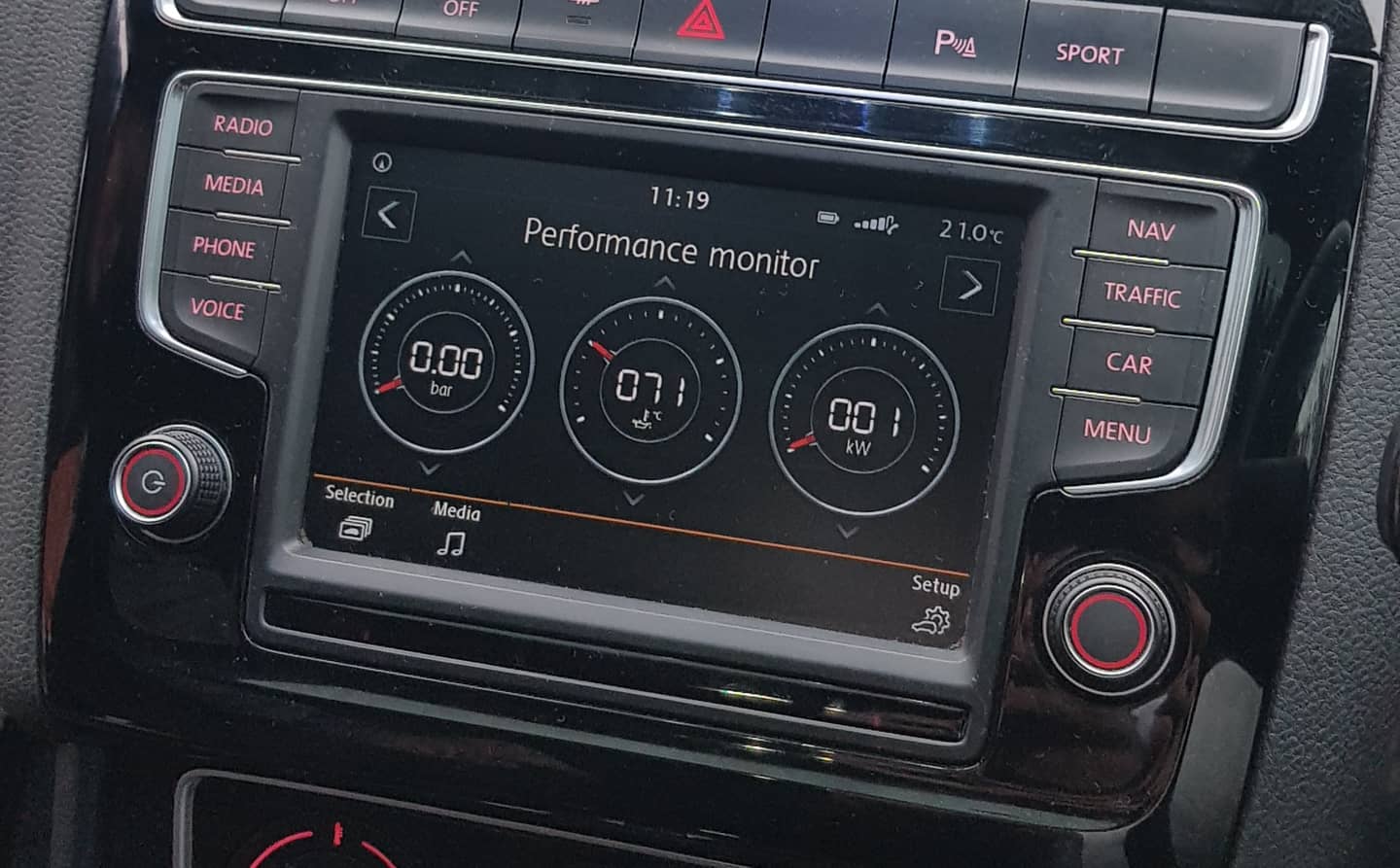

Does anyone with a Polo has the Performance Monitor menu? If yes can I kindly ask if the boost gauge is working ok and if he has a Horsepower gauge?
Recently I have installed in my car (Polo 1.4 tdi 2016) and it is working perfectly, except that it has not the horsepower guage and the boost gauge is always zero.

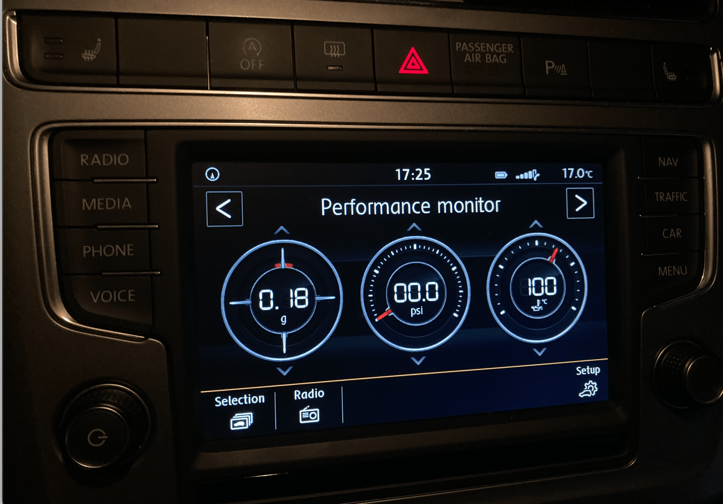

I searched very hard to find information but the only I thing I found was an image of a polo which shows the boost guage is zero (it seems it is not working like mine) and it has a Horsepower gauge.
In all other models, like golf, tiguan the guauges are working ok.
PS : The sport.png is from my car, gauge.jpg is the Internet

- Image from Internet
- gauge.jpg (113.82 KiB) Viewed 1478 times
- Mine Car
- sport.png (1.85 MiB) Viewed 1478 times
