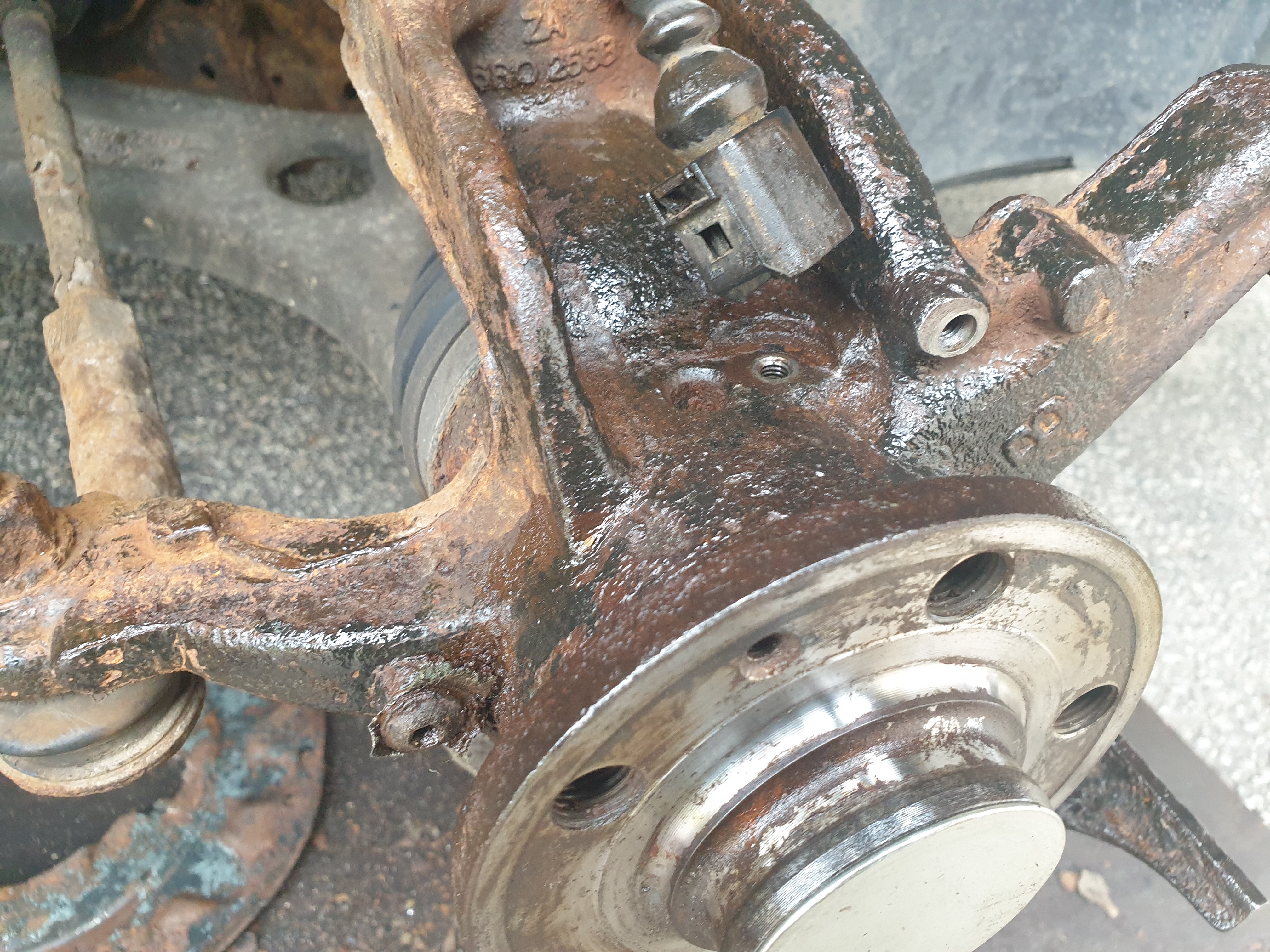

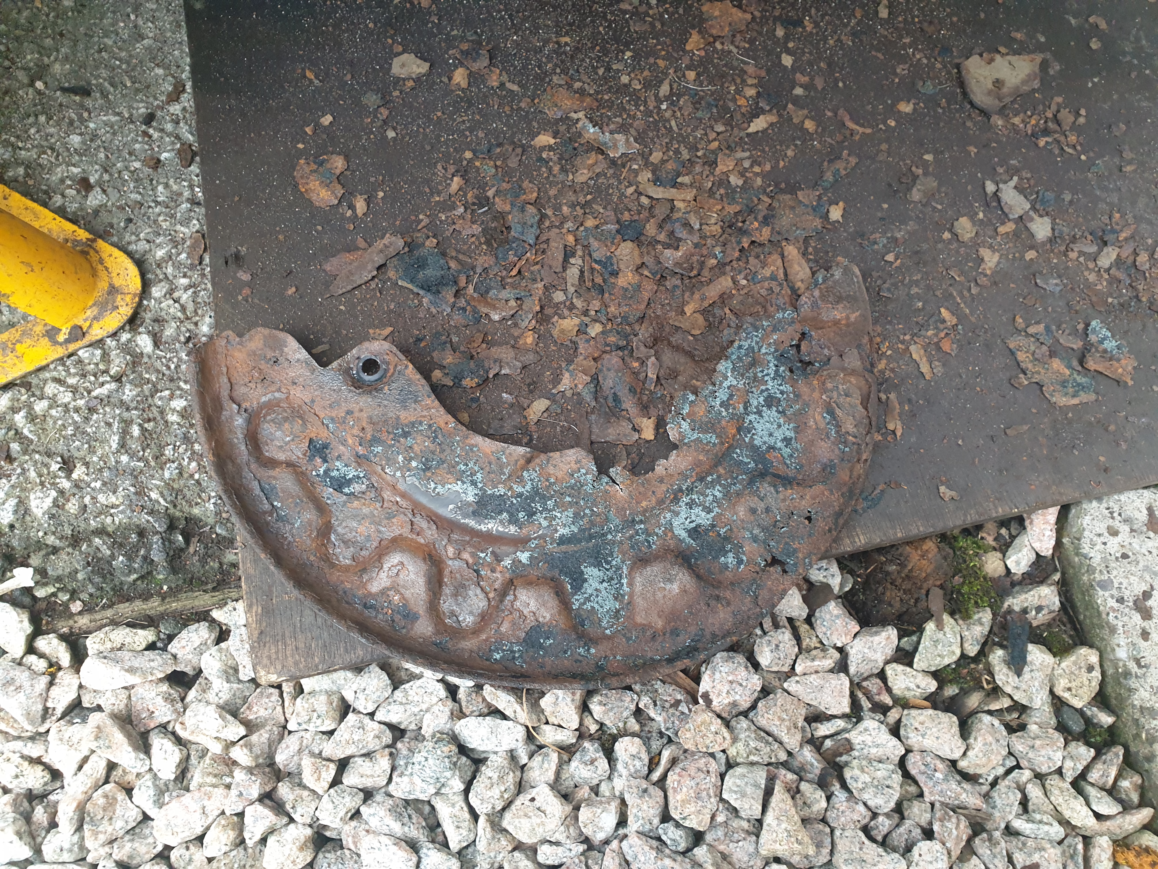

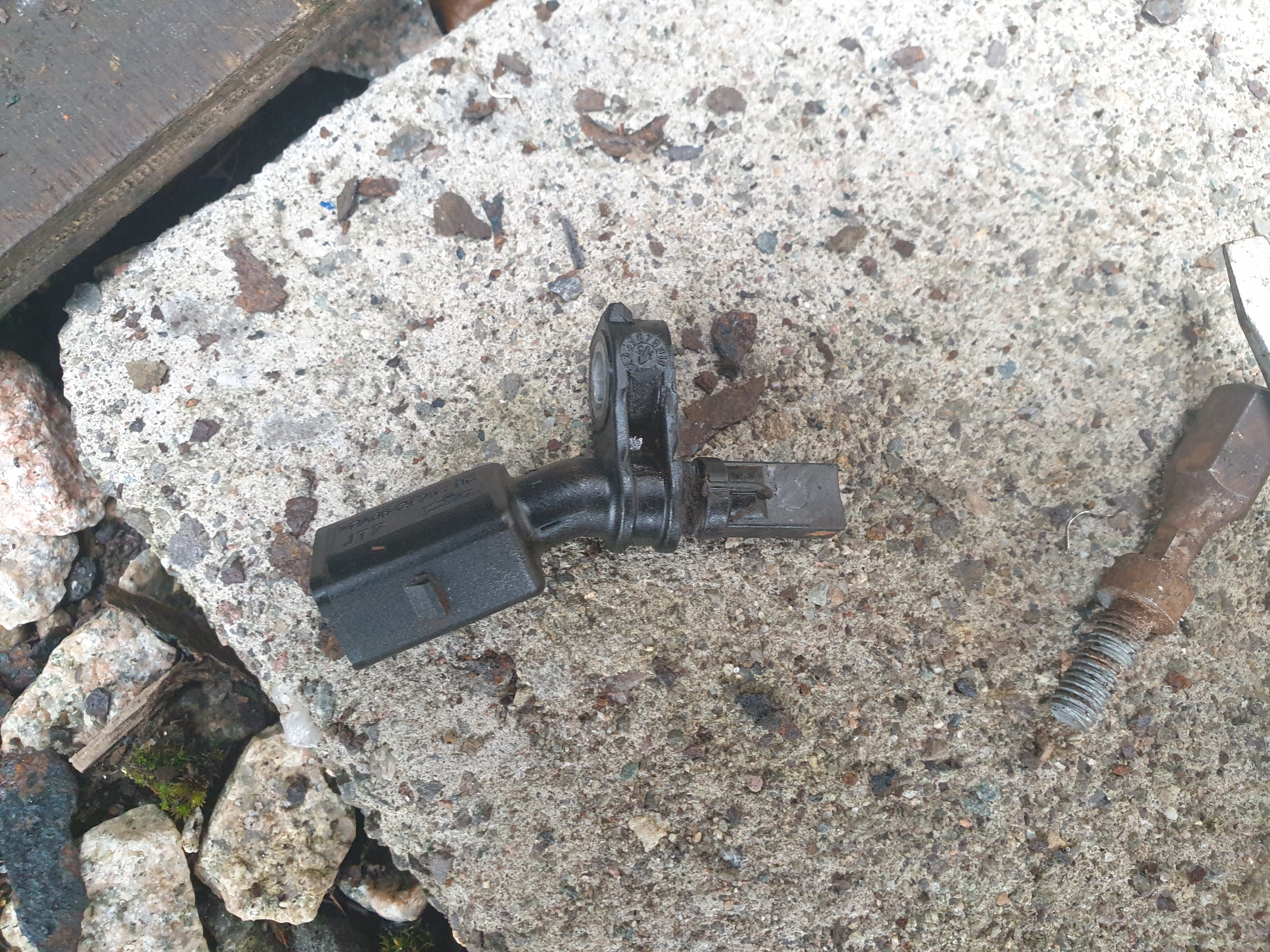

So dived in today waiting for the part to arrive. Just as well as the brake dust shield has rusted through and the ABS sensor is a pain to remove. Incidentally that link for removing the sensor will be difficult on Mk5 Polo as the sensor is recessed into the hub, so no chance of getting a spanner on it.
Always hammer torx or Allen key bits in, especially with corrosion on dust shield or ABS sensor bolt. One of the screws you can't access on the dust shield due to the bearing hub assembly. With the Allen key bolt out of ABS sensor, spray with PlusGas around the edge and clean with screwdriver to remove rust and corrosion. Slow and steady, levering sensor using large flathead screwdriver using wheel hub for leverage.

That might work easily/quickly with that style of ABS sensor in an alloy housing, but these Polo ones are in steel housings and have a "relief" in the plastic moulding near the top of the ABS sensor, and that gets filled up with nasties and the rusting hub carrier housing expands in to close up that "spare" void.
The one that broke on my offside carrier housing got caught due to the excess rusting that broke away when the removal disc, that I had already opened up wider and deeper, still managed to break off a chunk of rust and it caught the ABS sensor and snapped it - or at least tilted it while its top end was still fixed solid with rust.

@spartacus68, yes, the partially obscured Torx headed screw that secures the stone shield - I ended up forcing a Torx bit into the head of that one and then used an adjustable spanner on the bit as there was not enough space, with the bigger brakes, to get anything else onto the Torx bit - but at least once every one of them did "crack" they unscrewed easily as the threads were spotless, only the rusting on the heads fixing/locking them to the stone shields. I went to Skoda for new Torx screws, as they are easiest to get to, they had none but Audi 200 meters away had about 100 in stock! Its good when parts people think out of the/their box!
From memory, VW workshop manual recommends that you coat these ABS sensors with a suitable grease before re-fitting them, but in main dealer workshops, it sounds a lot like you don't waste time and just prepare to have to fit a new ABS sensor which is "only" just under £100! In my case I needed/wanted a new sensor quickly so I bought a new Bosch sensor from ECP assuming that as the ABS controller is Bosch then so would be the factory fitted sensor, then discovered that the branding on the factory fitted one was TRW, same as the brakes etc on the front, that makes sense - and AutoDoc sell them for not much money if you can wait about 10 days. As always expecting the worse case situation, I had spotted NOS TRW genuine VW part for near side on ebay for not much money so grabbed it just in case the near side sensor had been damaged with out me noticing it, in the event it was and still is working fine, but I'm prepared!
