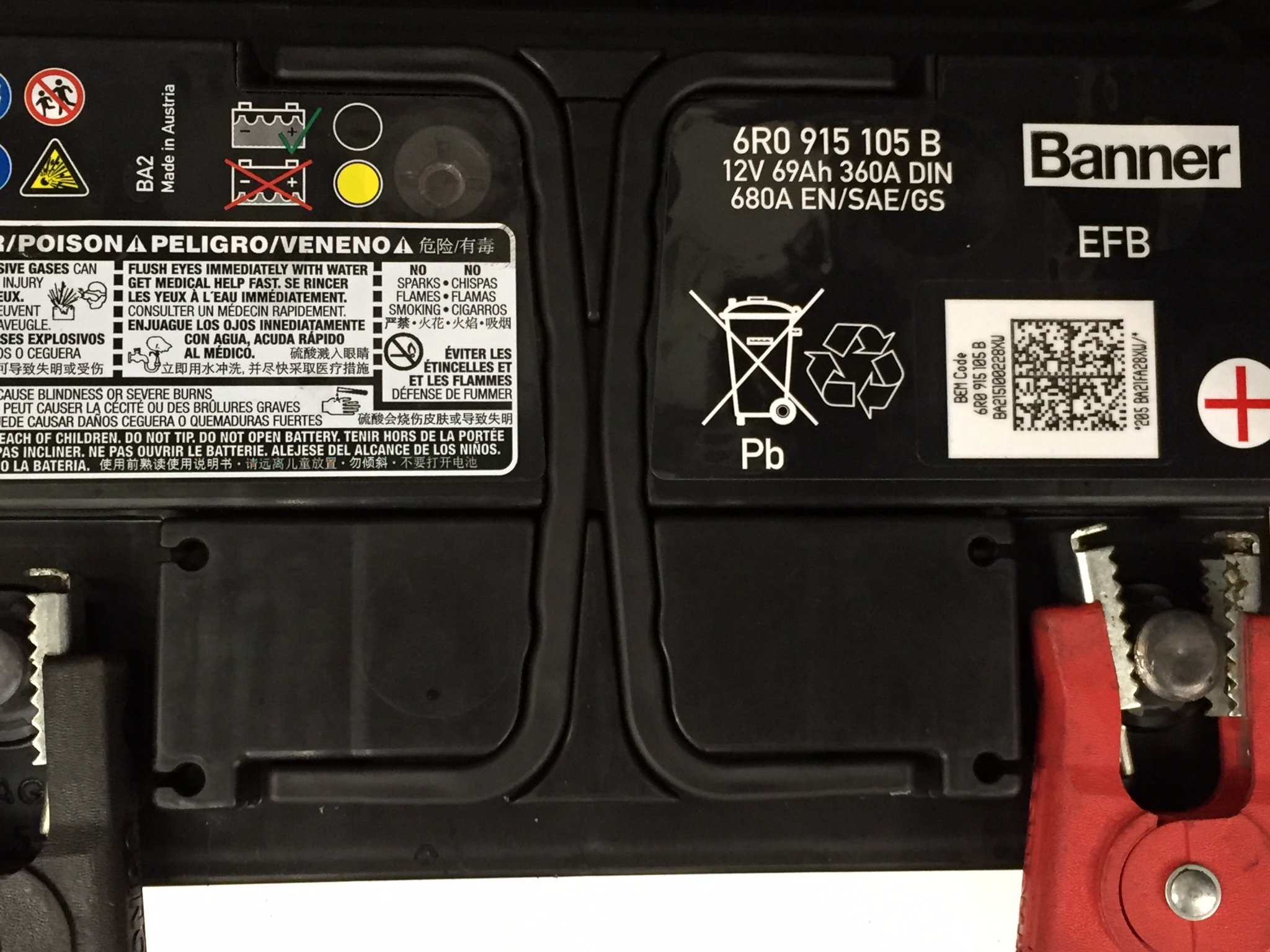

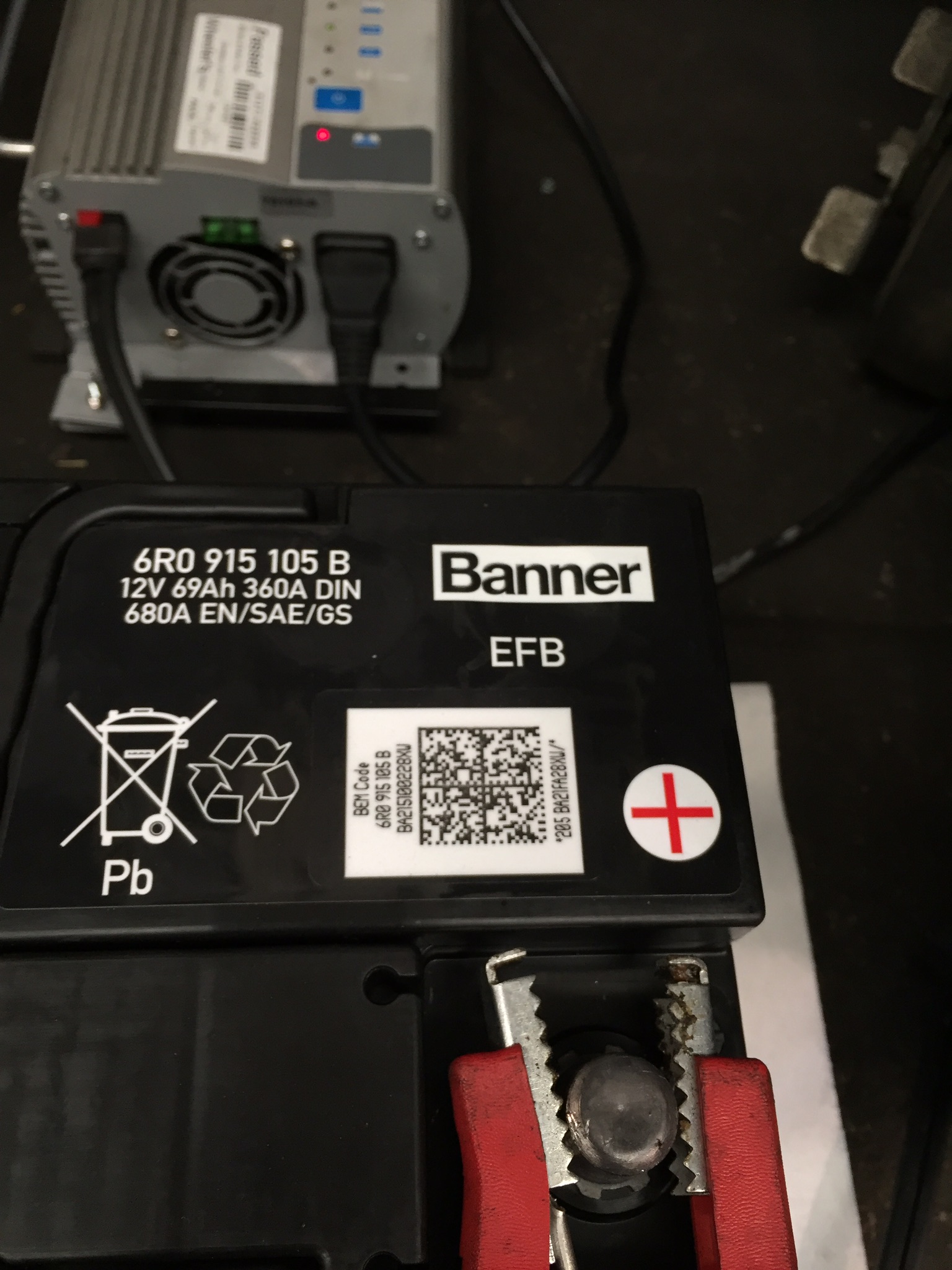

There was a dodgy batch of Moll batteries that went into the 6c at some point. My oem battery was a banner that i replaced with a bosch S5A08. You just need to code to say it's a AGM rather than EFB and the extra capacity.

I had a picture from my MY2016 gti it maybe the same battery I expect
You can change/code this with OBVDeleven I have done this also as dink says
