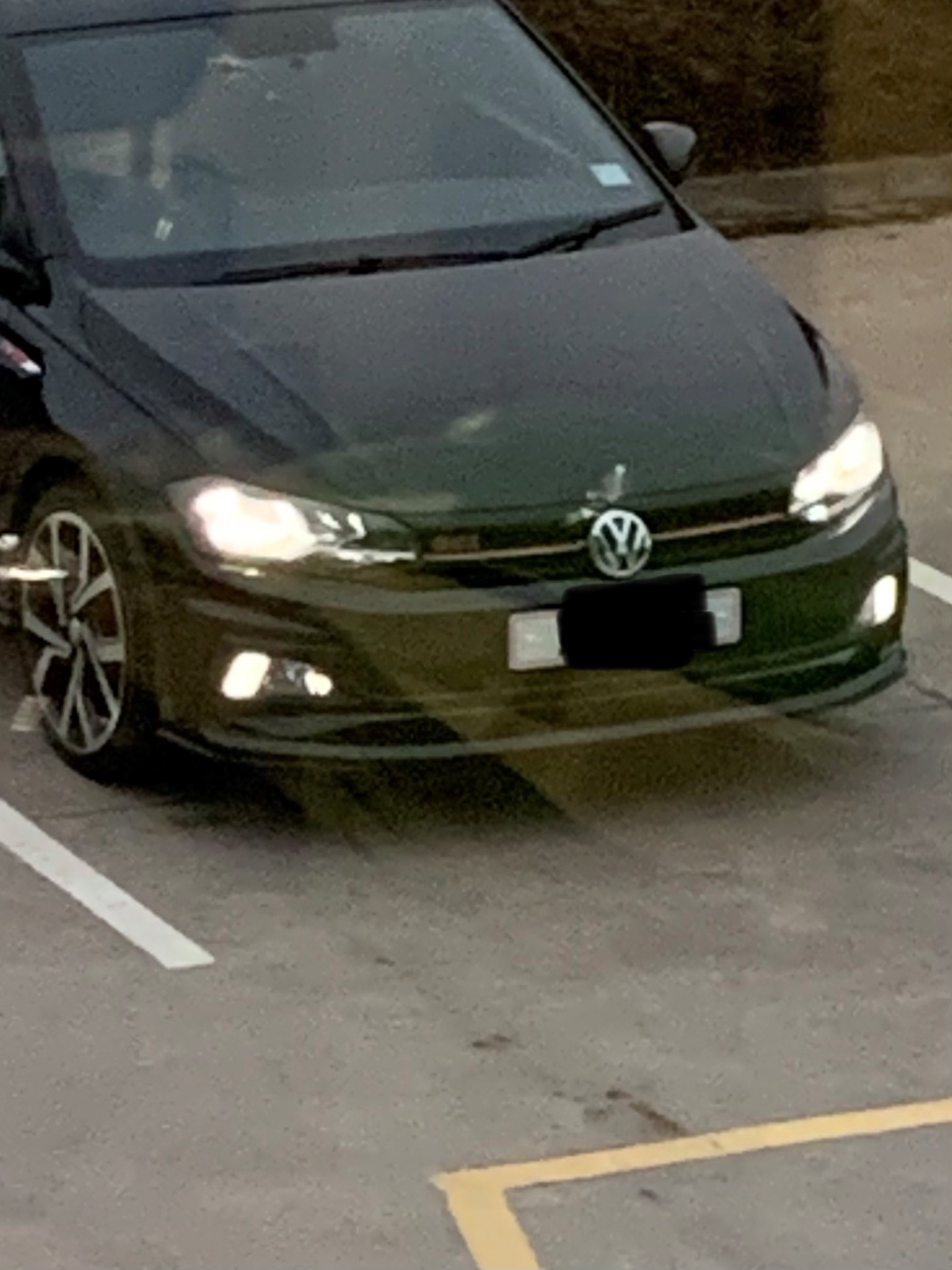

by Andy Beats
Taken from office window so the quality is crap, but you can hopefully see the match is great.
You'd be forgiven for thinking my headlights are LED as well now.

Andy Beats wrote: Tue Mar 02, 2021 5:59 pm Taken from office window so the quality is crap, but you can hopefully see the match is great.
Mate that's perfect thanks so much, were they difficult to install?
also fair play for unlocking your car out the window for a photo lol

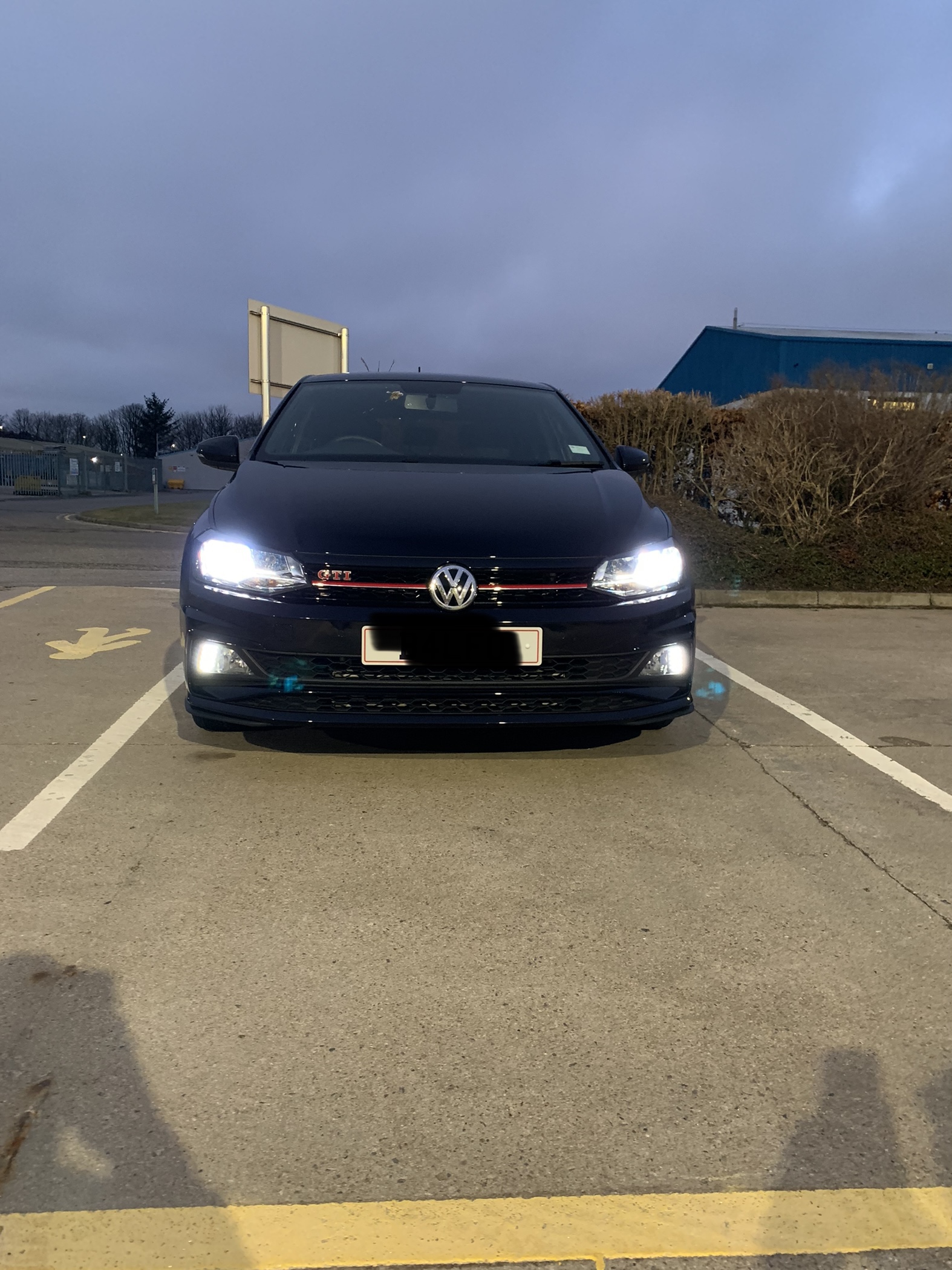

Actually took longer to type this than it does to do it.620AFCC4-0D27-4253-BD58-0A68F8CEDA60.jpeg
That makes a world of difference doesn't it, how do you find the light difference on the road, are they as big a difference on the road as they are in looks?
Also just wondering, are these 5000k legal, I haven't changed bulbs in a car for a few years and I recall legality of some bulbs being an issue back then.
Edit : Quick Google says not legal but the WhiteVision bulbs are, wonder how much of a difference in brightness there is?
