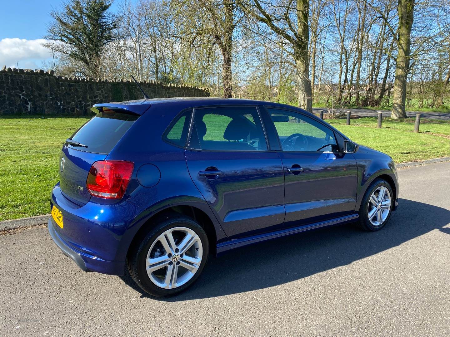

Well after a short search we found a 2014 1.2 Tsi R Line.
Deal done!

Good colour, enjoy!
Posts: 6694
Re: Best engine?
Looks good. Did you go for a pre-facelift on purpose? It looks like this is one of the very last 6R's before the facelifted 6C came.
Great colour, enjoy it!

Re: Best engine?
Post by Bobupndown »
No not on purpose, it would have been ideal if it was a face-lift model but couldn't fault it, really tidy car. Will probably update the stereo in due course but other than that it seems to tick all the boxes. He'll collect it on Tuesday.
